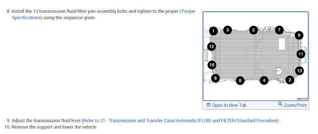

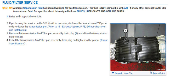

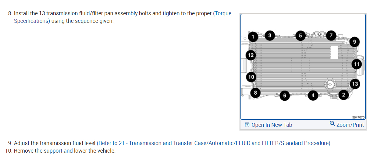

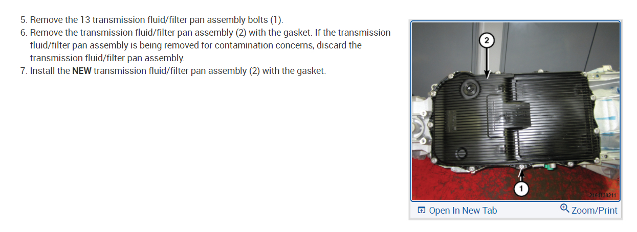

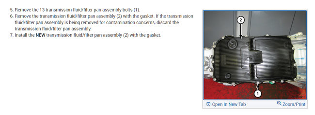

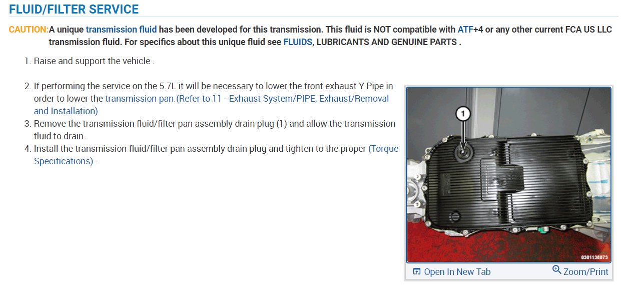

I would definitely do the transmission filter. also you can have a helper look under the truck when you put the truck ingear (drive) and then reverse (foot on the brakes) to see how much movement is in the drive line. Can you please shoot a quick video with your phone so we can hear the noise? that would be great. You can upload it here with your response. Here is how to service the transmission. Here is a guide to help you step by step with instructions in the diagrams below to show you how on your truck:
Check out the diagrams (below). Please let us know what you find.
