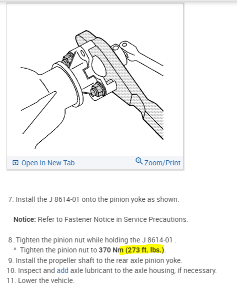

I replaced the driveshaft yoke on the axel. But I didn’t count how many turns or mark it before I took it off. Now I noticed a vibration when I take my foot off the gas. How do I find the torque the nut needs?
