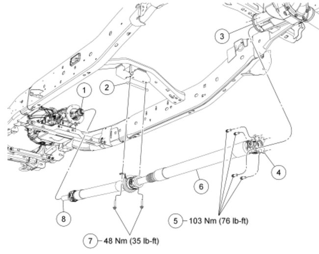

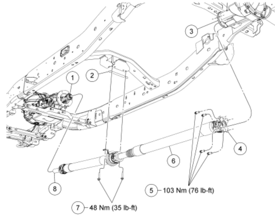

My carrier bearing has simply worn out on my truck. Due to it being non serviceable I had to buy a whole brand new shaft. Is there anything special I need to do with the new one before I put it in? I understand the old one needs to be marked if it's being reinstalled. Is that the case with the new one?
