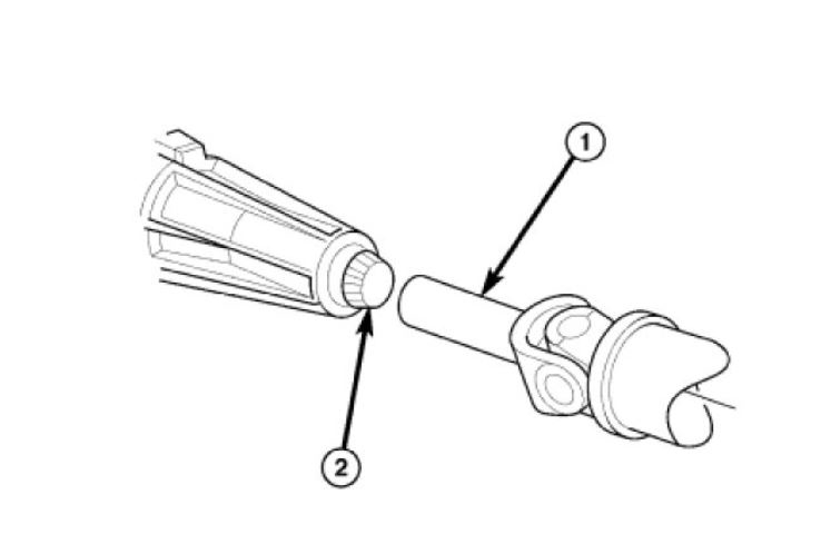

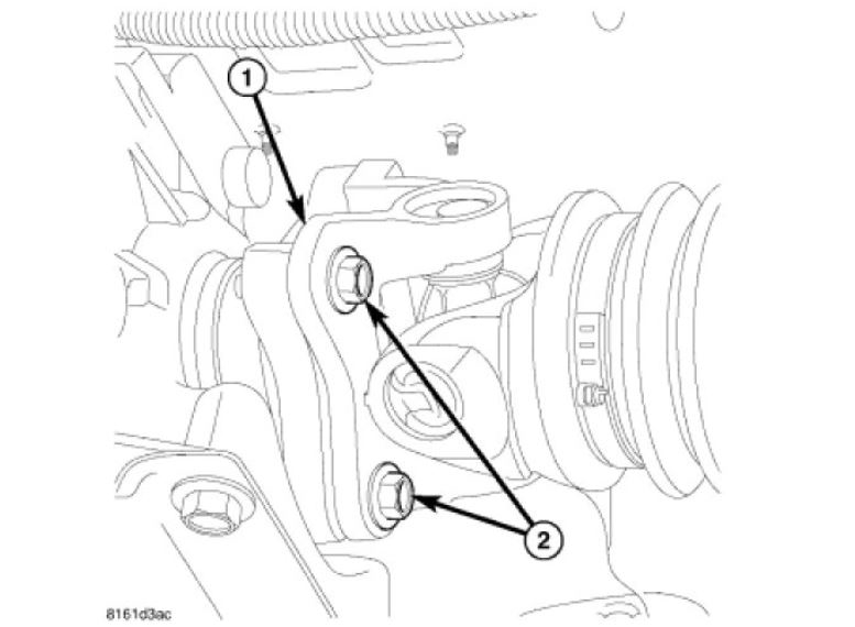

The rear driveshaft is a plug and play. There is no special installation procedure.
You just install the slip yoke into the back of the transfer case and attach to the rear differential.
