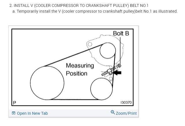

where is the other drive belt located?
Oct 22, 2021 at 5:14 PM

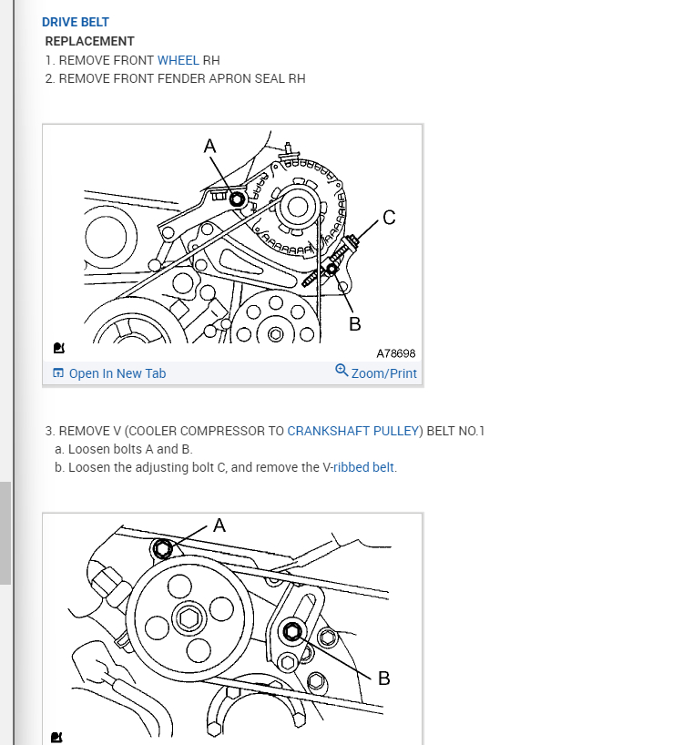

Just to jump in, here is a guide that will help with determining if the belt needs to be replaced:
https://www.2carpros.com/articles/how-a-serpentine-belt-works
Plus, here is a video that shows how to check the belt as well:
https://youtu.be/ef3N25wI8uE

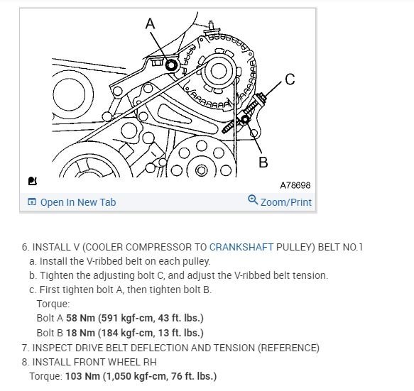

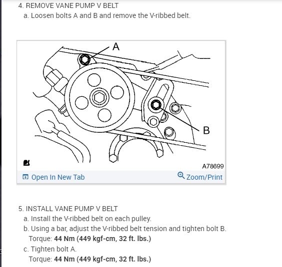

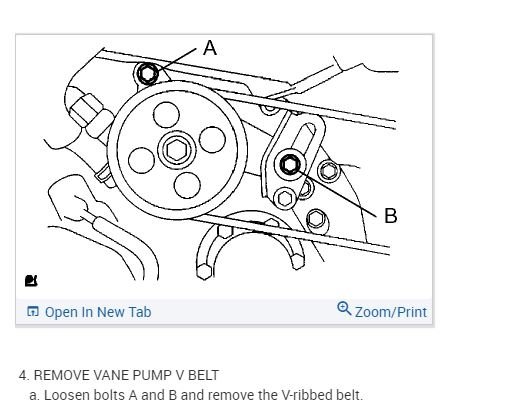

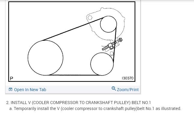

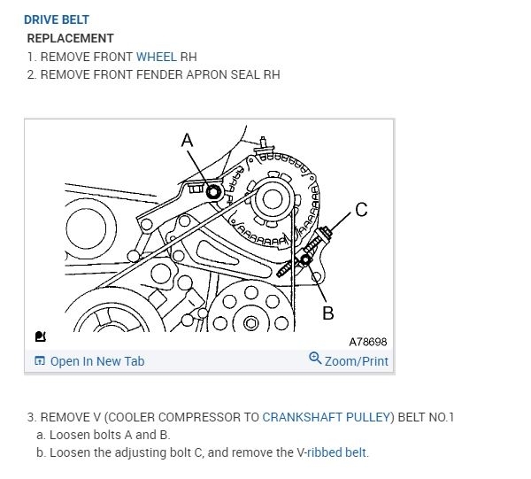

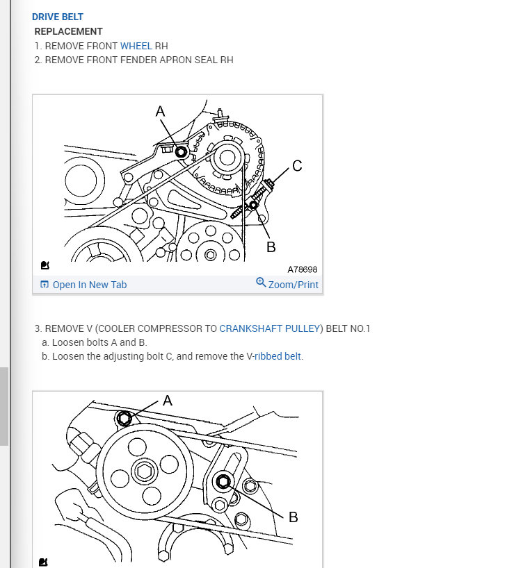

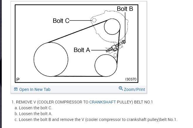

Lastly you have a drive belt on the alternator and A/C compressor. Then I show you have a second belt for the power steering.
Take a look below for this info that shows how to remove each belt. There is an adjuster on the alternator and a second on next to the power steering pump.
Please let us know what other questions you have. Thanks

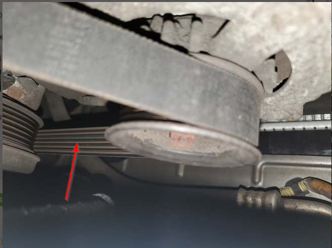

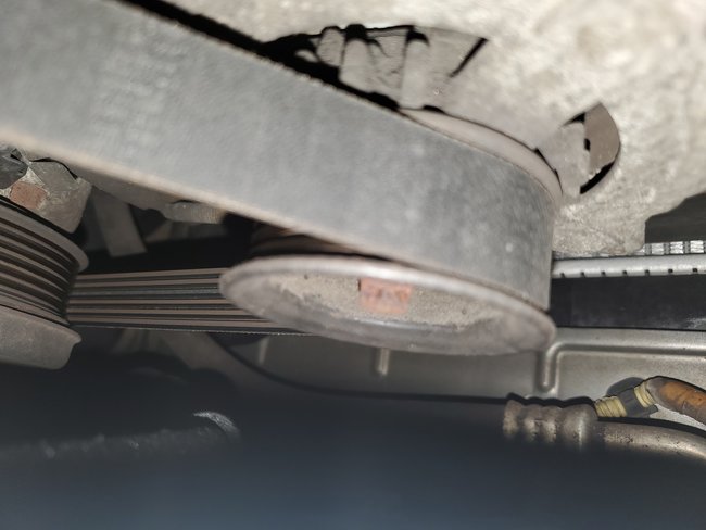

Here's a picture of the drive(serpentine) belt.
Oct 25, 2021 at 10:25 AM

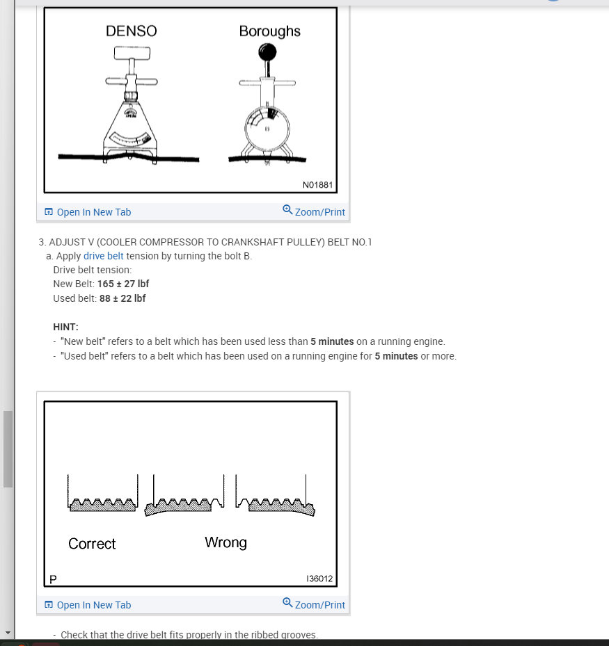

That does not look terrible, but you need to inspect the ribbed side for any cracking or splitting.
Take a look at the picture below. The best way to find out is to remove the belt and then bend it to see if the grooved side of the belt is split.

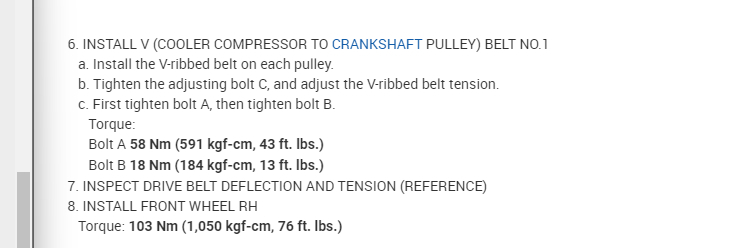

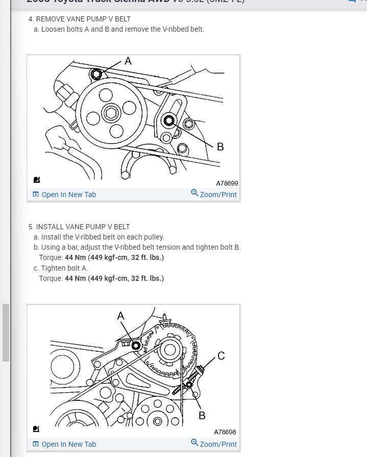

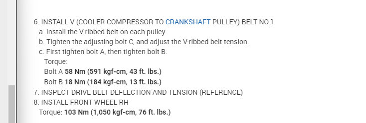

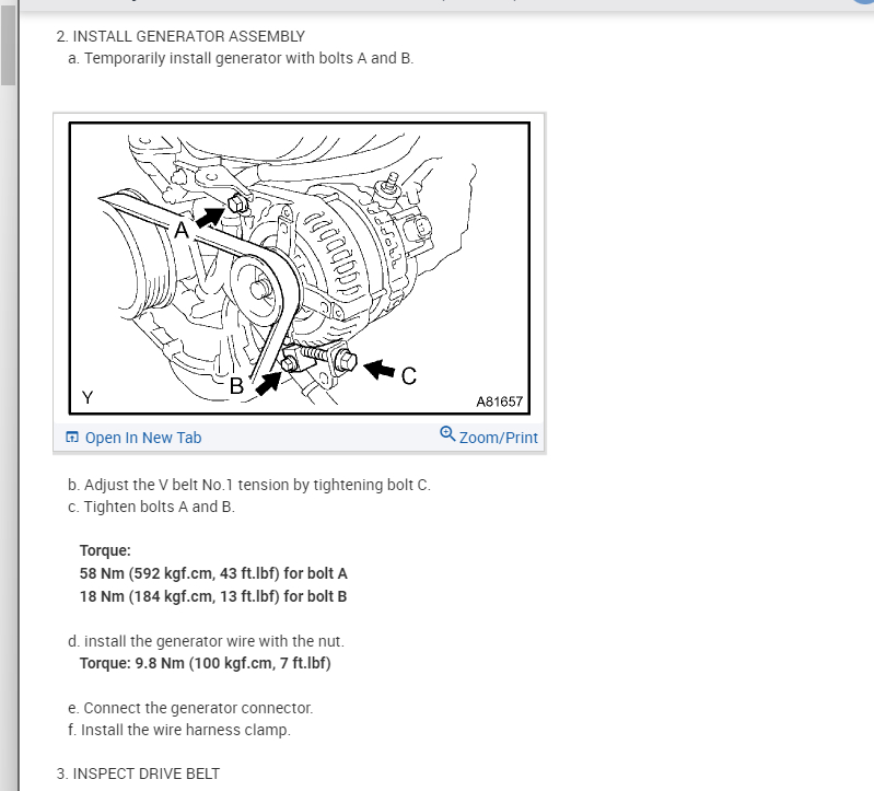

Now, if I decide to replace the belt, what are the torque wrench settings for the 3 bolts.
Oct 25, 2021 at 5:59 PM
In my original response, the diagrams have the torque specs for the bolts. It was 32 pounds.

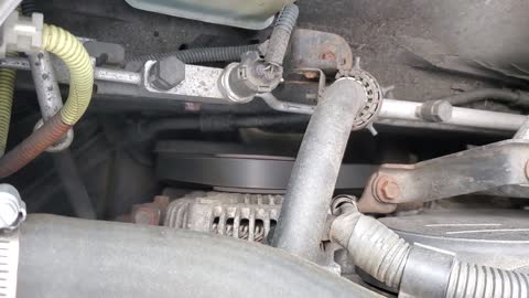

In the above video I sent, is the drive (serpentine) belt next to the alternator?
Nov 5, 2021 at 7:30 PM
IMAGING
  • 151 POSTS

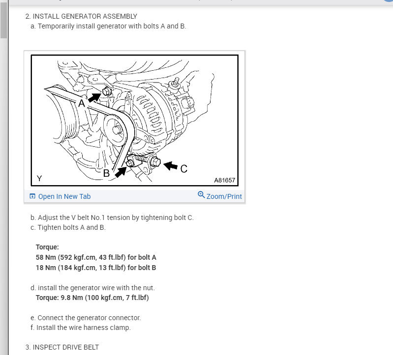

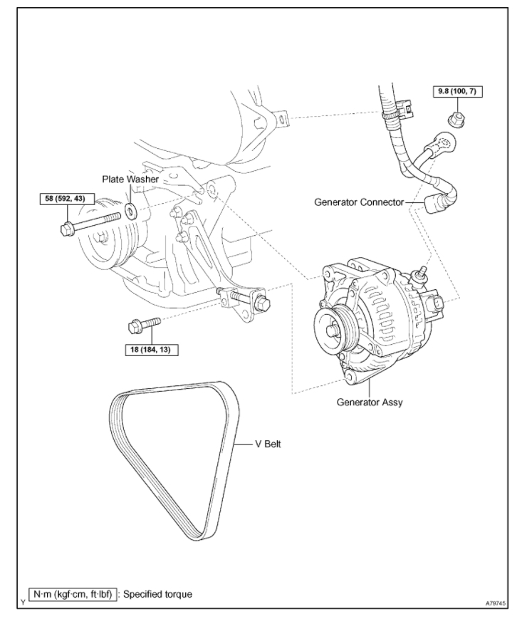

All 3 bolts are 32 lbs.?
Nov 5, 2021 at 7:42 PM

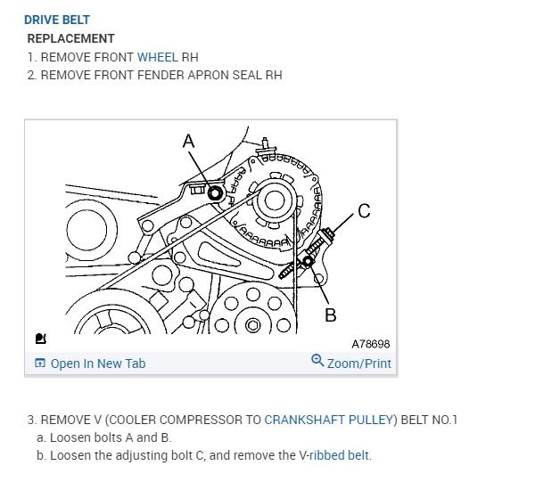

Yes. This belt is the drive belt. Take a look at the info below. However, which three bolts are you referring too?
I attached the alternator view and torque specs below so let me know if you are talking about different bolts then shown. Thanks
