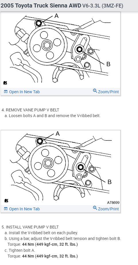

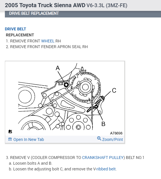

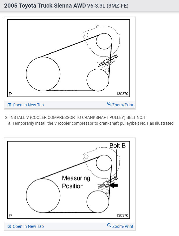

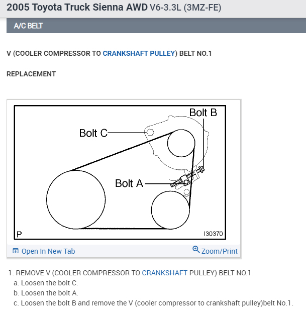

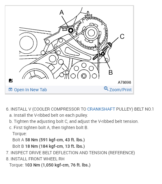

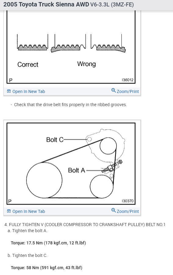

I have attached the replacement procedures for both belts as well as all the torque specifications below.

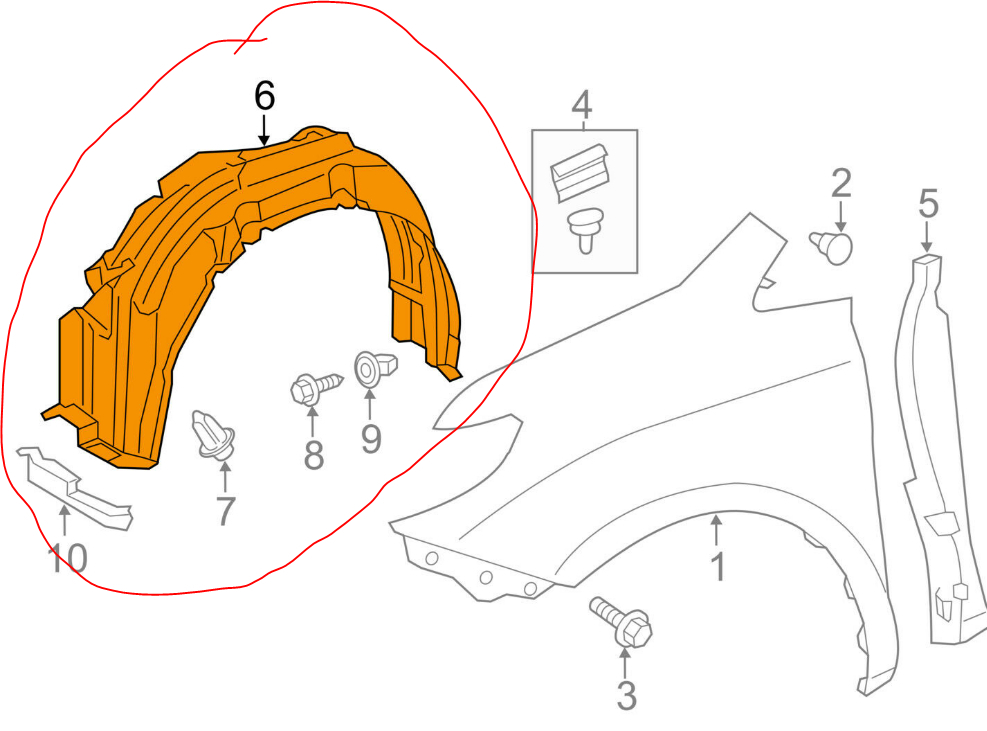

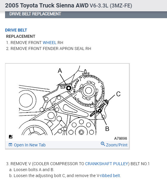

in the pic below, under replacement, what is #1 and #2?
Nov 8, 2021 at 8:53 PM
SQM
  • 6,383 POSTS
Number 1 talks about removing the passenger side wheel (you will have to jack up the vehicle and secure it with jack stand).

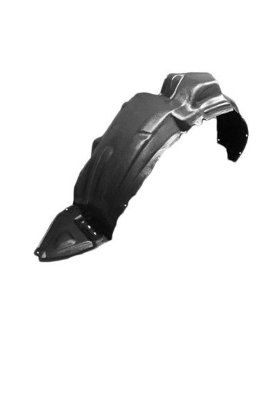

Number 2 is for removing the inner fender liner inside the wheel well (see picture below).
