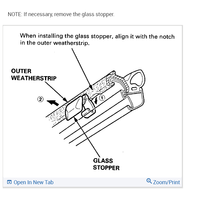

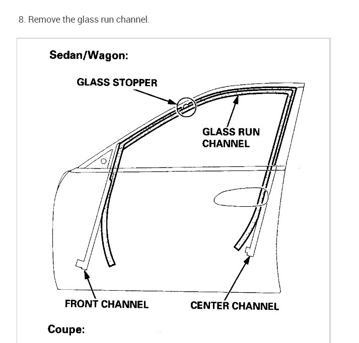

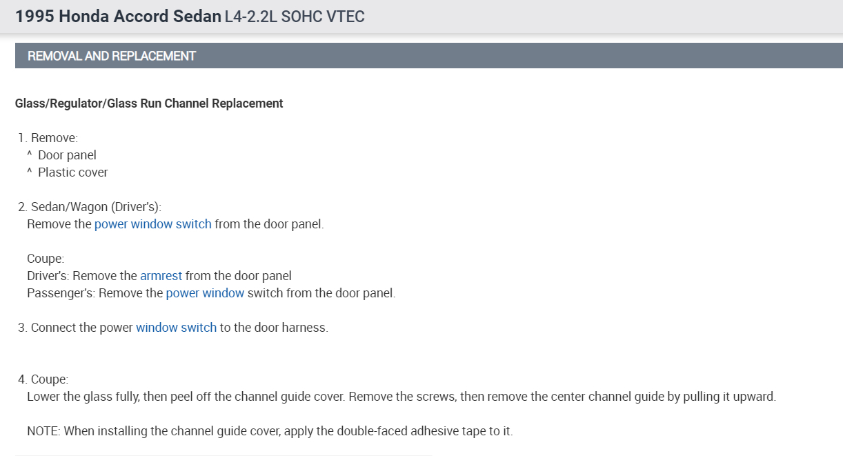

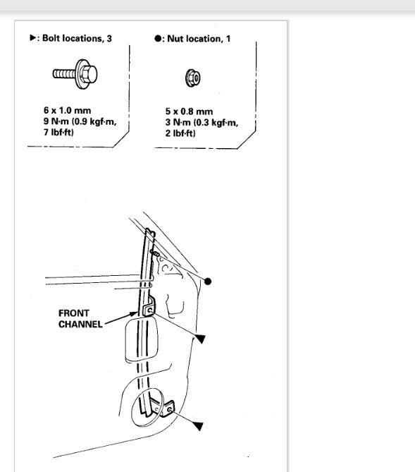

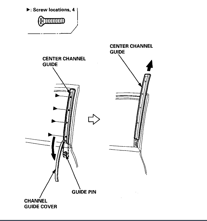

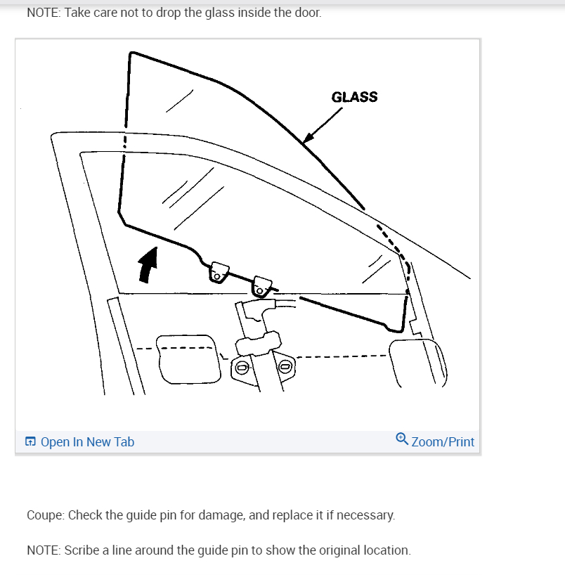

When I roll the driver's side window up it comes out of the track at the top. I noticed a perfectly round hole in the top corner. I think a plug fell out, but I don't know what it is or where to get a replacement. I think it is supposed to keep the window in the track as you roll it up. Can someone tell me what it is called and/or where to get it?
