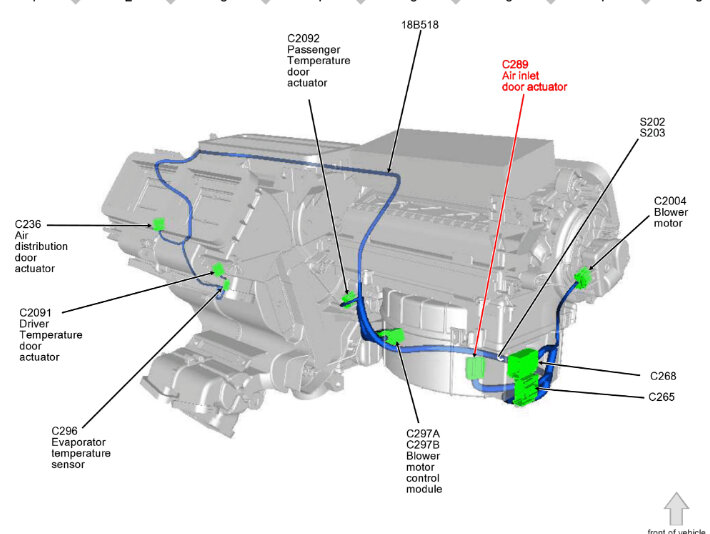

In the schematics posted on other forums, it looks like there is both a passenger and driver control motor, but everyone has only talked about the passenger side and replacing it.

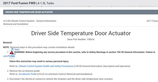

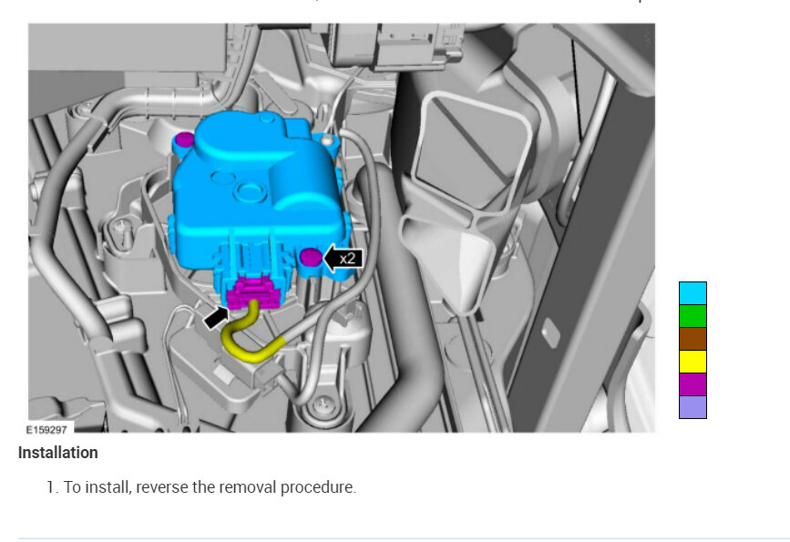

Yes, they do have problems with the blend door actuators, here is the location and instructions on how to change it out in the images below, it looks like it is by the accelerator pedal. I would use an OEM part fyi, they seem to work better. Check out the images (below). Please let us know if you need anything else to get the problem fixed.
