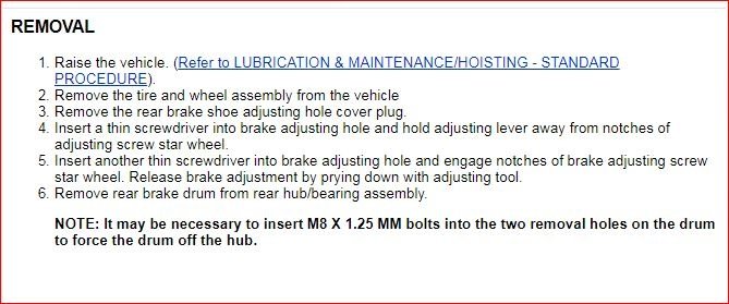

The rear drum is most likely seized to the brake shoes.
There are many ways to try and remove this but unfortunately that is going to be your best way to fix this.
If you try to rock the car to break it loose then most likely you will break something and do more damage then you would if you just get the drum off.
