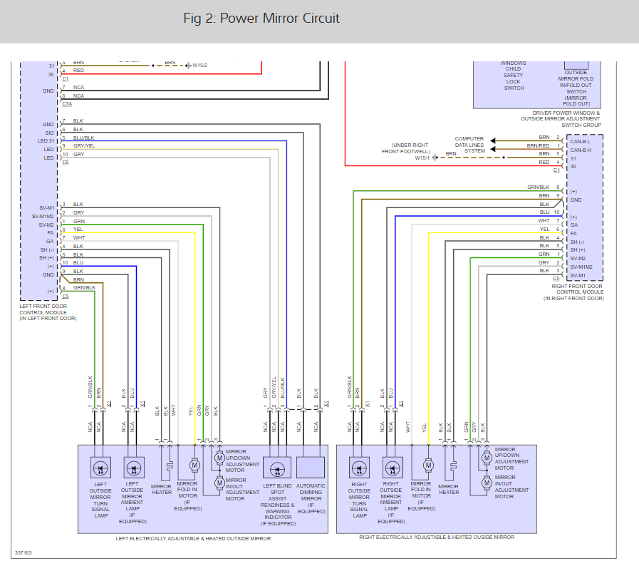

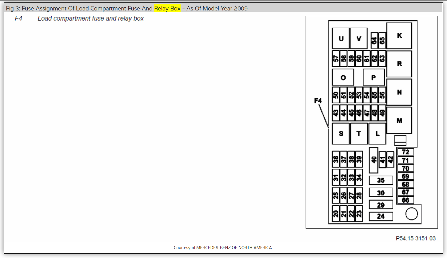

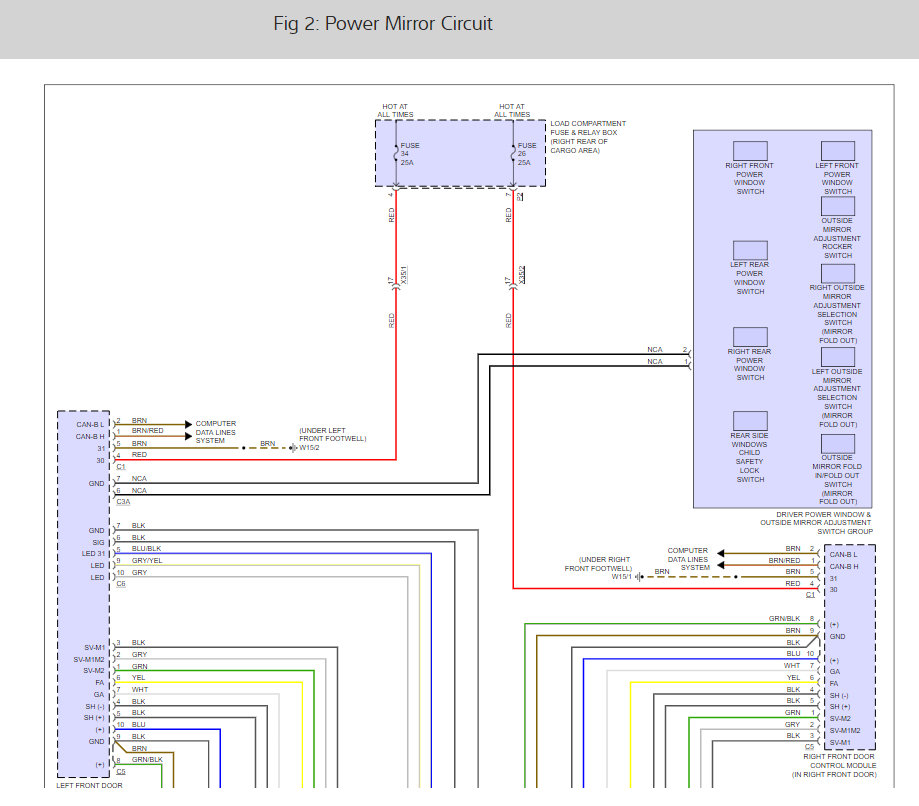

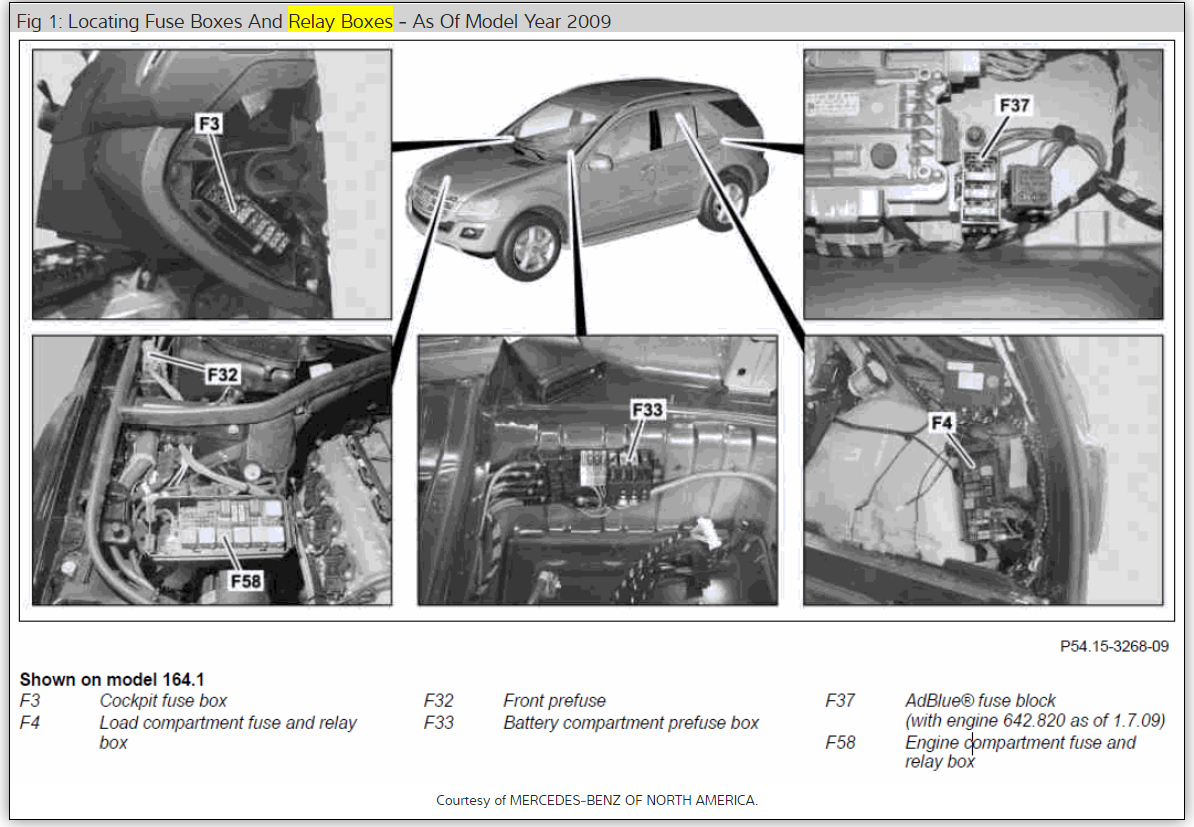

For the power mirror is sounds like the fuse for the drivers side mirror is out. Here is a guide to help you test it and the fuse location with the power mirror wiring diagrams so you can see how it works:
Check out the diagrams (below). Please run this test and get back to us.

Thank you for your help. Both fuses for the left and right mirrors are not blown. It looks like if the fuse for the left mirror was blown, the power fold in feature would not work and yet it does. Any other ideas? Could it be a loose wire to the mirror or in the control module?

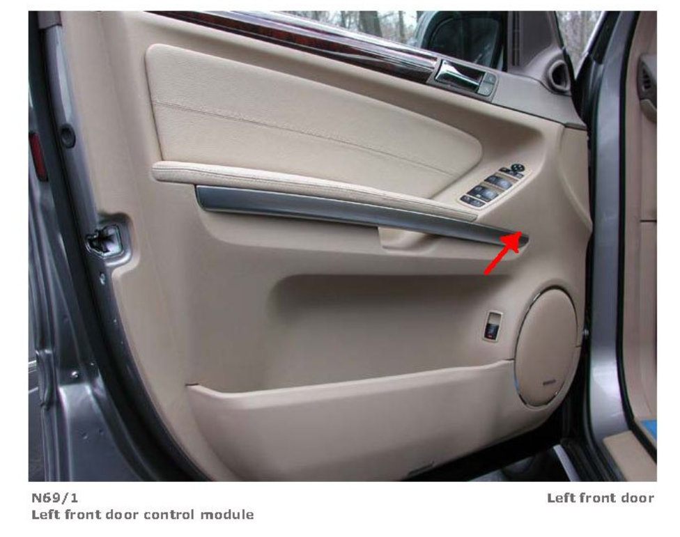

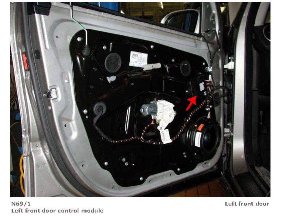

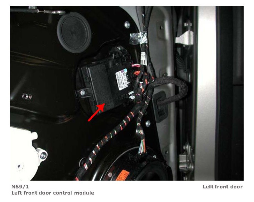

Good call, it sounds like the door module can be out. I would test for an power output to the mirror to confirm the failure. You will need to have it programmed which should run about $130.00 at a shop. There is a chance it might self initialize. Here are diagrams to help you replace it.

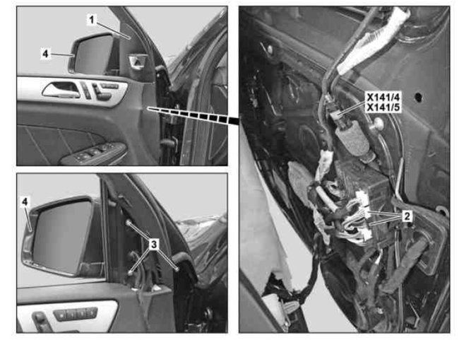

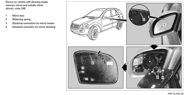

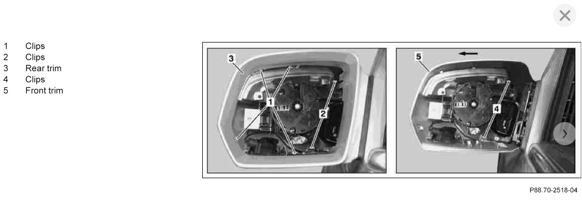

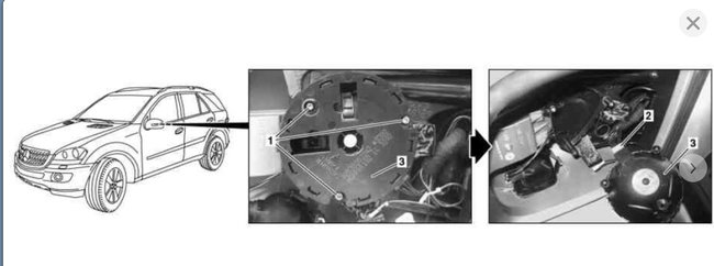

Can you provide any resources on how to remove the side mirror so as to access the wires behind it? I am wondering if they are loose or need to be cleaned up. The mirror folds in so there is some power getting to the mirror, just will not adjust. Thank you.
Nov 28, 2018 at 11:58 AM
Yes that could be, sorry for the slow response. Here is everything we have on the side view mirror below. Please send pictures of what you are having trouble with.
