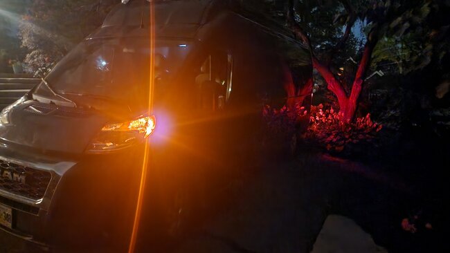

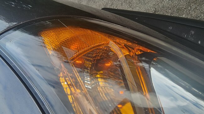

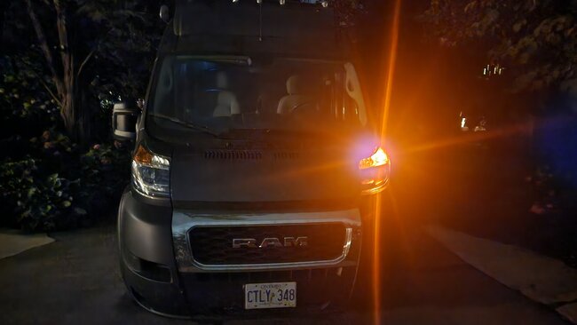

The parking lights on the driver's side have come on and will not turn off: The van has been driven regularly, and had been sitting for a few days in our driveway after returning from a multi-day trip. No issues. Last night, we noticed a faint glow from the driver's side, and discovered that both the front and rear parking lights were illuminated. This was not present the night before. We tried starting the van, checking all switches, moving it, but no change. This morning, the lights are still illuminated.

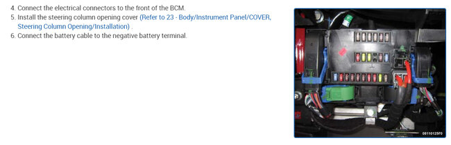

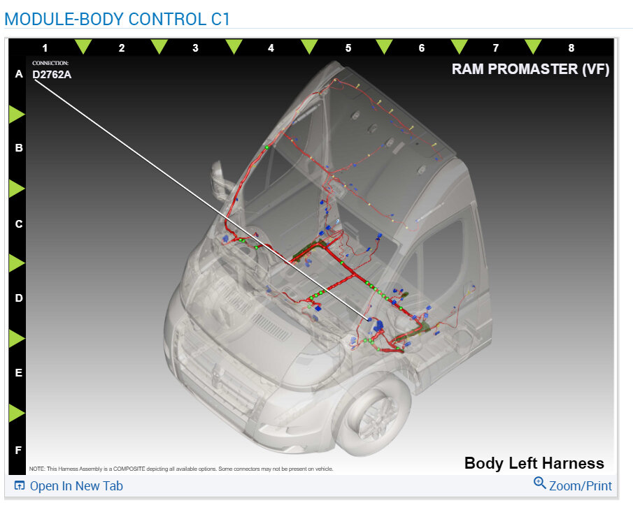

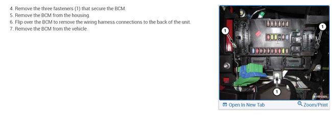

Here is how to change the BCM out and its location, you can get a preprogrammed unit by searching Google or Ebay.
