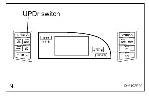

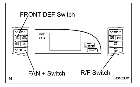

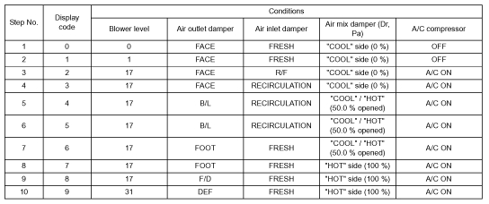

Here is a test you can do, it goes with the images added. It runs the actuators through a test cycle and might let you see what works better.
Image 1 here
a Turn the ignition switch on (IG) while pressing the FRONT DEF switch and FAN+ switch simultaneously.
b Press the R/F (Recirculation / Fresh) switch.
c As each damper, motor and relay automatically operate the actuator check at 1 second intervals from step No.1 to No.10 continuously check the temperature and air flow visually and by hand.
Image 2 here
d If a slower display is desired, press the driver temperature up (UPDr) switch and change the display in the step operation. Each time the driver temperature up (UPDr) switch is pressed, the display changes by 1 step.

Image 3 here
e To cancel the check mode, press the "OFF" switch.

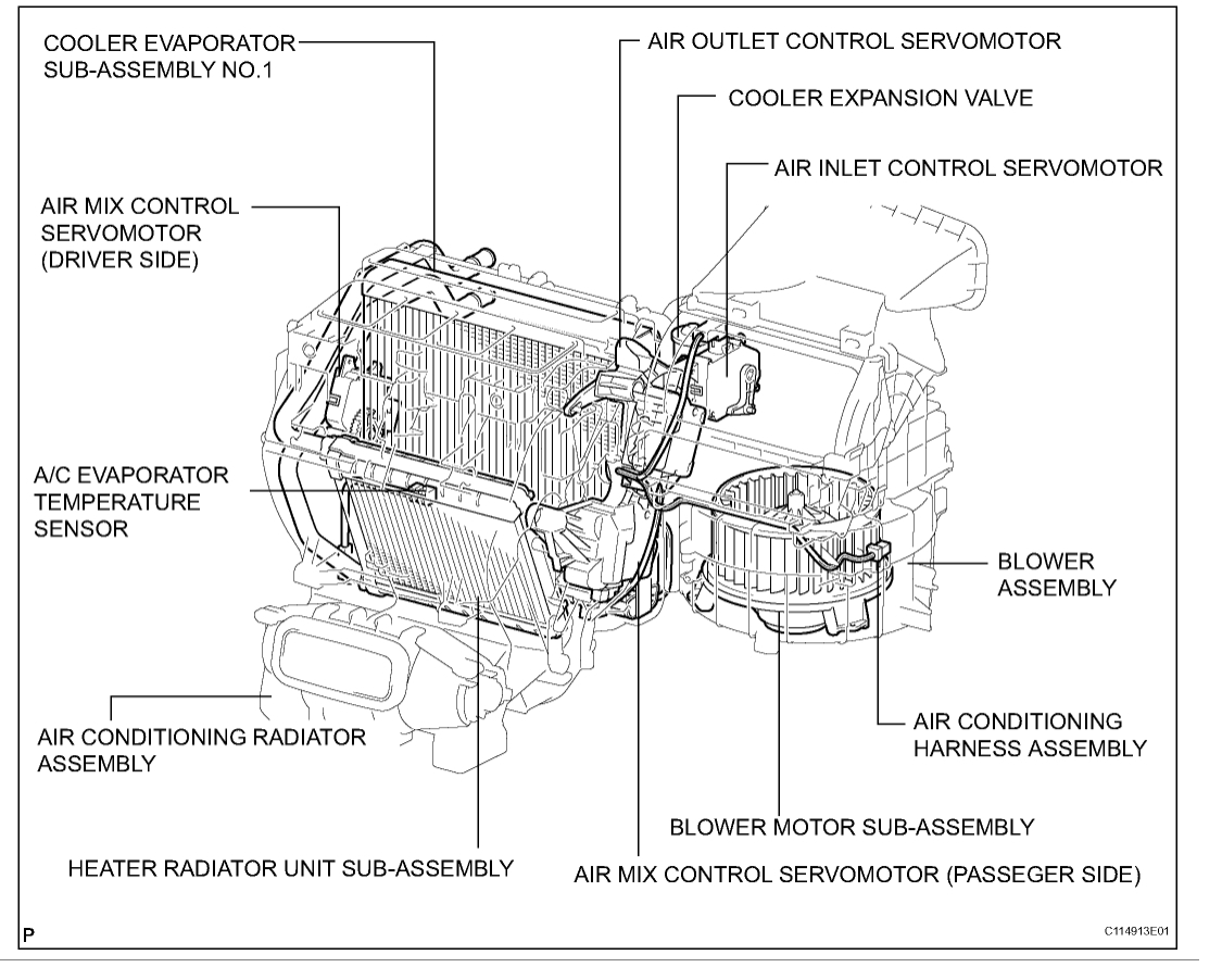

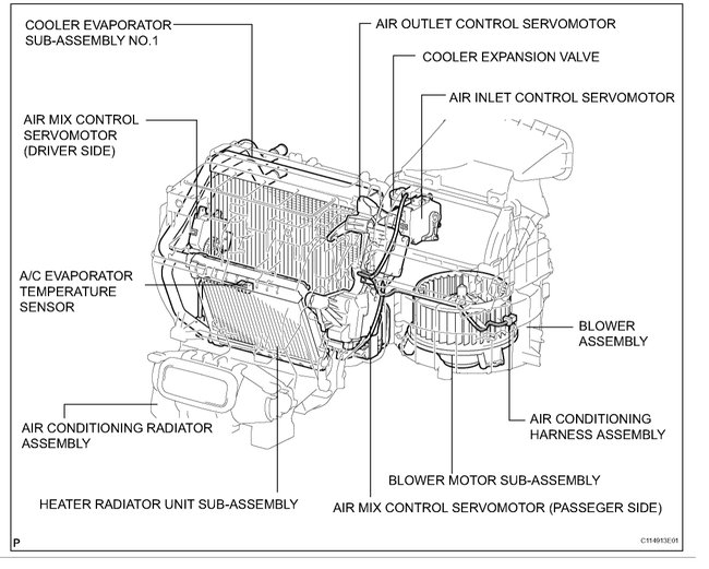

Here is a actuator diagram to help us see whats going on and to make sure we are all on the same page.
It sounds a little expensive what do they is wrong?
