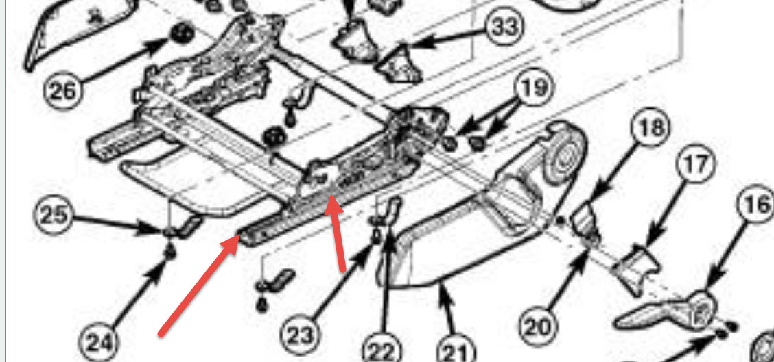

My girlfriend is five feet tall and I am 6'4, so when I have to drive her car I have to pump the seat manually down in order to get into the vehicle. When she drives the vehicle she has to manually pump the seat up to drive the car. The lever to manually adjust the seat up and down is suck and will not move the seat up and is stuck down. I ripped apart the seat, but do not know what to attack from here.

I am assuming you are meaning forward and back so with seat out check to see if anything is caught in the track or a spring is broken for the lever from one side to other. or a rod. normally that is what happens in a case like this. see picture.
