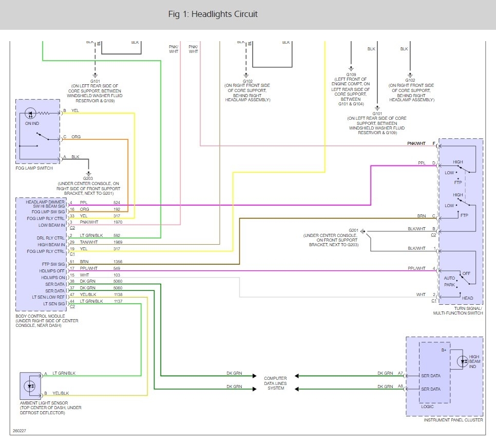

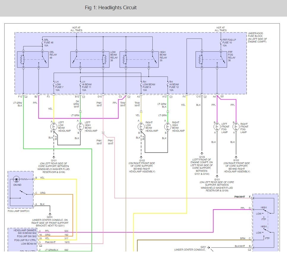

The BCM runs the lights, please check all fuses.
Here is a guide that should help you.
Here is the wiring diagram (below) so you can see how the system works.
Check the wiring as well
Please let us know what happens, we are interested to see what it is.
