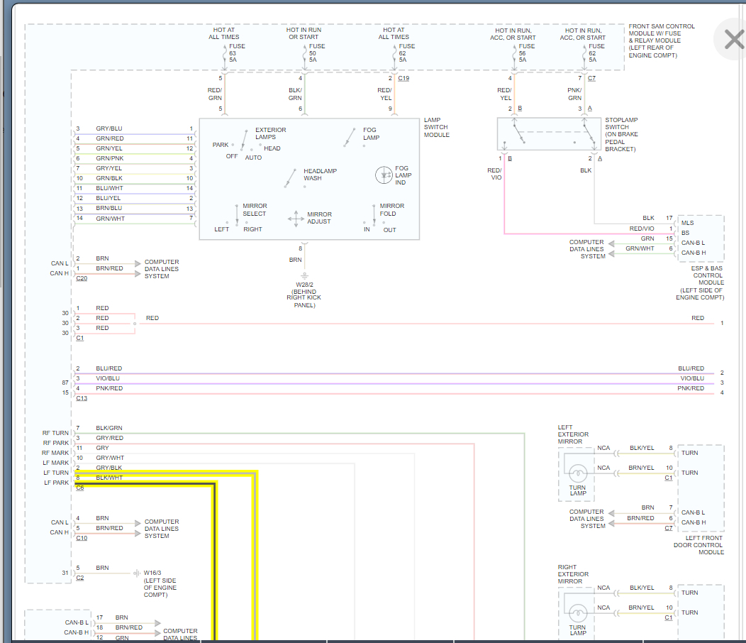

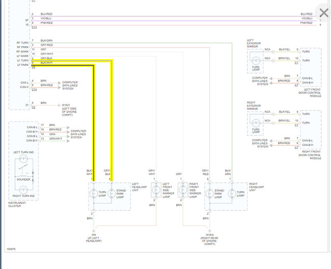

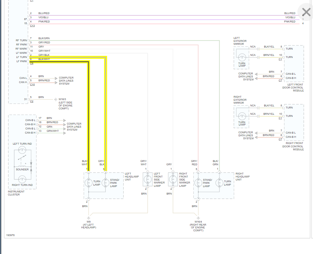

This is most likely a short in the front SAM module.
The front SAM module is basically the lighting control module that is responsible for taking the different inputs from switches and things, and then it sends the voltage to the lamp.
The way to prove this is to check voltage coming into the SAM module from the lamp switch with it off and make sure you have no voltage coming from it.

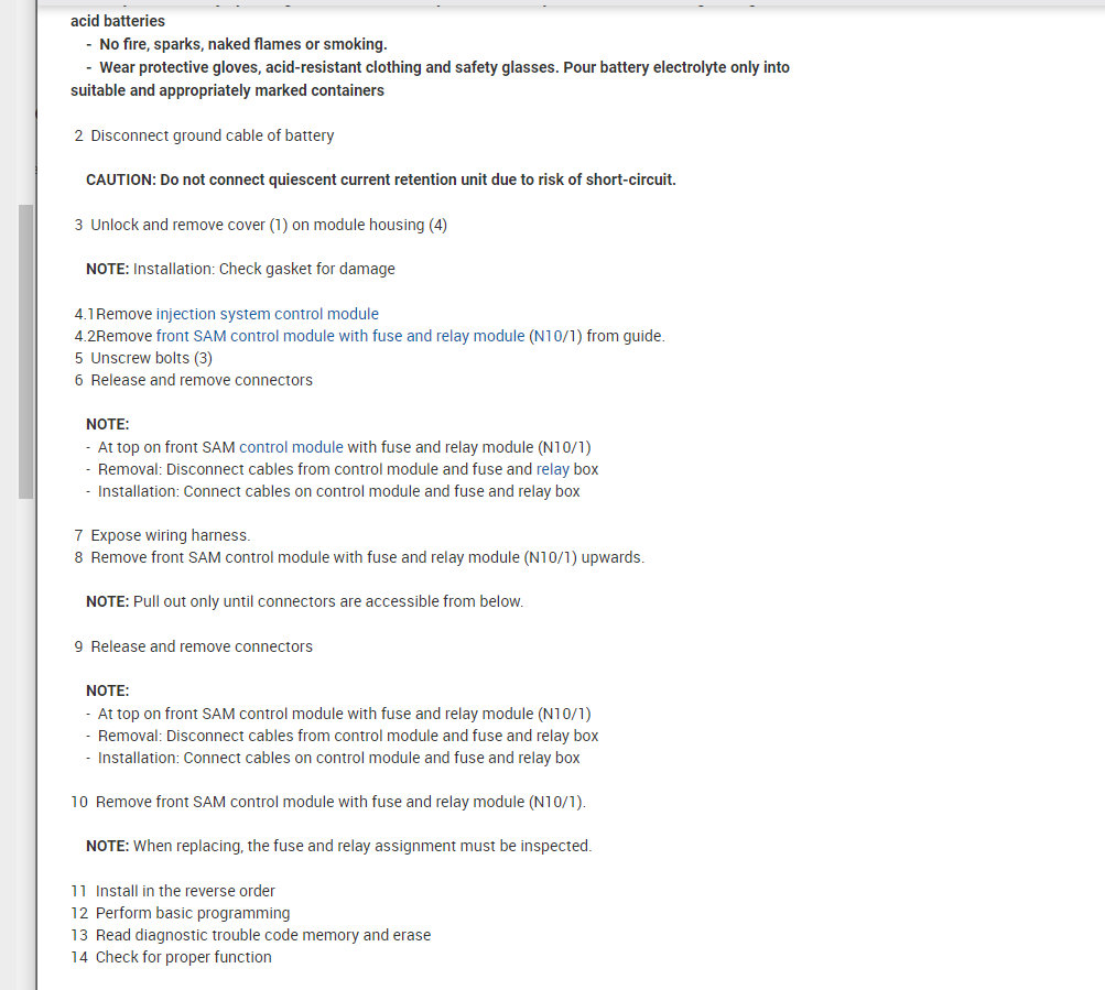

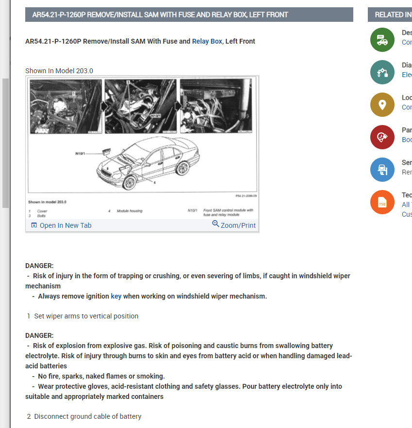

Here is a guide that will help with this:
However, this is very unlikely because if the switch was the issue then it would not be just one light that is affected.
So for it to only be one light this would be more of a control module issue.
So if it were me, I would unplug the connector and make sure the wires are not shorted to power and then replace the SAM.
Please let me know if you have questions.
Thanks
