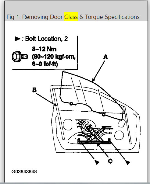

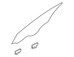

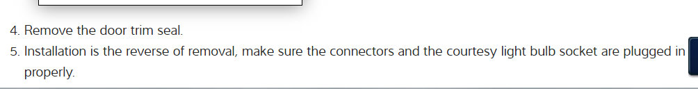

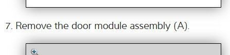

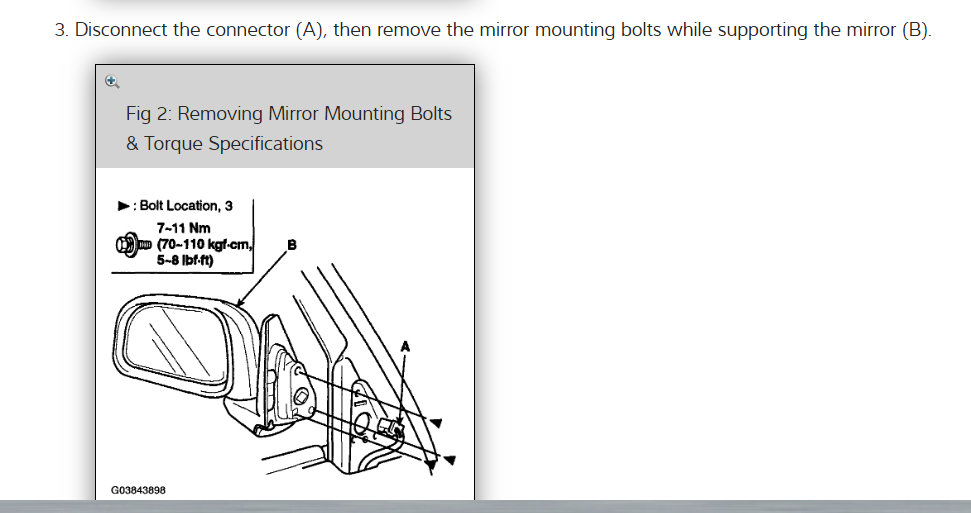

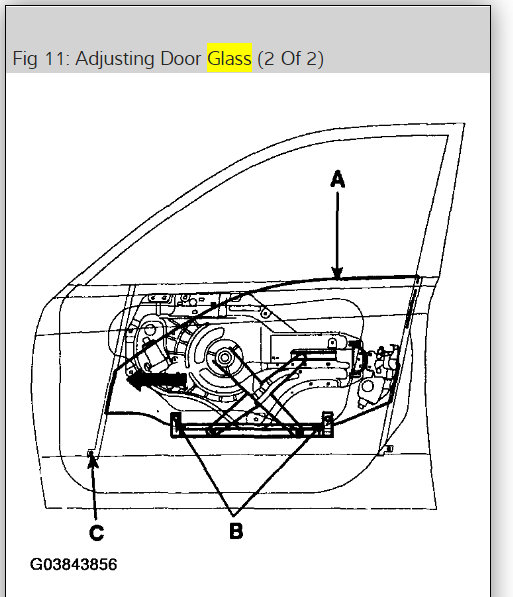

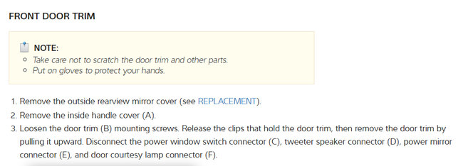

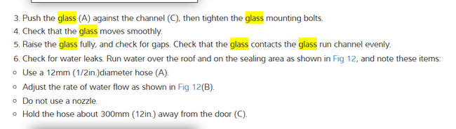

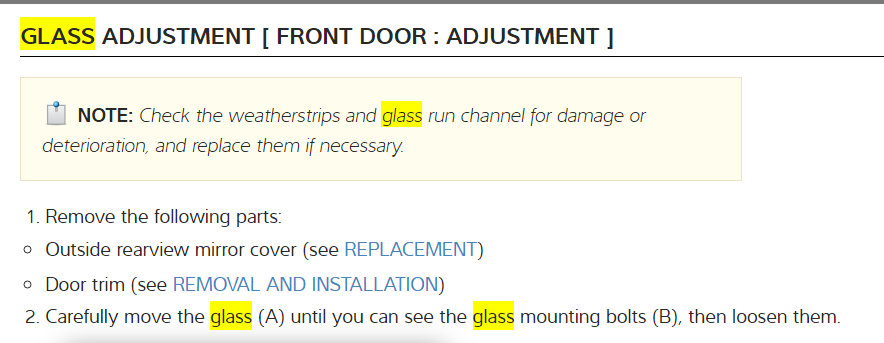

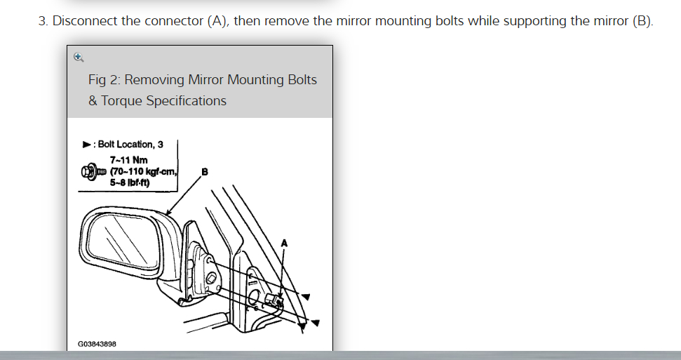

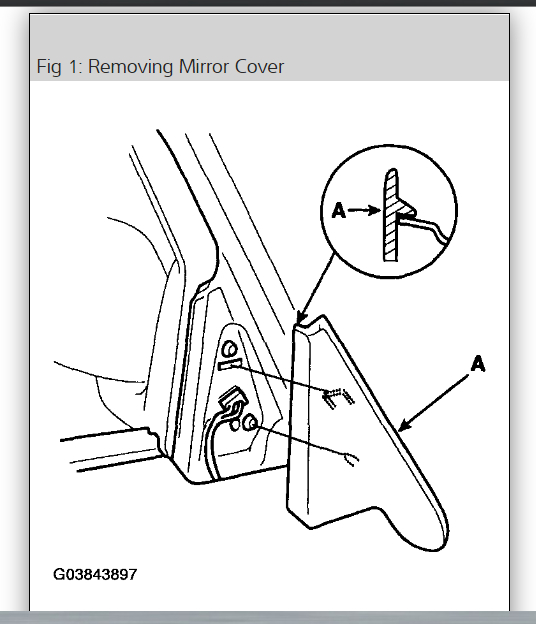

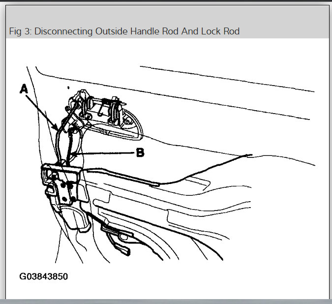

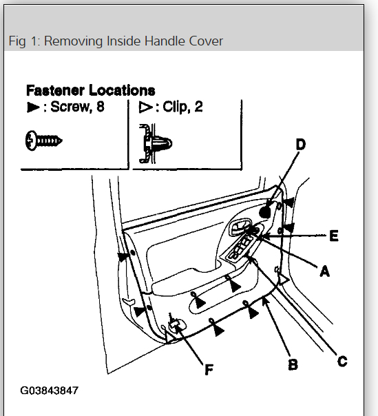

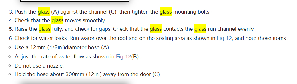

The rear window clip that attaches the rear of the drivers side front window to the power window rail has pulled loose from the window, allowing the window to jump the guide tracks. The bracket where it is attached to the window has no clamp, the clip appears to have been pressed/glued onto the window. I have attempted to glue it back in place with contact cement, but the window came out of the clip again. There is no way to manually tighten it to the window. What is the proper way to fix this problem, and does it take a specific type of adhesive to reattach this clip. There is no information available in the service manual.
