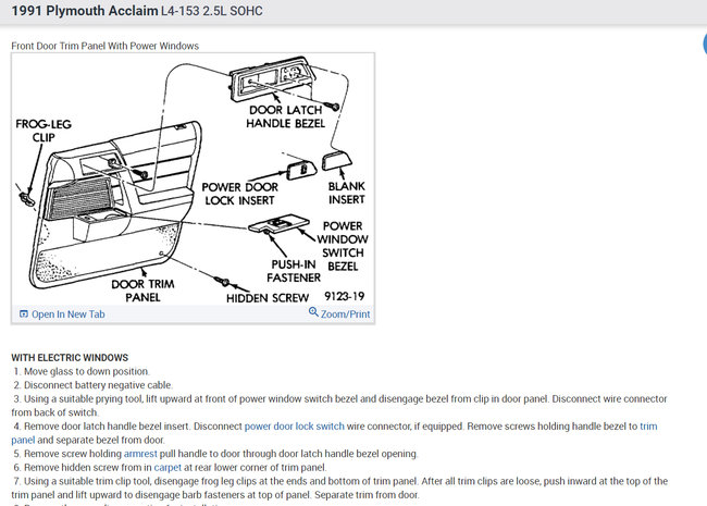

No, you will need to remove the door panel. Check out the diagrams (below). Let us know what happens and please upload pictures or videos of the problem.
