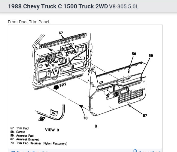

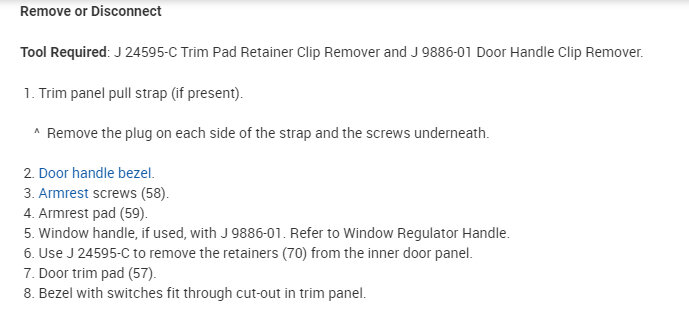

You will need to remove the door panel. To do this, the armrest needs removed as well as the window crank (with manual windows) and the door handle bezel. Once they are off there should be either steel or plastic retaining clips.

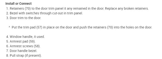

I attached the directions for removing the trim panel below.
