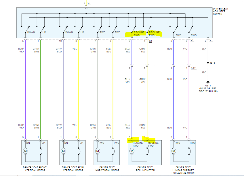

I just looked at the schematic and I feel it is the switch. The two wires you are looking or related to the incline function via the same switch. When you move it downward, power travels one direction. To raise the seat, power is supplied in the opposite direction (change in polarity) causing the motor to run in the opposite direction lifting the switch.
I attached the schematic below. The two wires you are looking for are highlighted in the pic. The power to lower the seat is sent via a blue wire with a yellow tracer. The one to lift it up is a green wire with a yellow tracer.
If you have a test light, see if power is provided to those two wires based on the requested positioning.
Let me know what you find.

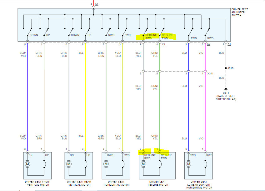

See pic below.
