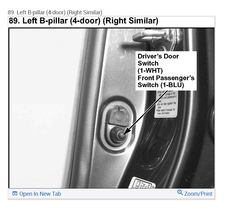

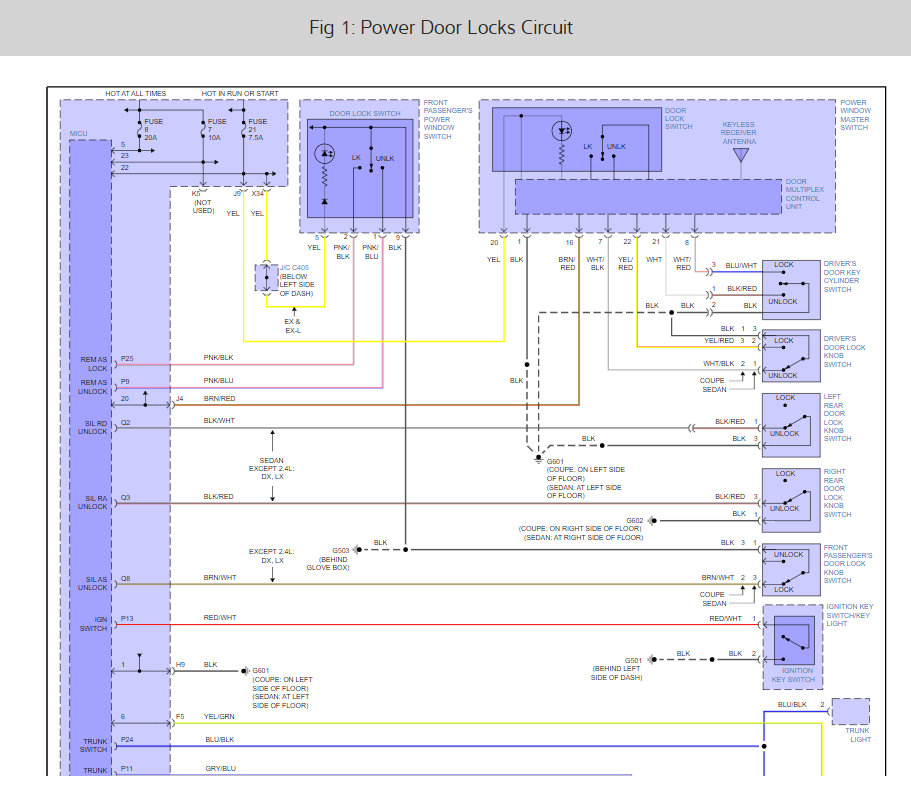

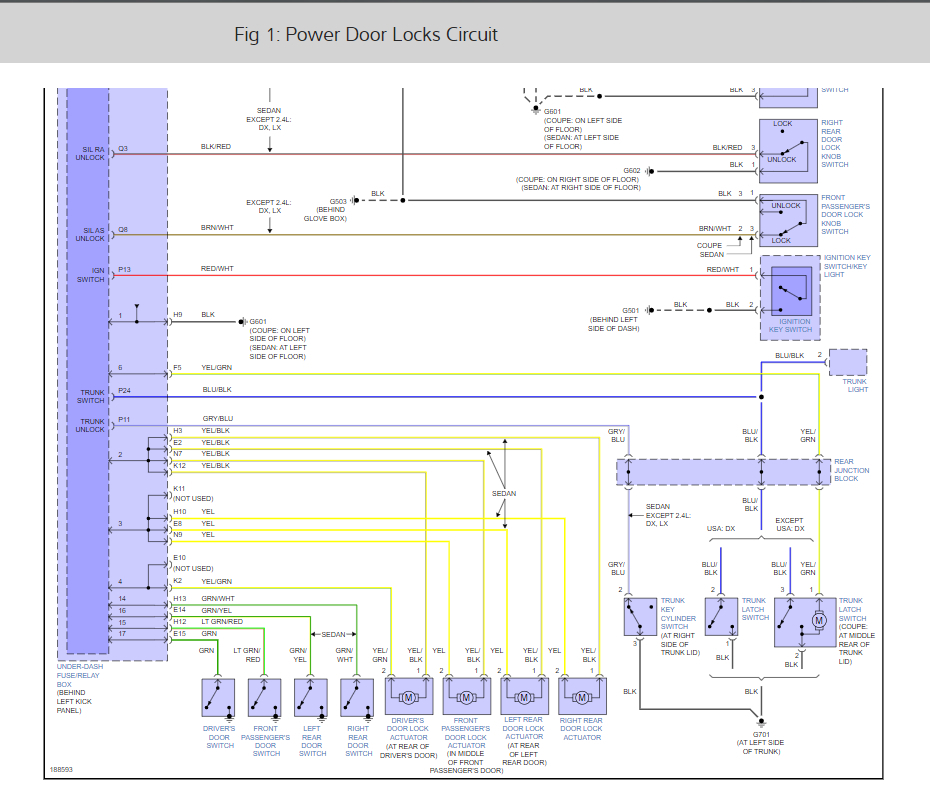

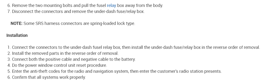

When the driver's door is opened, the gauge cluster still shows that the door is closed. I swapped the actuator with on the body from the driver's door with that of the rear passenger's door, and the gauge cluster shows/picks up that the rear door is open, but still shows the driver's door as closed, indicating that the problem is not with the switch itself, but somewhere else.

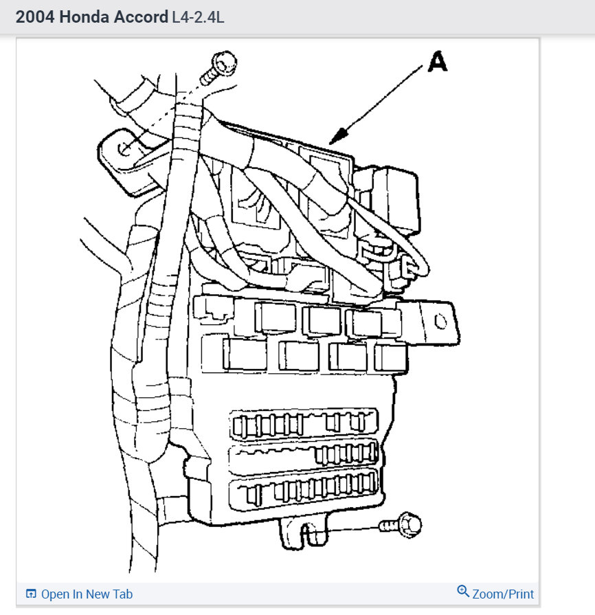

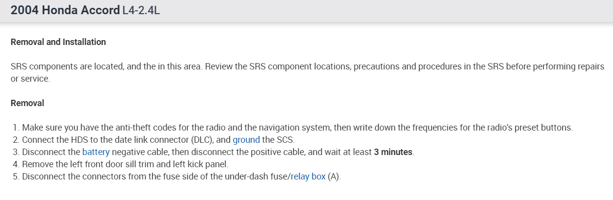

I found this website because of this link below, which especially shows the Under Dash Fuse/Relay Box.
https://www.2carpros.com/questions/remote-power-locks
How can I reset either the Control Unit, or figure out exactly which wire may be the issue, and most importantly, how to fix it?
