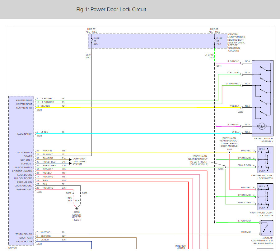

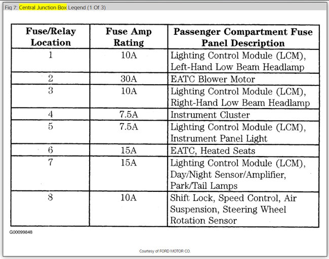

My drivers door module is not getting power. what relay supplies power to this module?

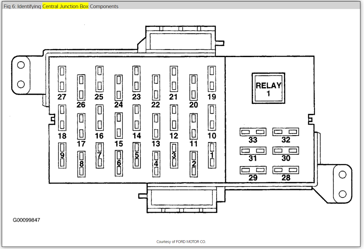

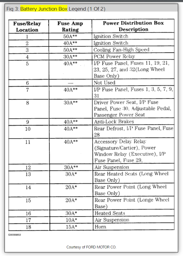

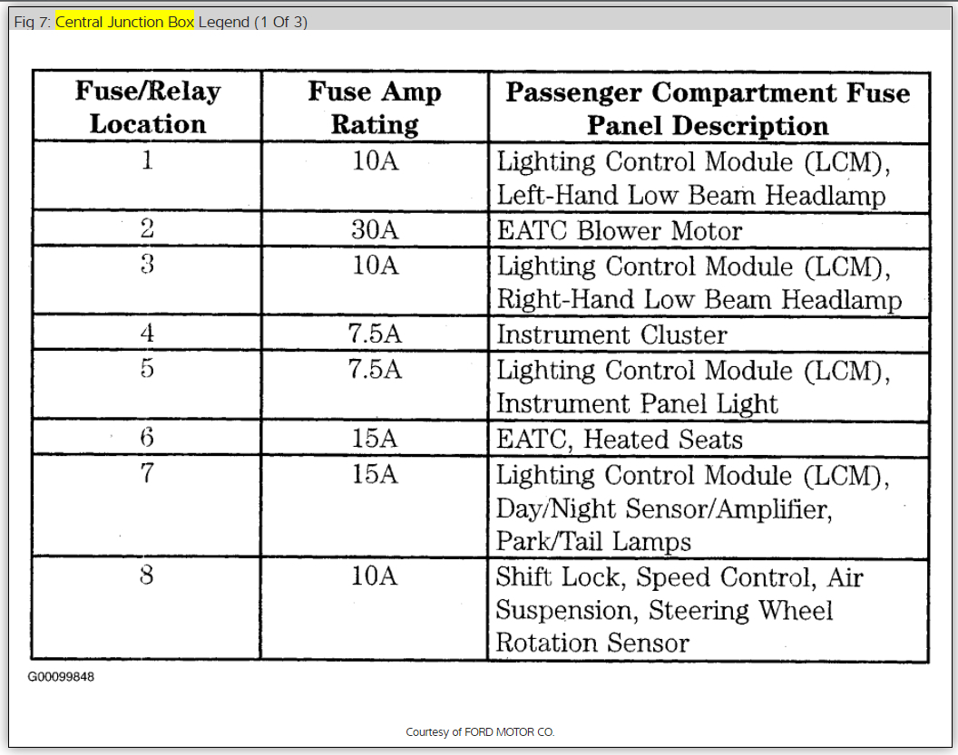

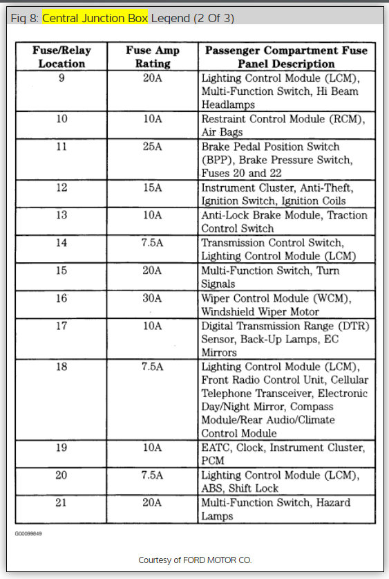

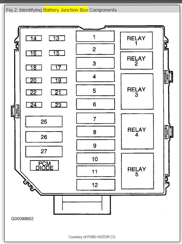

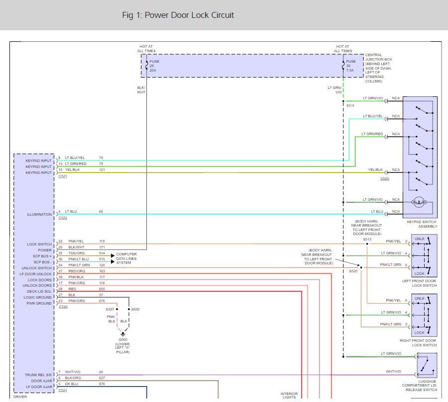

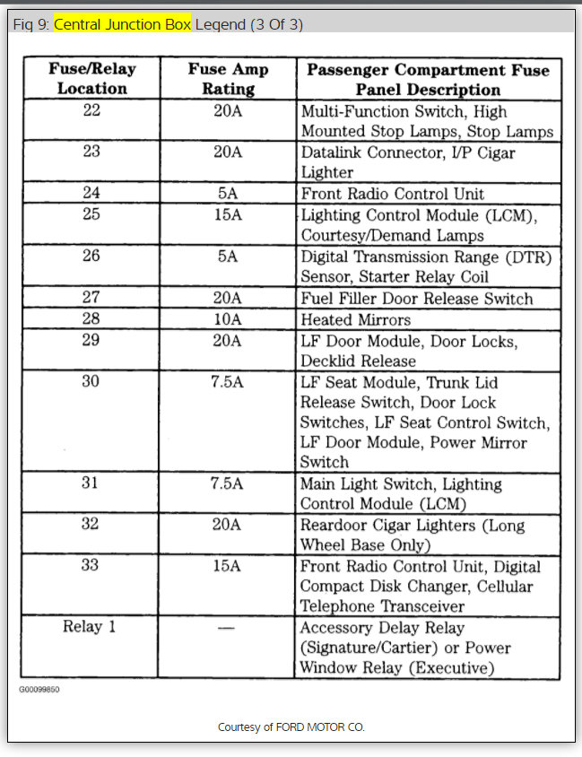

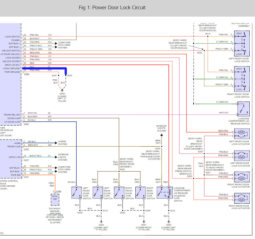

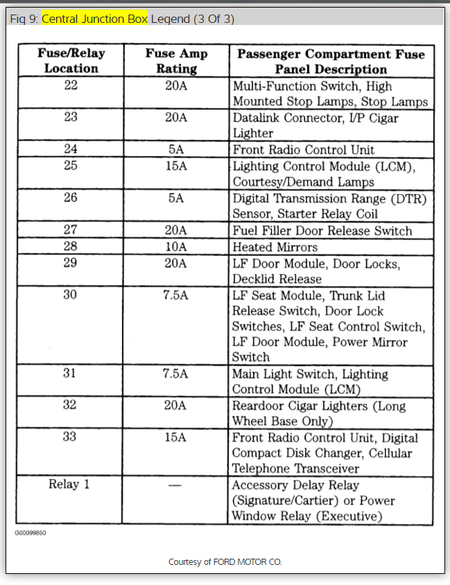

It looks like it is fuse #29 that power up the system. Here is a guide and a diagram (Below) to help you get the job fixed:
