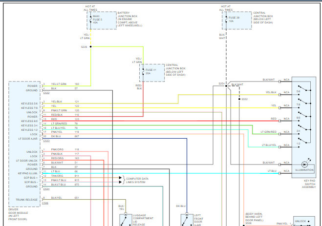

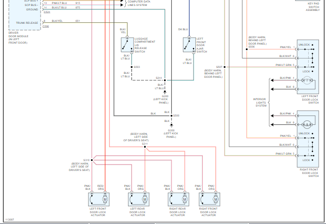

There isn't one diagram for everything in the door. If the wires are okay, we'll have to pick one system and start with that

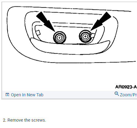

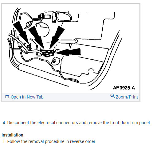

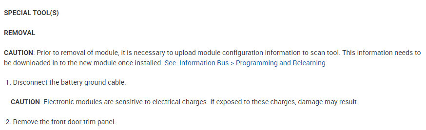

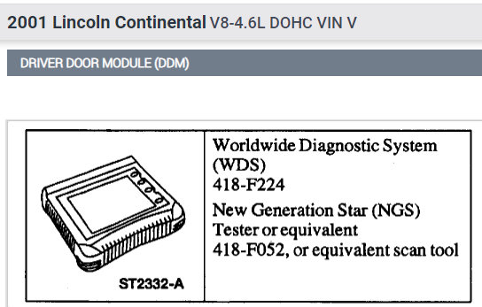

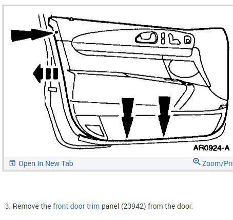

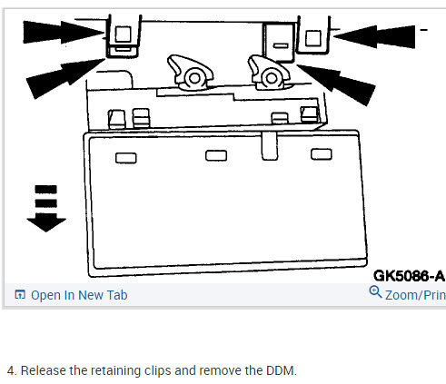

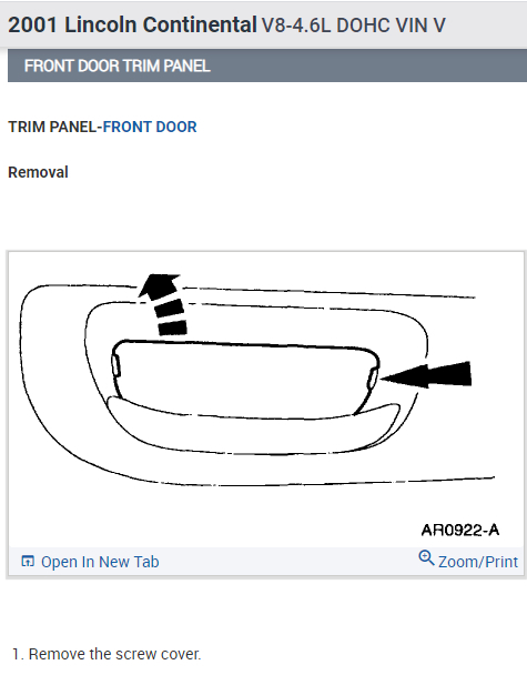

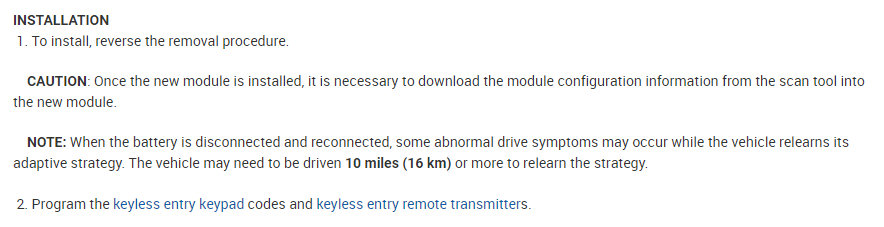

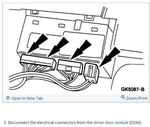

Yes, it sounds like you are having a DDM- driver door module or wiring problem related to the ddm. Here is a door panel removal tutorial and a wiring testing tutorial:
https://www.2carpros.com/articles/door-panel-removal
I've attached picture steps below on door panel and the ddm removal and replacement. I've also attached below the wiring diagram for the power locks for your car. Hope this helps and let us know what you find. Thanks for using 2CarPros.
