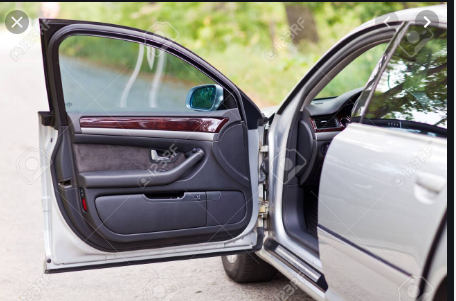

Okay. If the picture below is what you are experiencing then you have an issue with one of the hinges. More than likely it is bent or otherwise binding. This is pretty typical on truck driver doors. Especially when the driver leans on the door when getting in and out. It puts stress on that hinge and it finally bends to the point the door will not move or even close because it is not aligned any longer. Try picking up on the door and then closing it. If this helps then you need to replace the hinges and possibly fix the structural issue on the A post.
