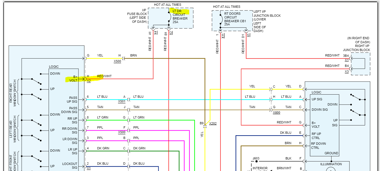

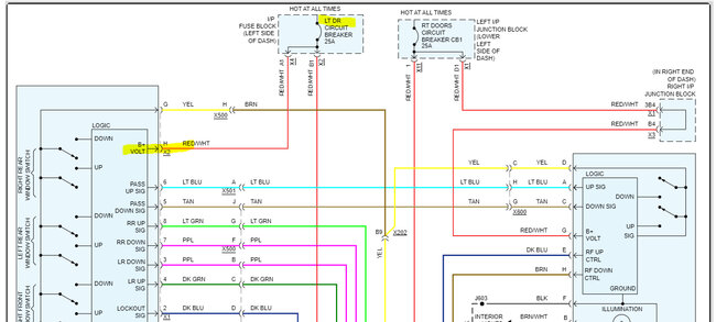

Lost all power and functions on the driver door only?
2013 CHEVROLET 3500
150,000 MILES • 6.6L • V8 • TURBO • 4WD • AUTOMATIC
CHERI BARZEE
Drivers Door.
Jul 26, 2023 at 7:58 PM
The left door has a separate circuit breaker. See pic below. At the main switch, there will be a red wire with a white tracer. Check to see if it has power (12v). Note: The circuit breaker is located in the interior fuse box on the left-hand side of the dash.
Let me know what you find.
joe
See pic below.
