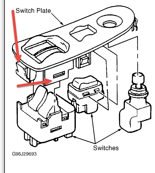

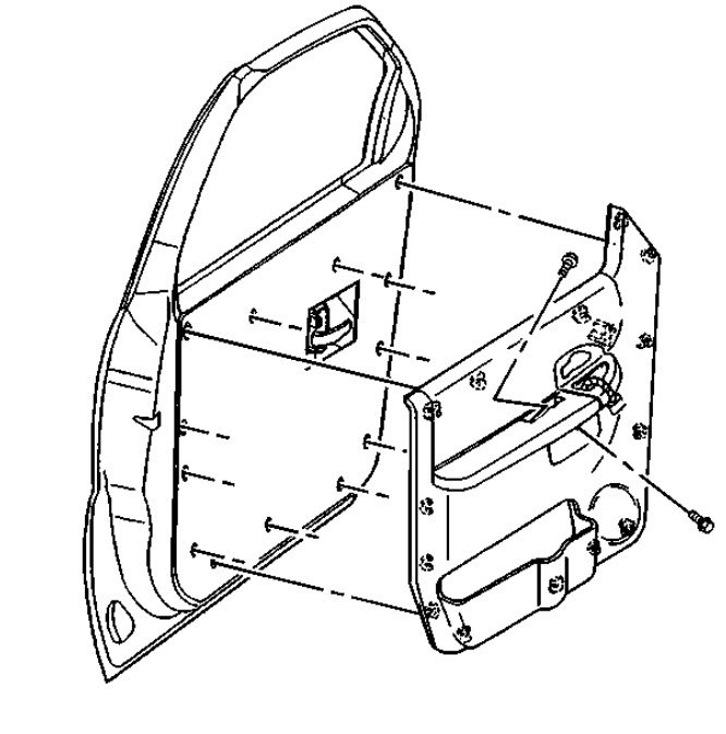

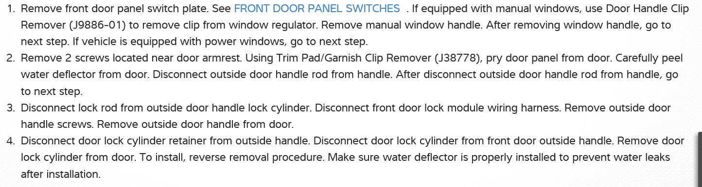

Need to take off for panel to replace window clip. The motor for the window works, but it is clearly off track.

it may have a broken roller when you get to see it inside.we dont' have apicture of your year door the door pic is off a 2004 which yours will be similar.
