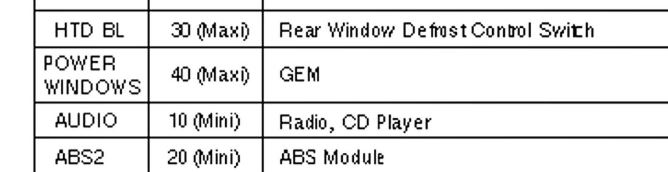

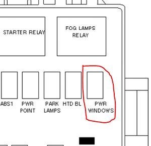

First start with checking the PW maxi fuse under the hood. I attached a picture and circled the one to check. Also, note that there is a component called a GEM (pic 2). That stands for generic electric module. That could be bad too.
What to do is have someone actuate the windows so you hear the clicking. See if you can feel if there is a relay in the under hood fuse box making the noise. You won't get shocked.

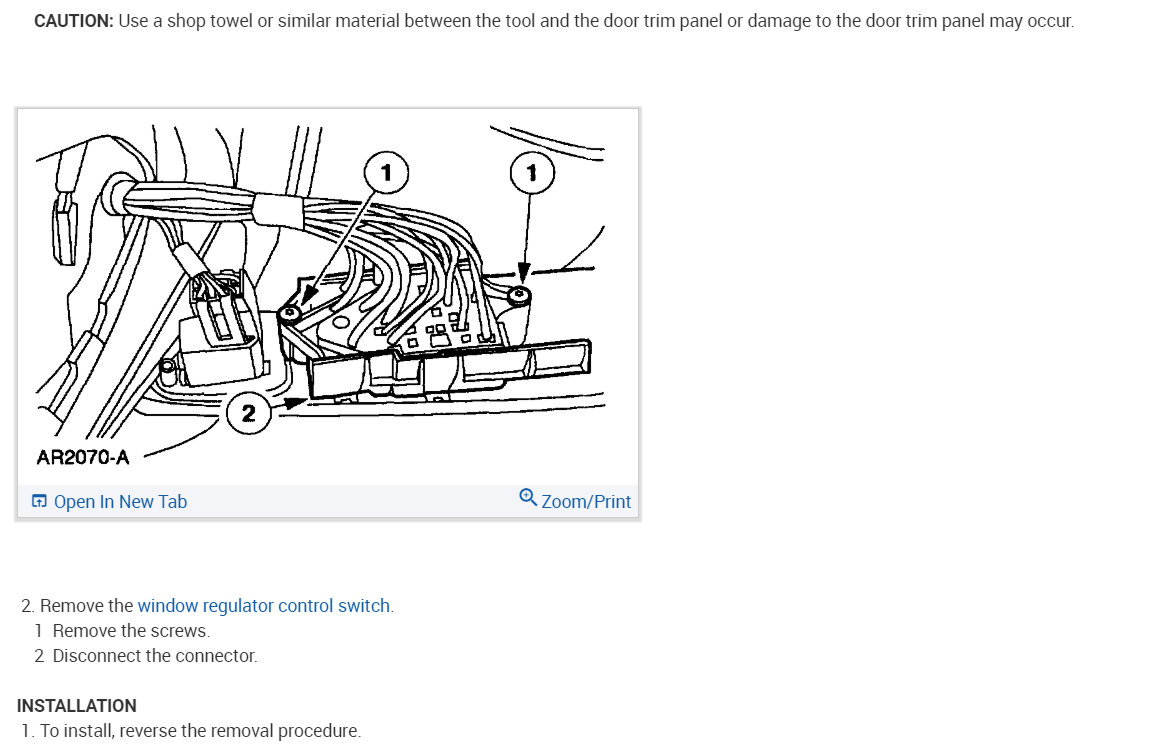

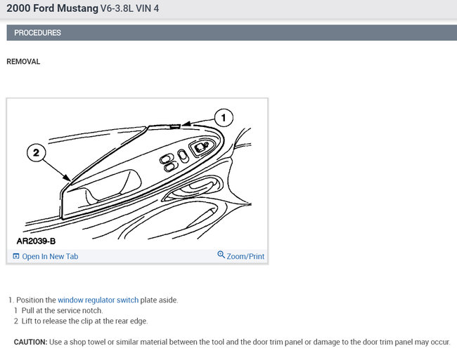

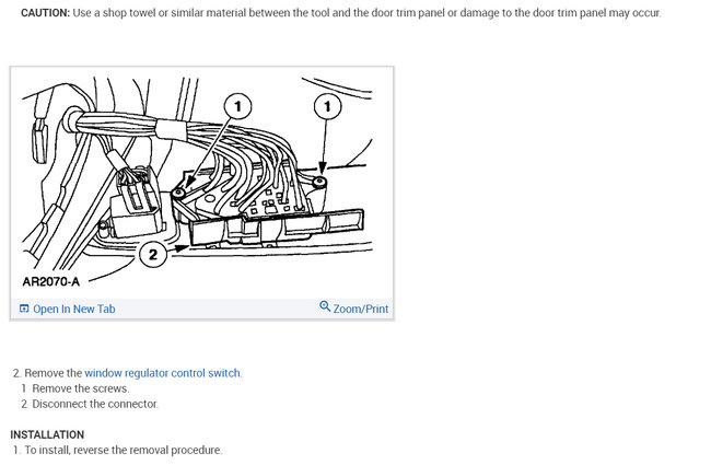

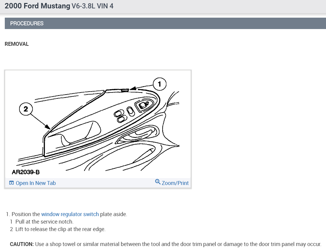

The main window switch can cause this. To be sure here is a guide to help you test it and instructions to change it out in the diagrams below:
https://www.2carpros.com/articles/electric-window-repair
