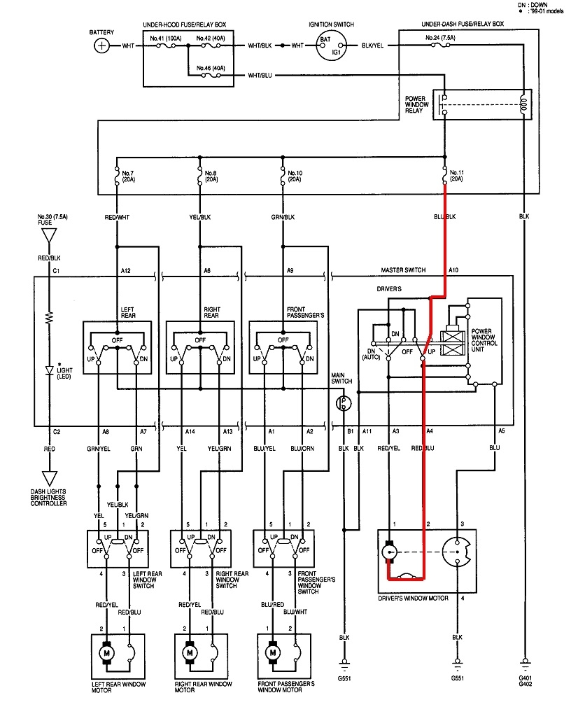

The driver windows went down and it wont go up, I replaced the regulator with the motor, the master switch assembly and switches and it still wont make the glass go up, I was able to get it up manually , it will go down but wont go up. Any sugestions? thank you

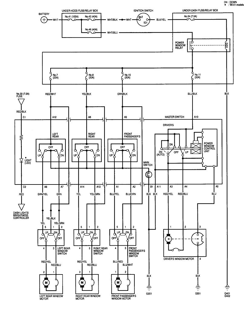

The motor is not suspect. It has to be okay if it runs one way. The same is true of most of the wiring. It is shared in both directions. What is not shared is part of the "Down" switch. Half of it remains grounded when you press the "Up" switch to provide the ground for the motor. The test for this involves taking voltage readings on the two wires at the motor. With all the switches released, you will find 0.0 volts on both wires. I highlighted the "Up" circuit in the second diagram, with the red line. When you press the "Up switch, you should find 12 volts on the red / blue wire. Of equal importance, you must find very close to 0 volts on the red / yellow wire. If you find anything other than 0 volts, there has to be a break in that ground circuit. We know it can't be in the wires because they're used for the "Down" function too. The only part of that circuit that's left is the released half of the "Down" switch. Let me know what you find with these voltages.
