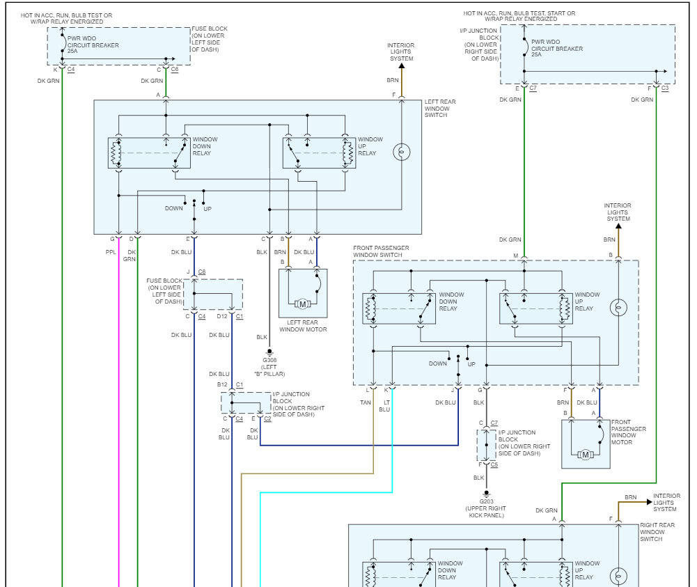

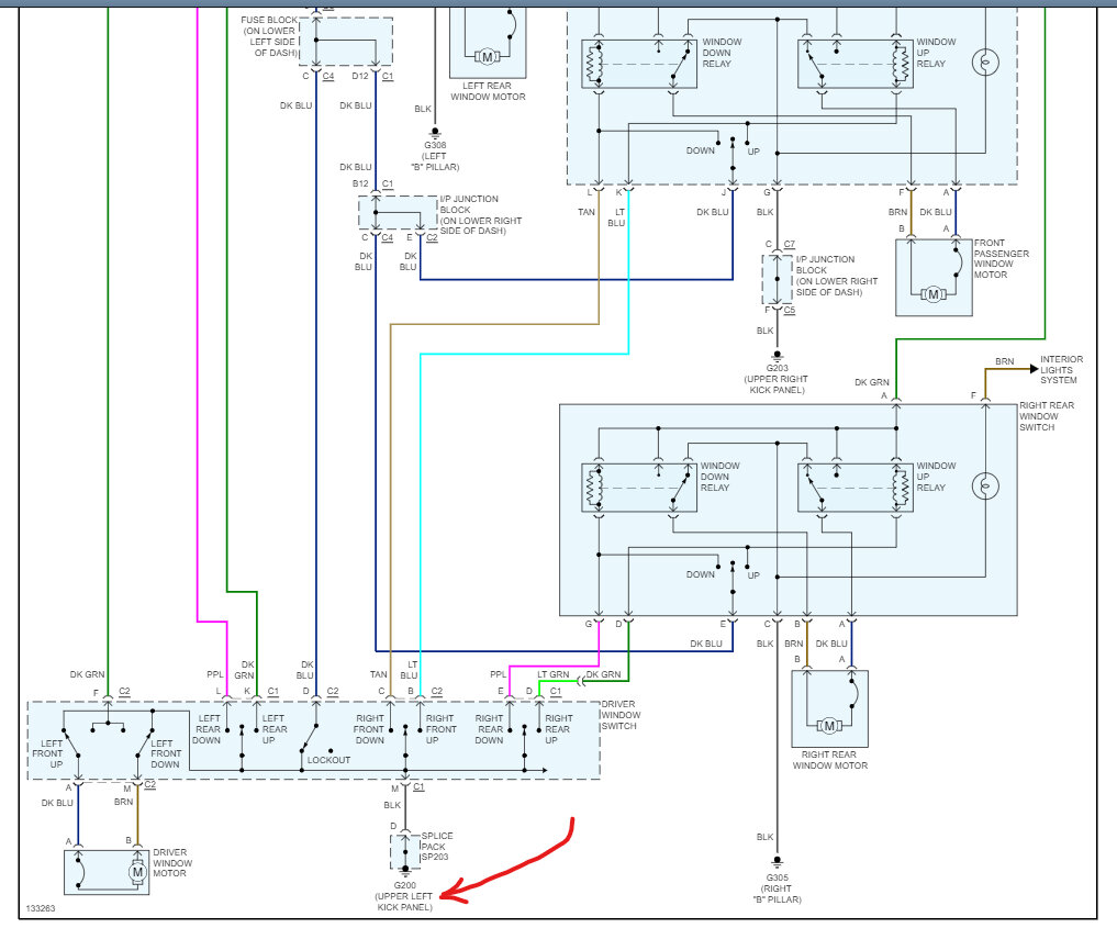

It sounds like you have a bad ground G200 (upper left kick panel) the black wire coming out of the main window switch. I would work the switch and if the black wire lights up the ground is bad, here is a guide to help and I have included the window wiring diagrams so you can see how the system works:
Check out the images (below). Let us know what happens and please upload pictures or videos of the problem so we can see what's going on.
