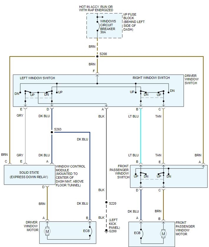

So the driver window stopped working. Tried to put a new motor on the plug to see if the motor works, nope. I'm convinced it's a wire broken somewhere. I've been trying to look at the wiring between the door but it's really hard to get to.
