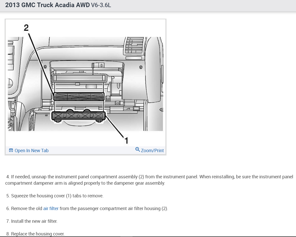

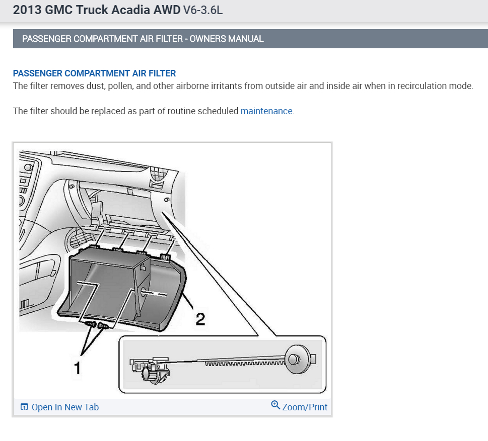

This is common when the cabin air filter gets plugged up. here is a guide to help walk you through the steps with instructions in the diagrams below to show you how on your car:
https://www.2carpros.com/articles/how-to-change-an-air-cabin-filter
