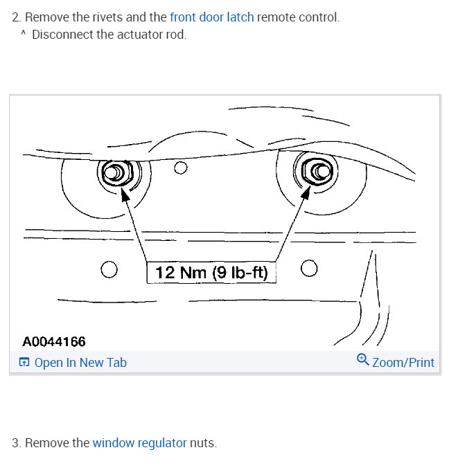

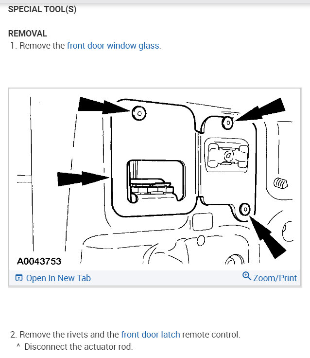

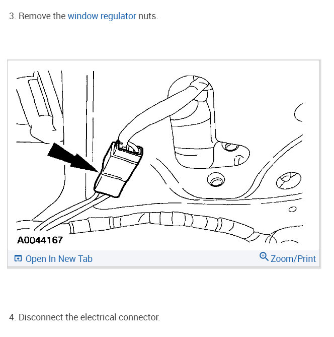

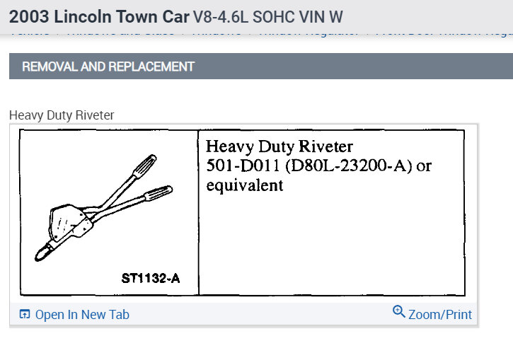

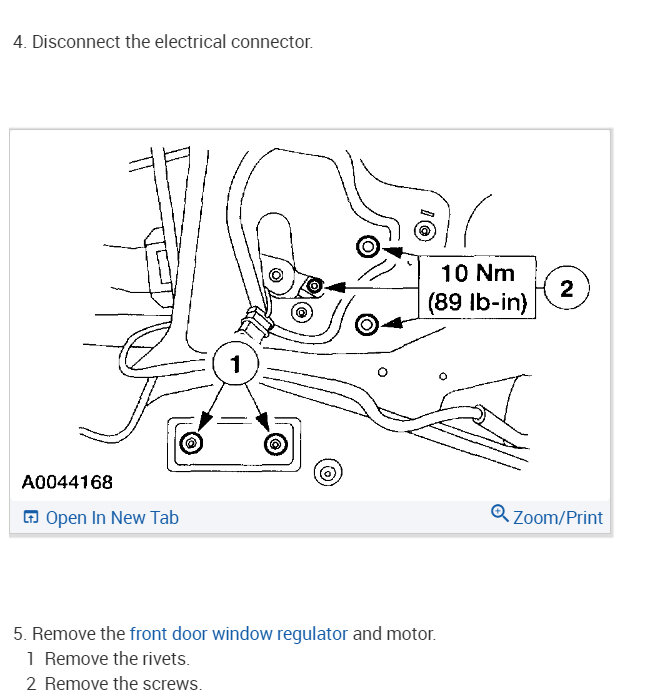

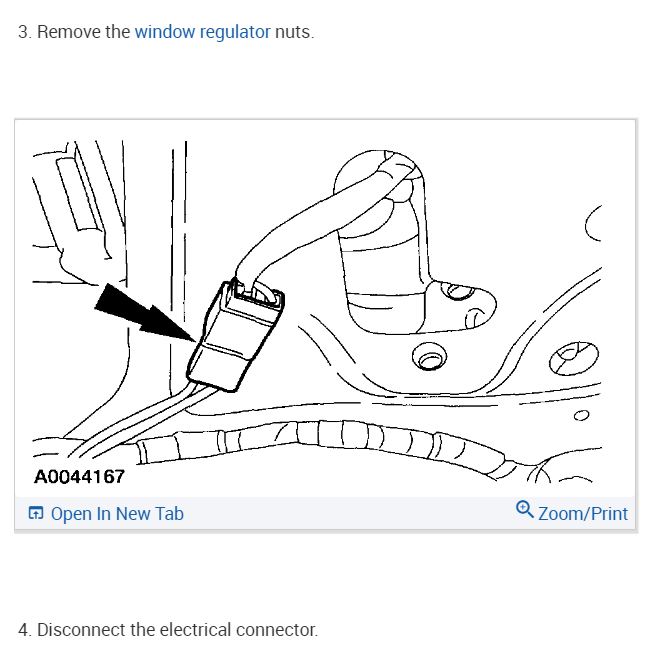

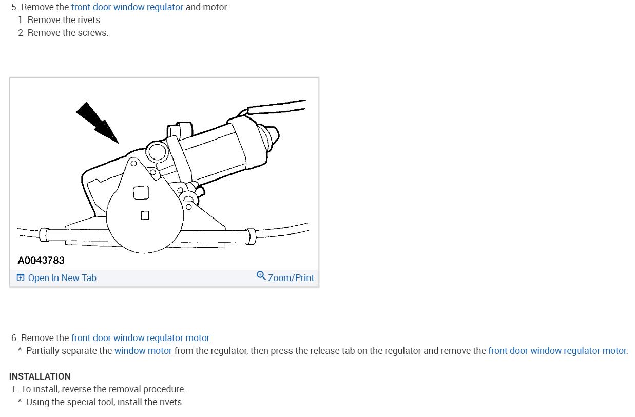

Yes, this happens when the window regulator goes out and needs to be replaced. here is the job being done on a similar, I have included the instructions for your car in the images below:
https://youtu.be/oNxstjcA25k?si=oK05v1pl1KU959Il
Check out the images (below). Let us know what happens and please upload pictures or videos of the problem so we can see what's going on.

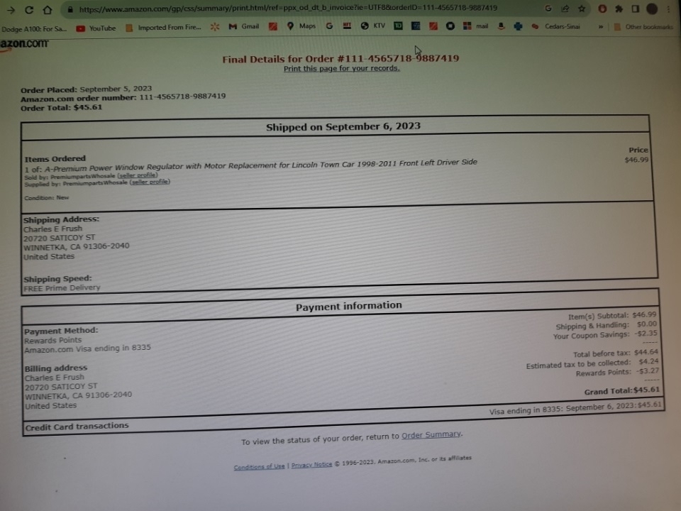

It looks like the regulator is defective, can I ask where you got it?
Sep 20, 2023 at 8:53 AM
CFRUSH1
  • 73 POSTS
Amazon.
Invoice attached.
