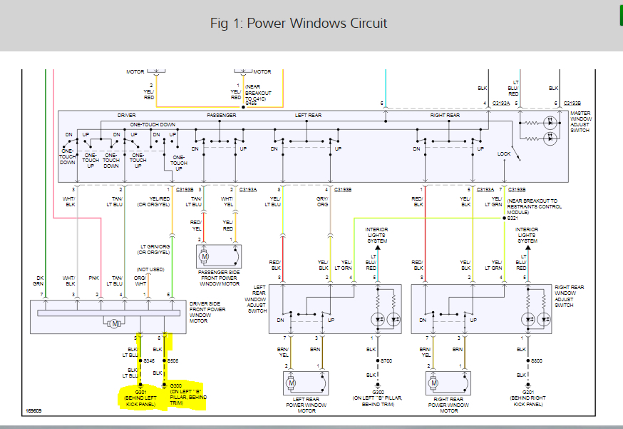

Driver side window and locks are not working
2003 LINCOLN NAVIGATOR
1 MILES
MENACE2019
But I can hear clicking from the VSM on passenger side. What can it be?
I've change switch (lock/unlock), window motor and nothing.
Jul 25, 2019 at 8:33 PM
SCGRANTURISMO
  • 4,897 POSTS

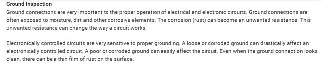

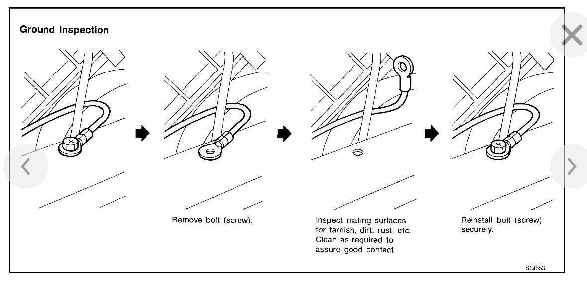

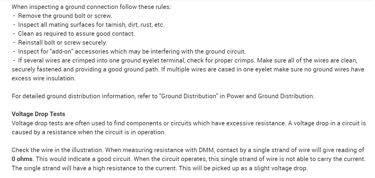

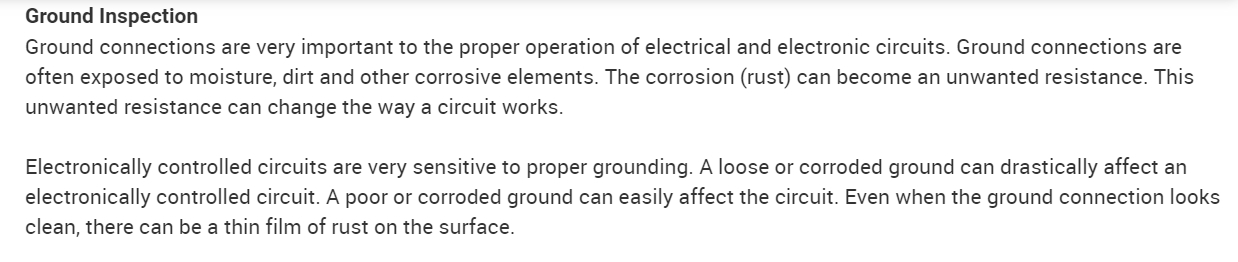

This could be a problem with Grounds #300, 301. They are on the left "B" pillar behind the trim and behind the left kick panel, respectively. In the diagrams down below I have included a wiring diagram of your vehicle's power window circuits and a guide on how to check grounds properly. Please check these grounds and get back to us with what you are able to find out.

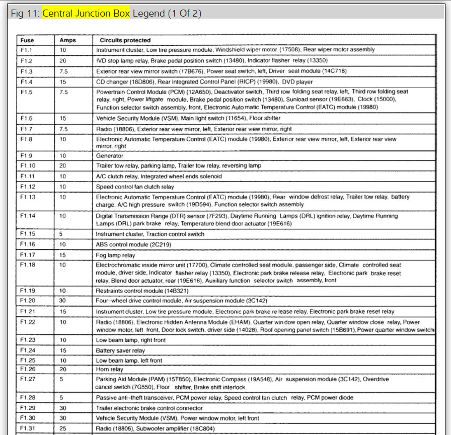

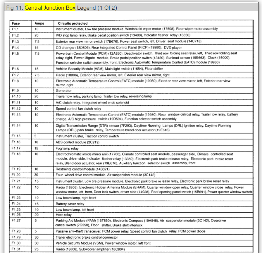

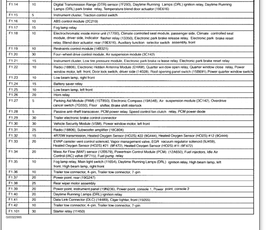

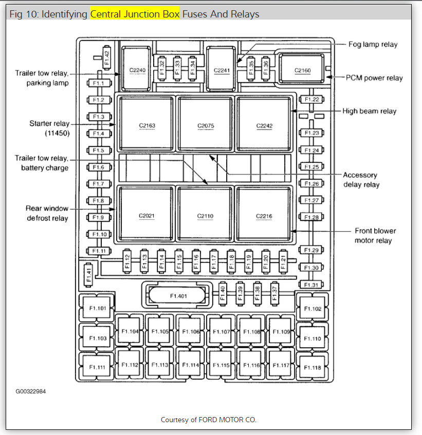

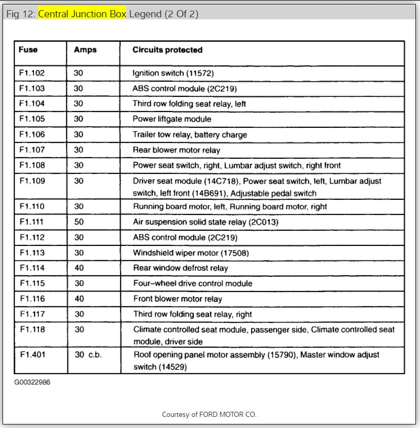

Lets check fuse #f1.30 it powers both systems. Here is a guide to help you test for power and the fuse locations as well:
