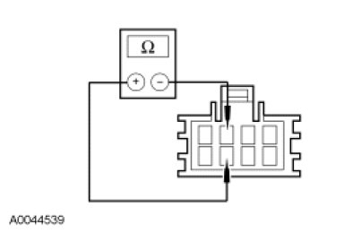

O1 CHECK THE VOLTAGE TO THE BLEND DOOR ACTUATOR
- Ignition OFF.
- Disconnect: Temperature Blend Door Actuator C2091.
- Ignition ON.
- Measure the voltage between ground and temperature blend door actuator C2091-7, circuit CBP20 (YE/VT), harness side.
pic 1
- Is the voltage greater than 10 volts?

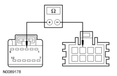

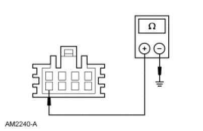

O2 CHECK CIRCUIT GD140 (BK/GN) FOR AN OPEN
- Ignition OFF.
- Measure the resistance between ground and temperature blend door actuator C2091-8, circuit GD140 (BK/GN), harness side.
pic 2
- Is the resistance less than 5 ohms?
Yes
GO to O3.
No
REPAIR circuit GD140 (BK/GN) for an open. TEST the system for normal operation.

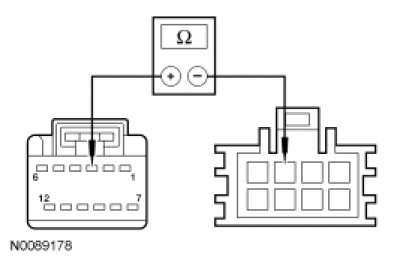

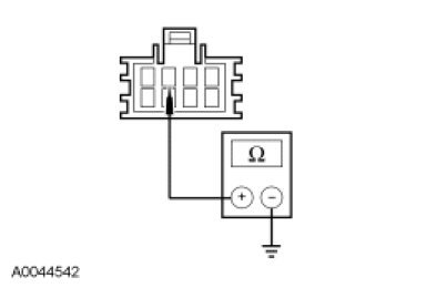

O3 CHECK THE TEMPERATURE CONTROL POTENTIOMETER TOTAL RESISTANCE
- Ignition OFF.
- Measure the resistance between temperature blend door actuator C2091-7, circuit CBP20 (YE/VT), harness side and C2091-3, circuit VH439 (GY/VT), harness side.
pic 3
- Is the resistance between 30 and 1,600 ohms?
Yes
GO to O6.
No
If the resistance is less than 30 ohms, GO to O4.
If the resistance is greater than 1,600 ohms, GO to O5.

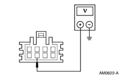

O4 CHECK CIRCUITS CBP20 (YE/VT) AND VH439 (GY/VT) FOR A SHORT TOGETHER
- Disconnect: Climate Control Assembly C294C.
pic 4
- Is the resistance greater than 10,000 ohms?

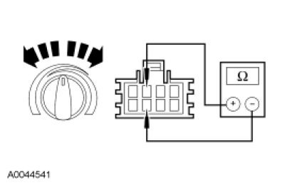

O6 CHECK THE TEMPERATURE CONTROL POTENTIOMETER OPERATION
- Measure the resistance between temperature blend door actuator C2091-7, circuit CBP20 (YE/VT), harness side and C2091-3, circuit CH439 (GY/VT), harness side while rotating the temperature control potentiometer from full WARM to full COOL.
pic 6
- Does the resistance vary between 30 and 1,600 ohms?
Yes
GO to O7.
No
INSTALL a new climate control assembly. TEST the system for normal operation.
