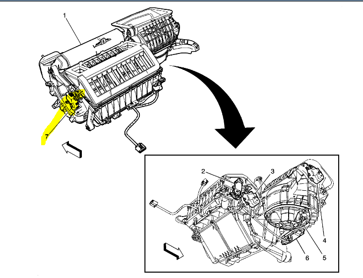

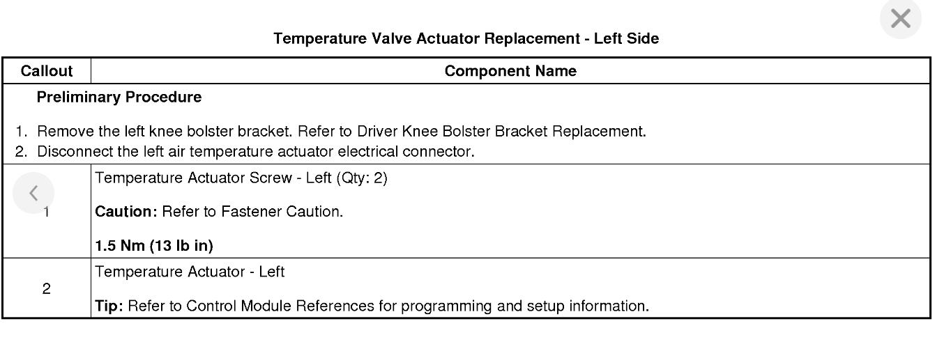

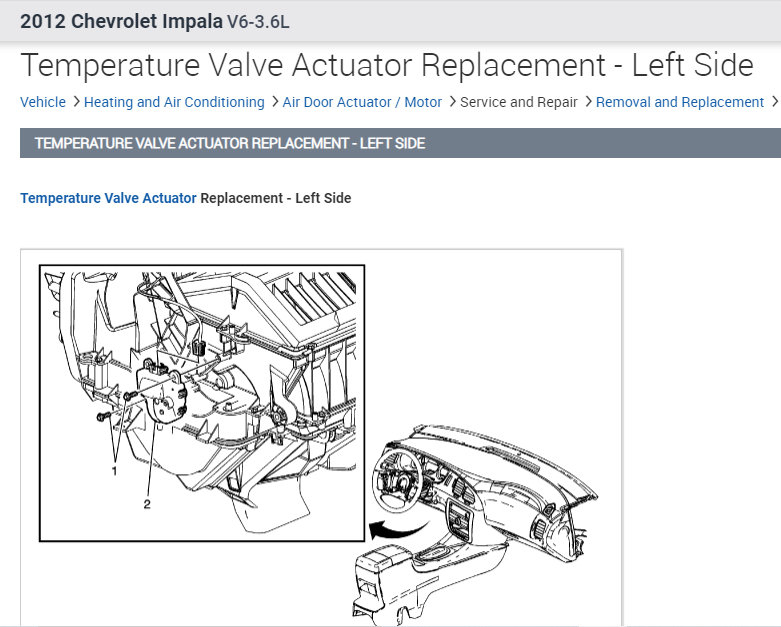

Moving it to a warmer setting it stops. But it clicks when the car is off. It looks like from your site the actuator is bad. I did not see a procedure for doing the driver side temperature actuator.
What is its location?

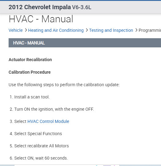

Is there a calibration procedure?
Thanks, Kevin
