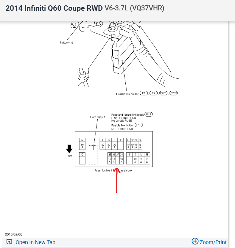

There is only one fuse that can cause the driver's side not to work which is the fuse # 37 15 amp in the fuse panel under the hood, please see if it is good or getting power.
This guide can help:

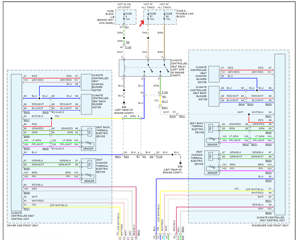

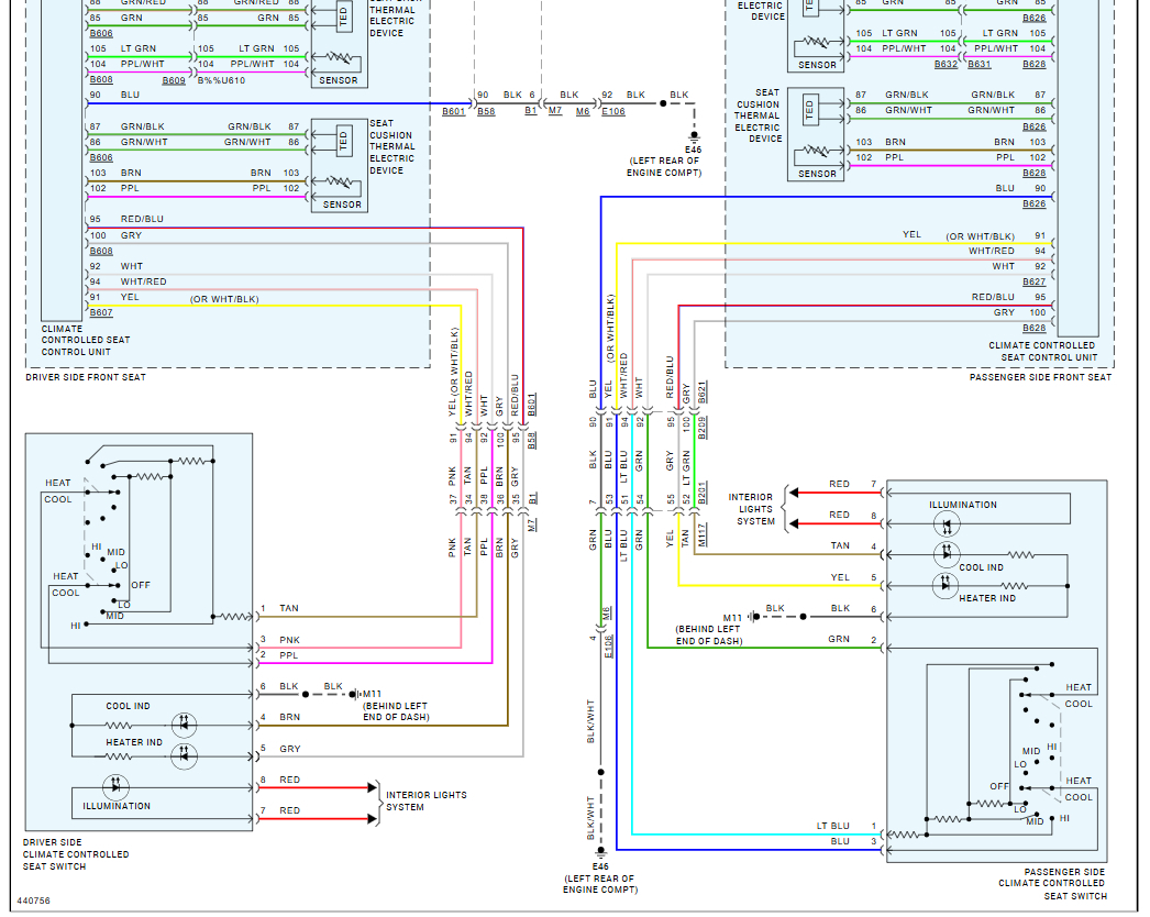

The fuse location is in the diagrams below. If the fuse has power and the fuse is good the next thing, I would try is the relay which one leg of the relay can be bad, or you can test for power at the yellow wire at the driver's seat for power. Here is the seat wiring diagrams so you can see how the system works. Check out the images (below). Please let us know what happens.
