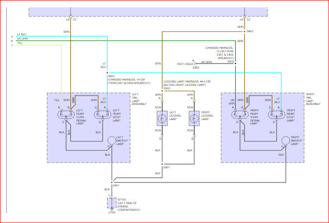

I have put new bulbs in it, checked the fuse which is fine, and the connection. Wondering if there could be something wrong with the wiring.

You might want to check the wiring harness (bulb socket) ground wire. Check to see if burnt/corroded/loose connection. I have attached a tutorial for you to view and a picture of the wiring diagram. Hope this helps and thanks for using 2CarPros.
