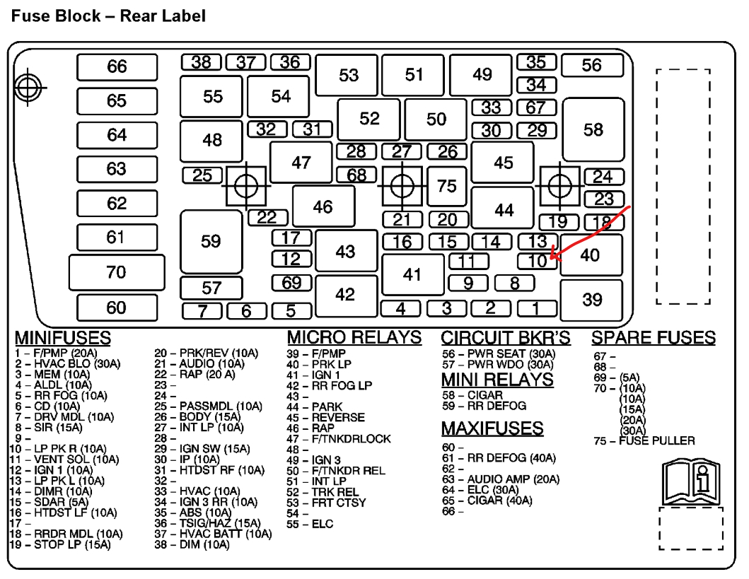

I’m working on my rear lights. The brake light works. The rear side marker light does not have any power. I think it is powered from the fuse box under the rear seat. Can you confirm? I also think the power wire is purple. Can you also confirm?

You are correct, it is powered by the purple wire and there is a fuse for it located in the rear fuse panel under the left rear of the seat. Please check the RH PARK fuse.
Here is a guide to help:
It is fuse #10 in the images below. Let us know how it goes.
