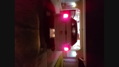

STUNTRIDER90
You can see in my short video the running lamp bulb on the driver's side is off. But on the passenger side it's on. My brake light, turn signal, and hazard lights still work. I have tried 3157 different dual filament bulbs. A week ago, the running light on the driver's side would work 50% of the time. Now it doesn't work at all. I've checked the fuses, I've checked for loose connections, corrosion on the contact points. I'm stuck and not sure what to do next.

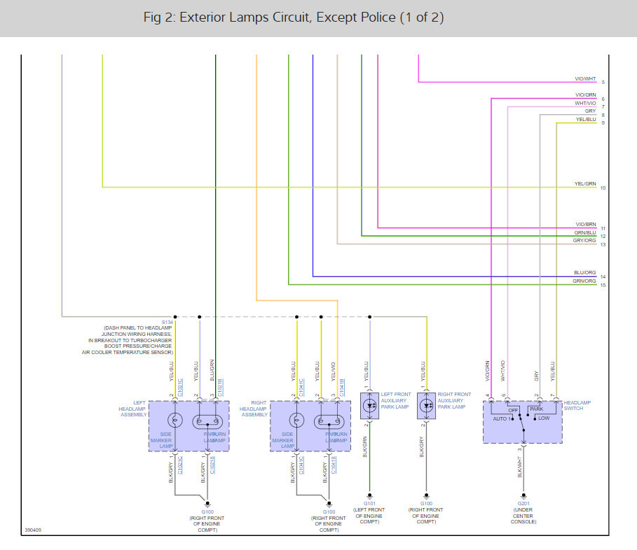

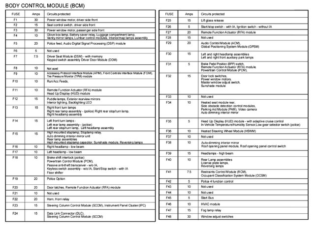

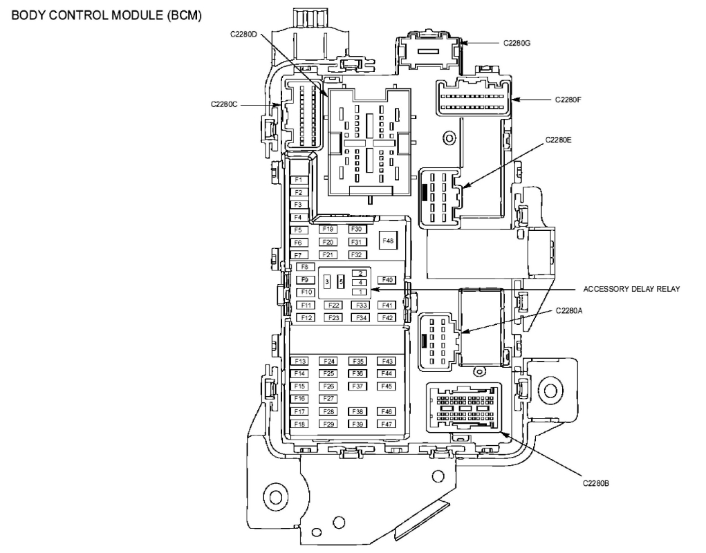

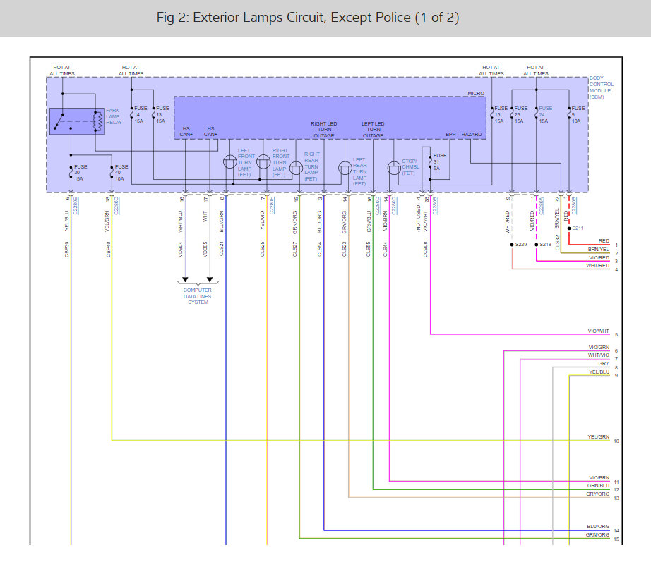

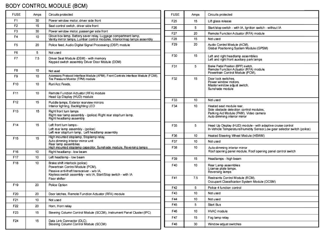

Hello, and thanks for the video. Let's start by checking the fuses on the BCM which controls the lights, #13, 14 and 15, also # 23, 24 and fuse 9. Here is a guide to help and I have included the taillight wiring diagram in the images below. Also, the BCM fuse panel location to help you with the test.
Sep 1, 2022 at 5:50 PM
STUNTRIDER90
I've already checked the BCM fuse panel, also checked the fuses under the hood since I have the 2013 Ford Police Interceptor Sedan 3.5L FWD Flex Fuel. My side marker light works in the left tail lamp. Could I tap power from there to run my running lights?

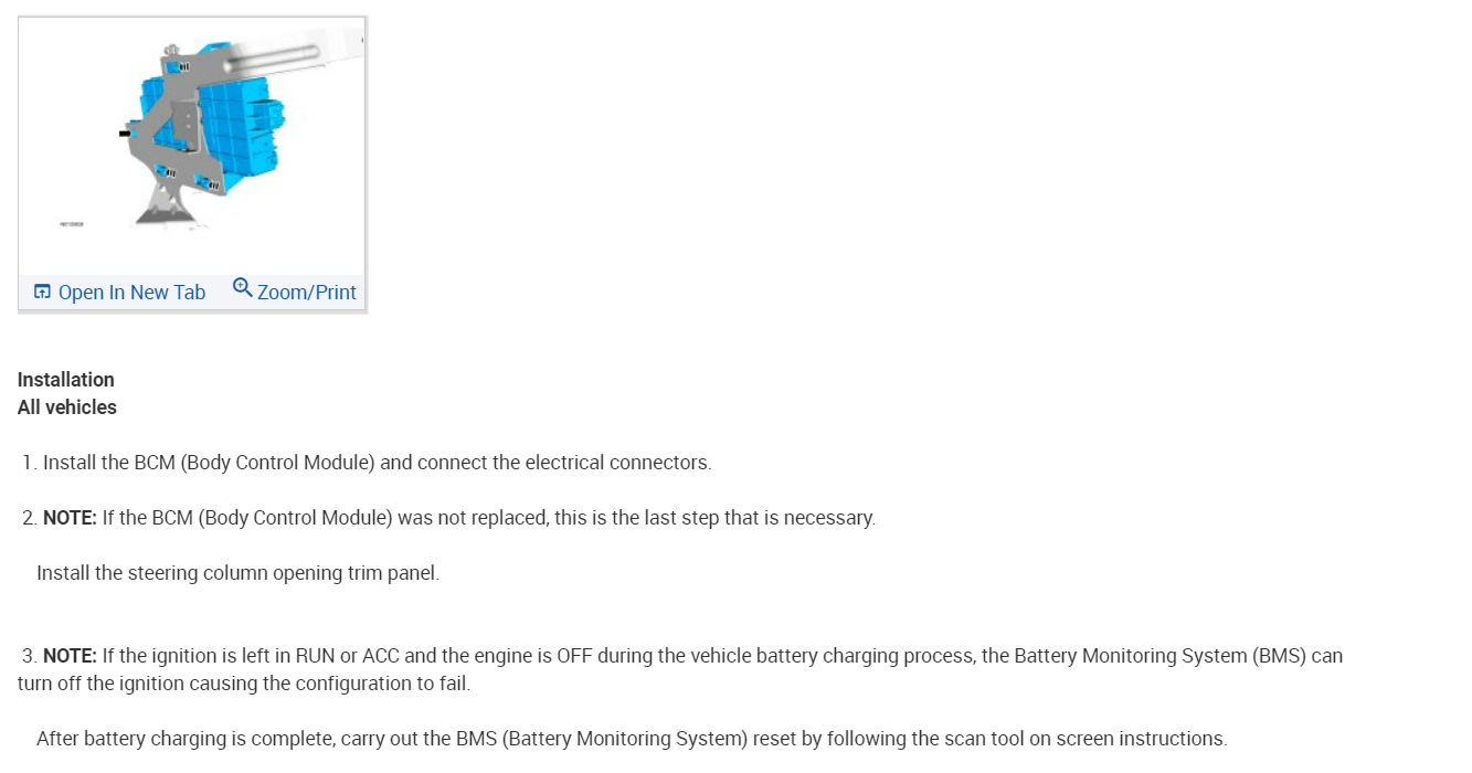

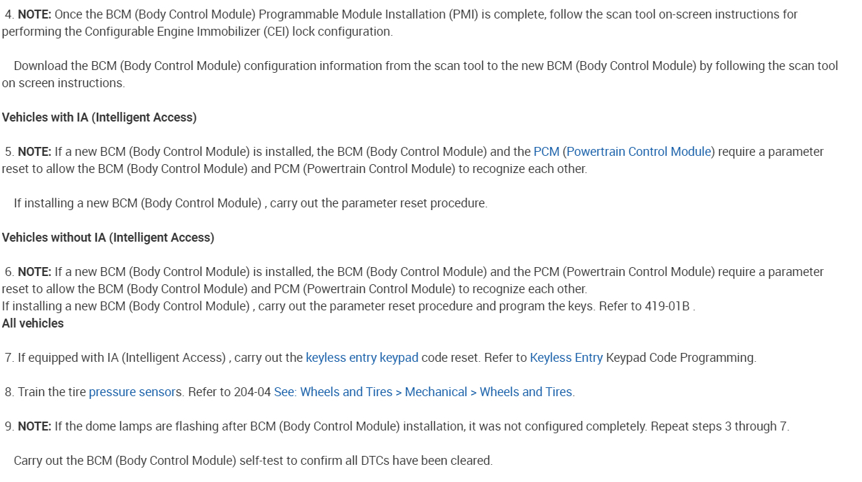

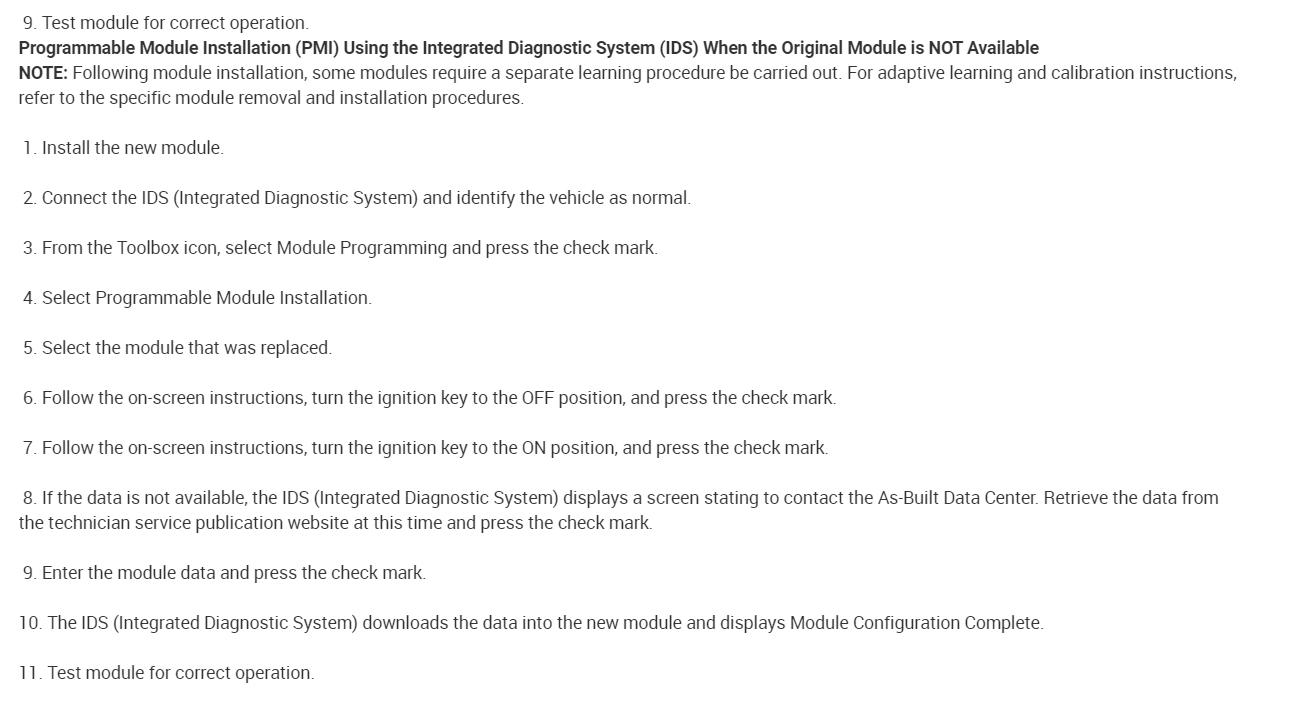

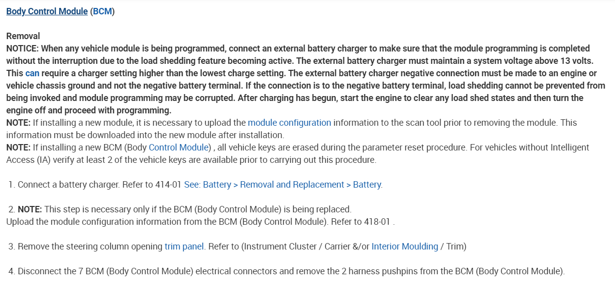

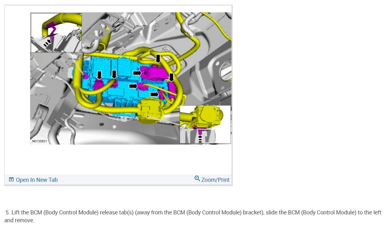

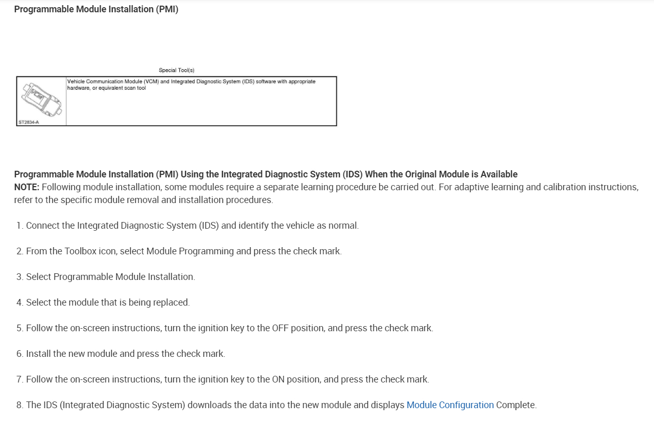

Here is how you can replace the BCM just in case you need it. Check out the diagrams (below). Please let us know what happens.
