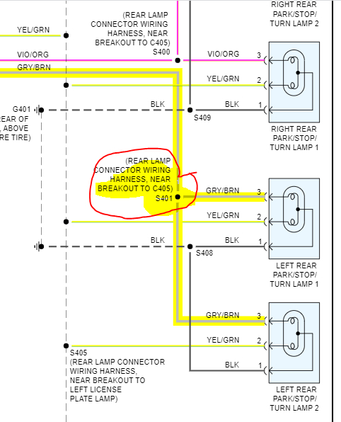

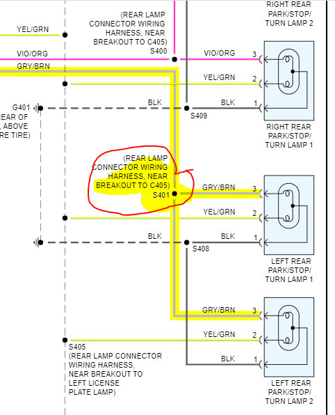

I looked through the wiring schematic and need you to check something. At the left rear light, you will find a gray wire with a brown tracer. That is the power supply for the signal and the brake light. Using a test light or multimeter, I need you to check if there is power to that wire.

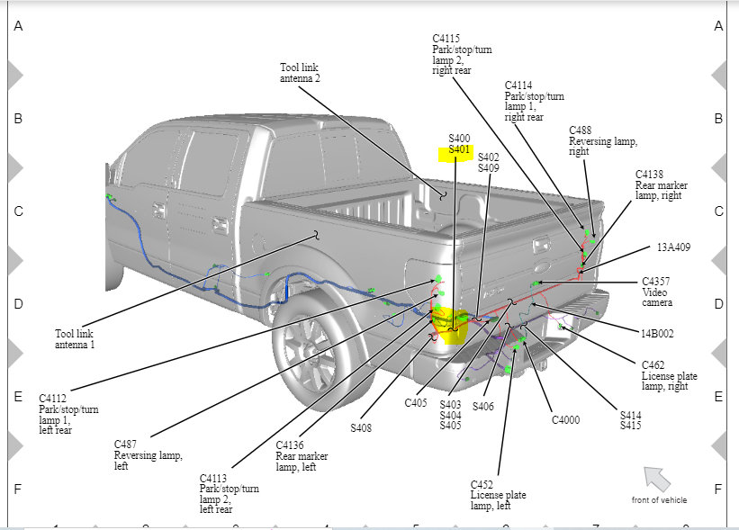

If there is no power, I need you to locate splice (S401) see pic 2 for location. I need you to check to make sure it isn't damaged, corroded, or simply disconnected.
