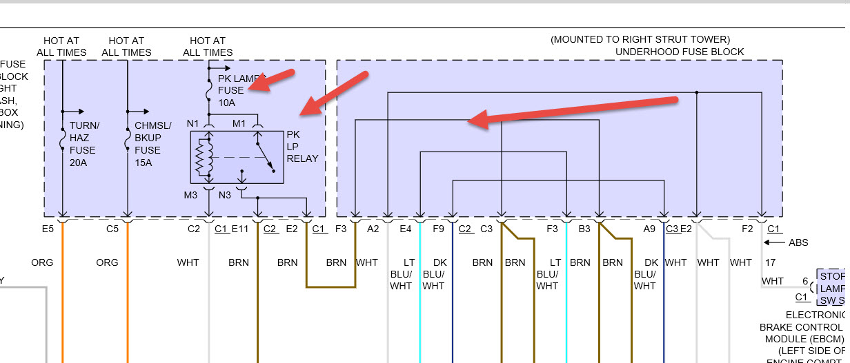

I put a new bulb in, another bulb after that and the amber running light above the fog lamp does not work, but the turn signal does.
May 12, 2016 at 1:26 PM
HMAC300
CERTIFIED EXPERT
48,601 POSTS
if right side works, but not left then it may be either a broken wire leading to it or a bad ground or it could be inside the fuse box where it is getting no power the ground is on the upper tie bar near left hand head lamp so check that as well.
