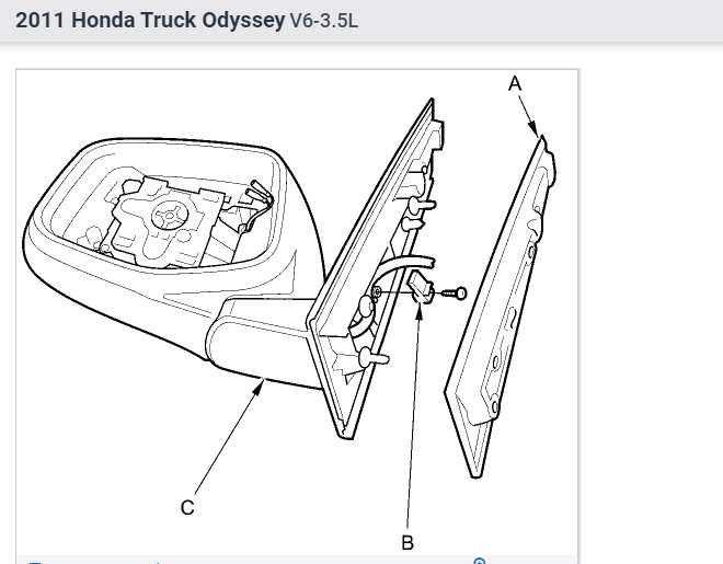

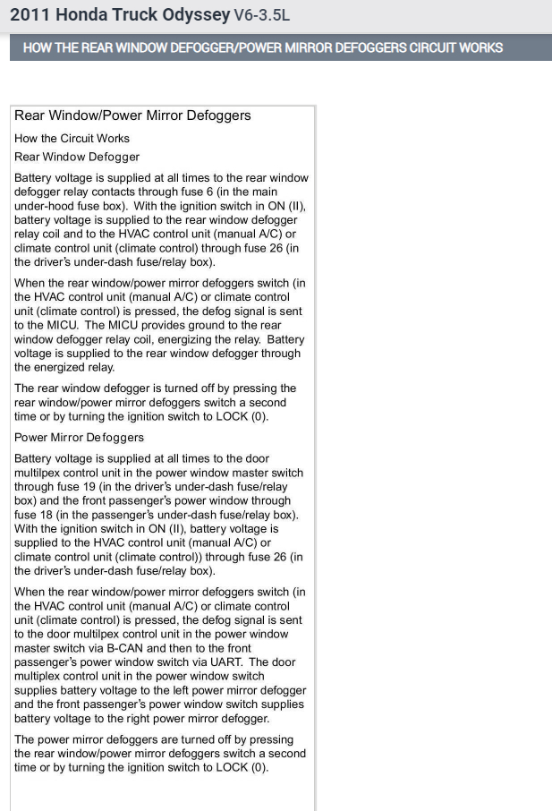

Any vehicle that has mirror defrost will be for both the driver and passenger side. And yes, your vehicle has both mirrors that are heated.
So, the non-functioning defrost is likely due to a faulty heating element on the driver side mirror.
Does the power function of the mirror work properly?
If it does, then you know it is getting power.
Another possibility is a broken wire, likely inside the mirror.
In order to find that you will have to remove the mirror and first inspect the wires for any corrosion or break.
If that is good, then the fix would be to replace the mirror assembly.

So it is likely the faulty heating element inside the mirror.
