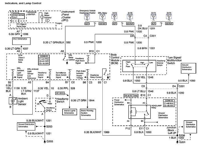

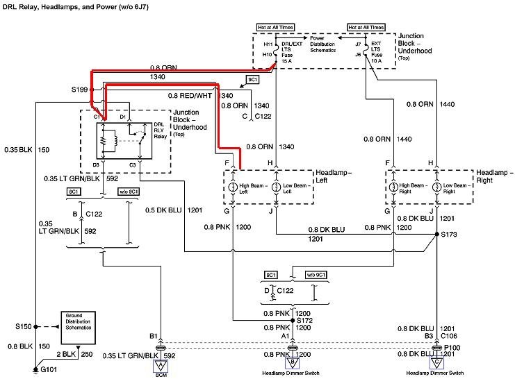

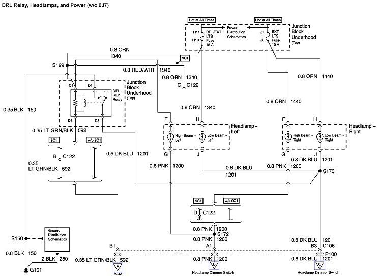

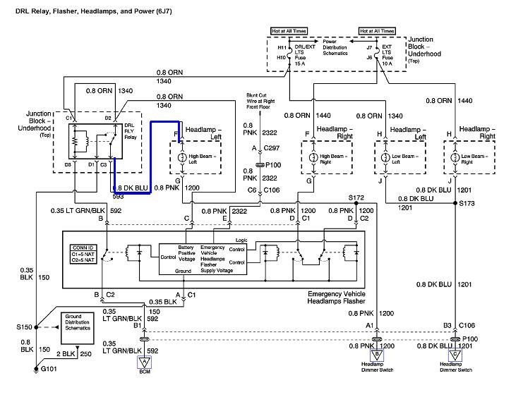

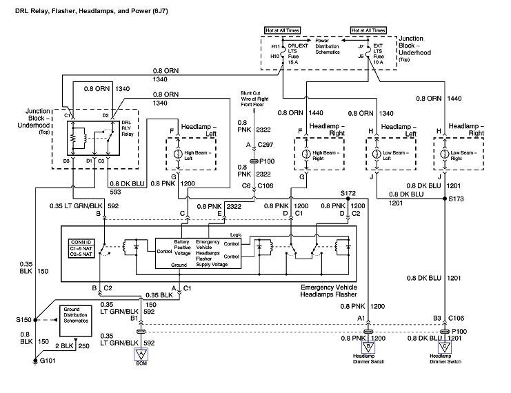

For a really long time, the insane engineers at GM have been well-known to be unable to design a common sense lighting circuit, and these are perfect examples. There's two different versions, but all three of these are listed as "with daytime running lamps". There's no version listed as not having that "feature". The fourth and fifth diagrams are just copies of the first two, but I outlined the parts of the circuits of what looks like are the only parts are where the break can be.
