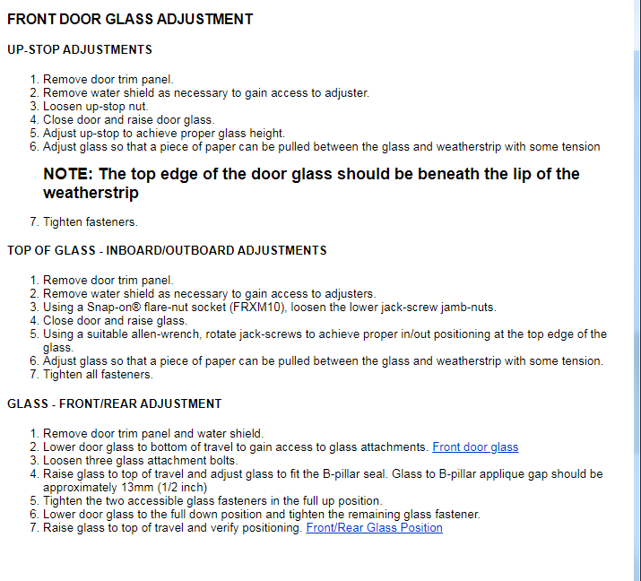

I just replaced the driver side glass window, but it's not properly aligned, when closed it leaves a gap at the top near the door center post.
Any suggestion is much appreciated.

I assume you have a two door with the floating glass? If so this is pretty common on these doors. I attached the adjustments for the glass. Let me know if you have questions but if you remove the door panel you should see torx screws on the regulator, which are the adjustment screws.

Hi KaseKenny1,
Thanks for this advice and I'm sorry for this delayed reply.
As per your help, I was able to align the glass window on my Neon.
Again, thanks a lot!
