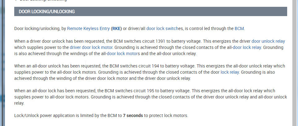

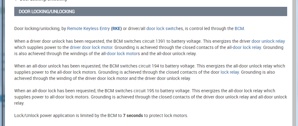

Sounds like the actuator is locking up or the lock cylinder is dirty and not turning freely. However, due to the fact that the power locks will not work either points to the actuator.

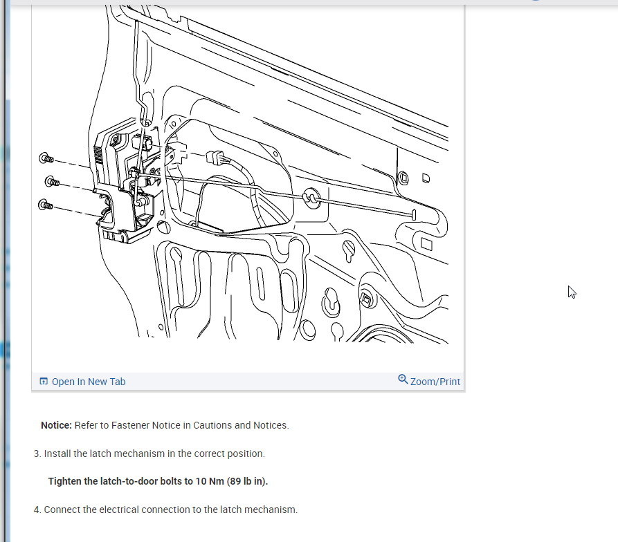

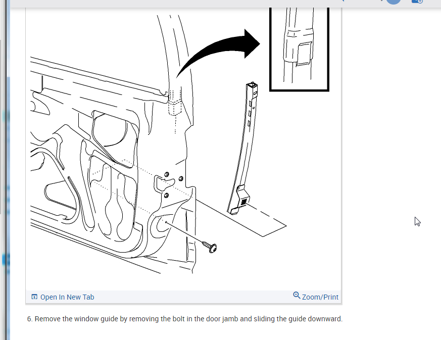

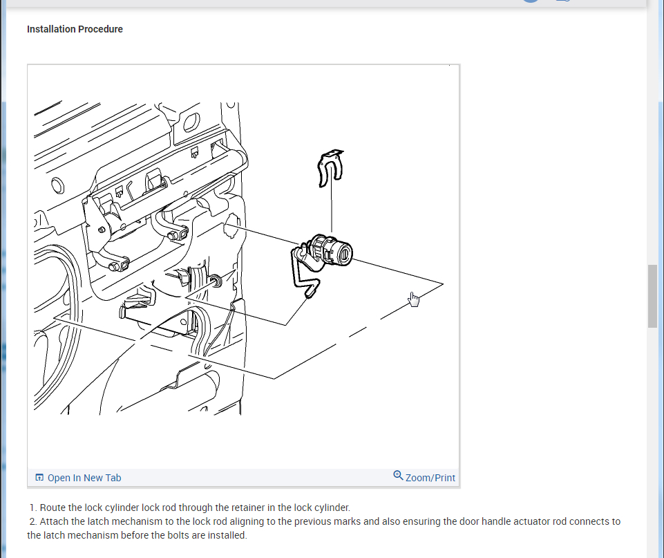

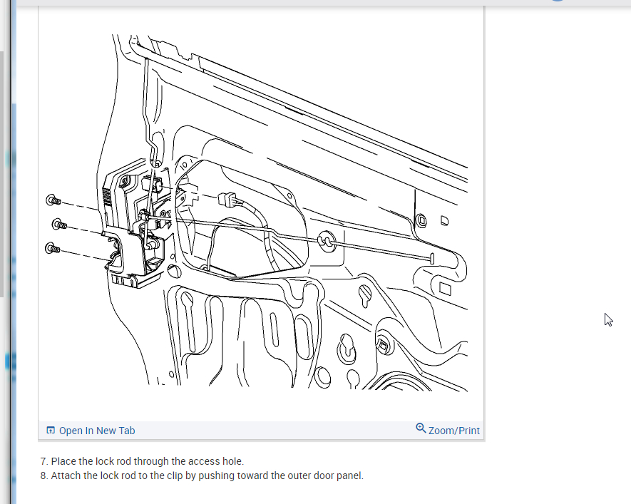

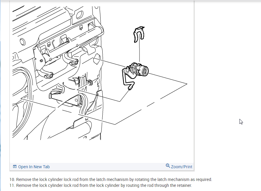

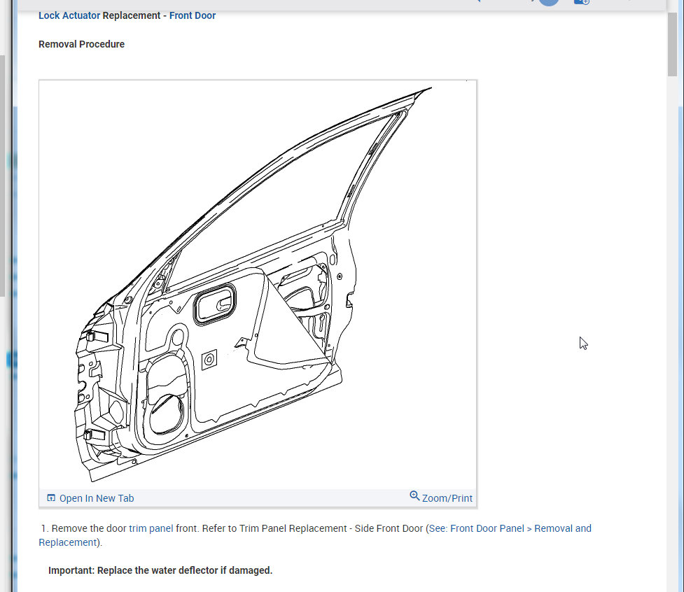

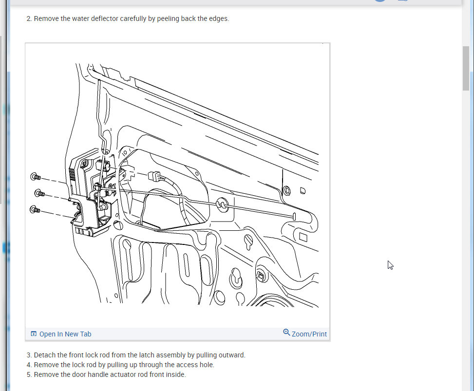

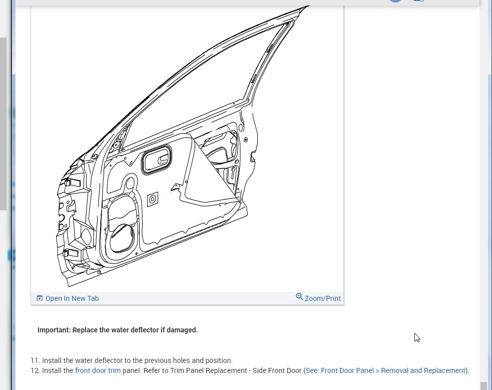

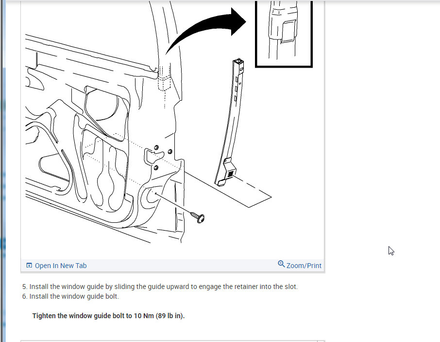

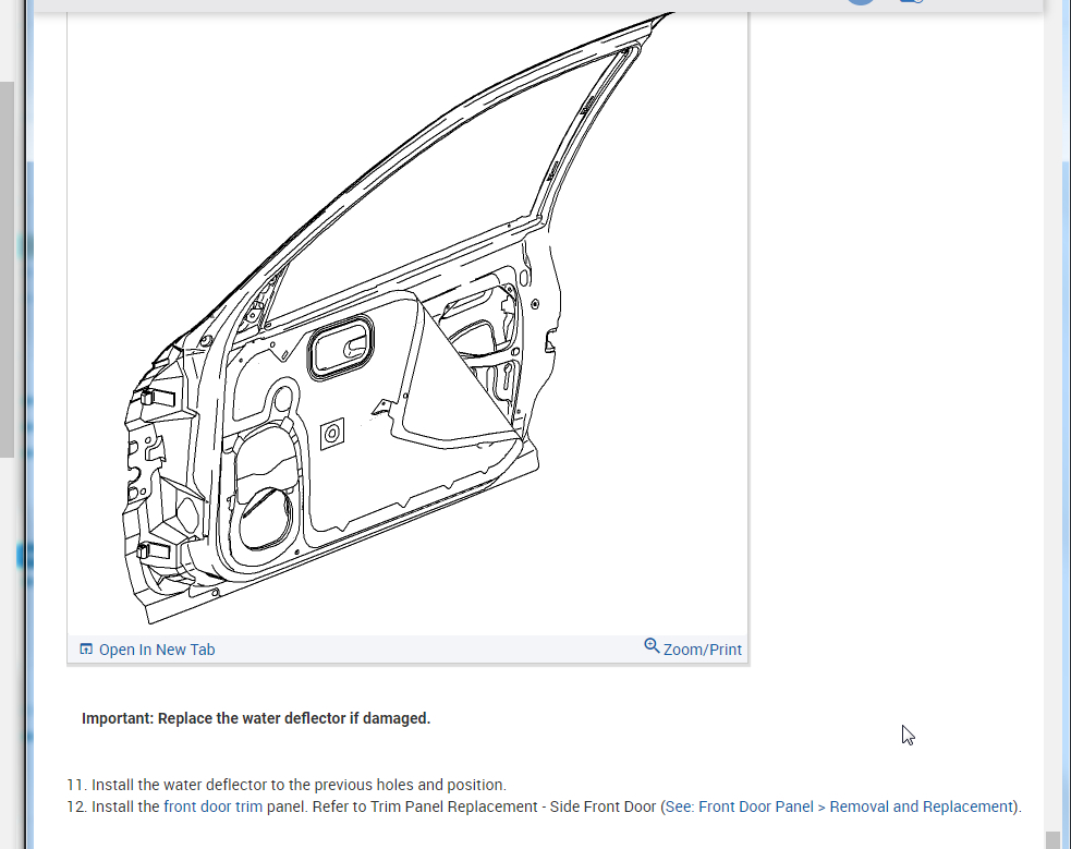

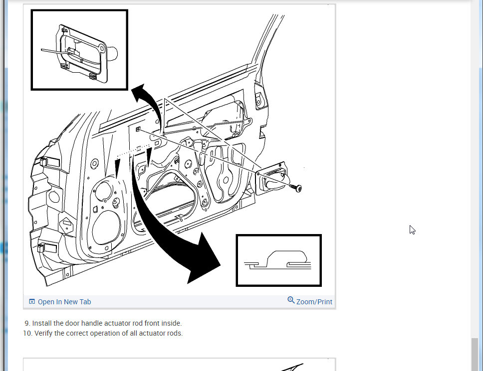

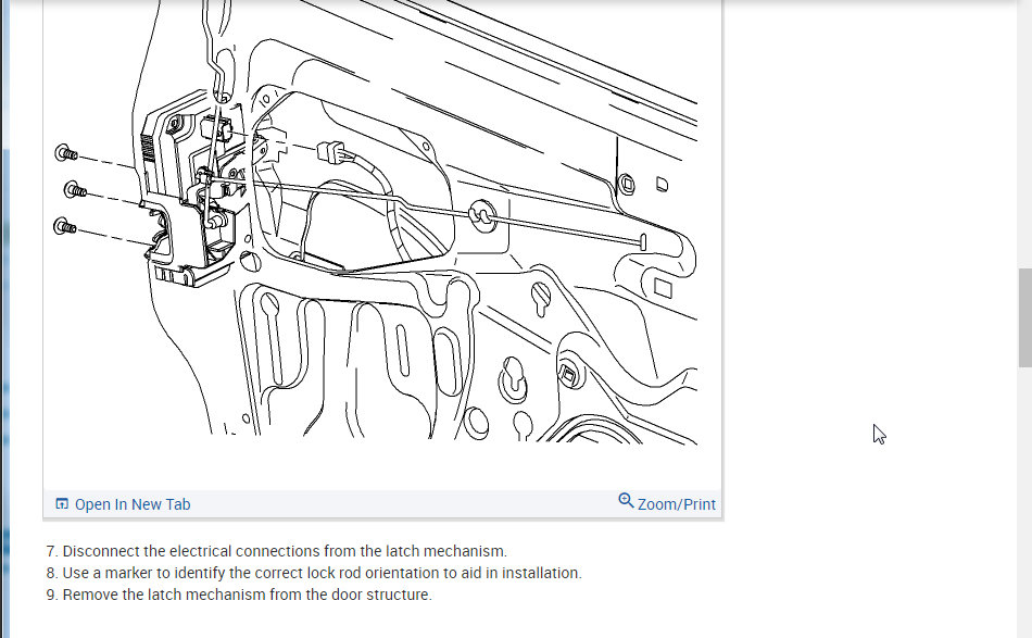

Below is the process from the manual to replace the actuator. More than likely I would remove the panel and just operate the locks to see what is going on inside the door.
