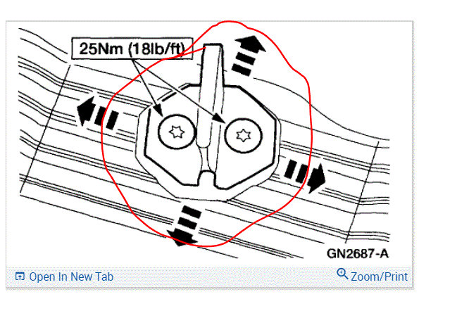

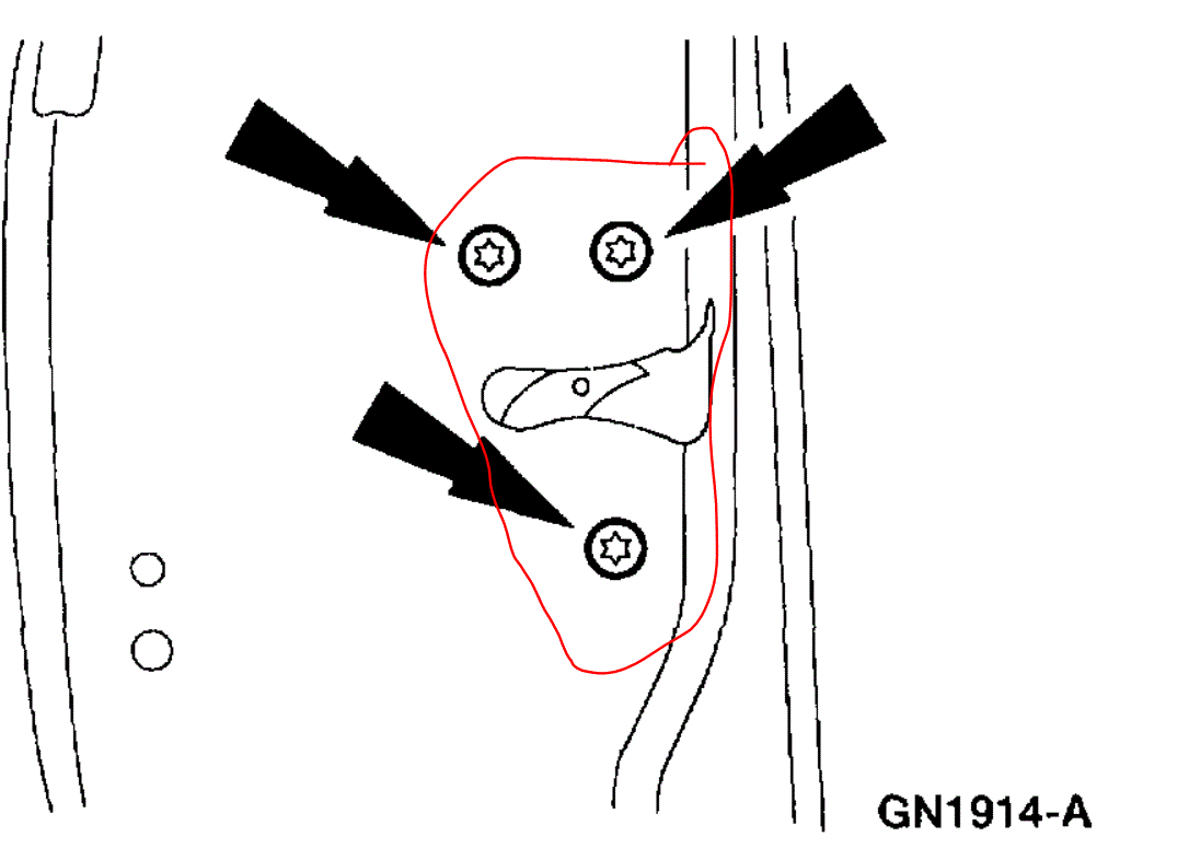

Chances are either the latch assembly is loose or the striker on the door frame is loose or in need of adjustment.
I attached two pics below. Start by making sure they are tight. If they are, loosen the striker (pic 2) inward a little at a time until the door can't be moved.
Let me know if this helps or if you have other questions. If you are unable to get it set properly, the latch itself is likely worn.

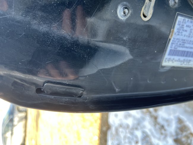

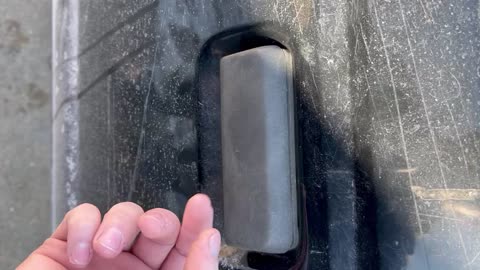

So, I noticed the retaining clip for the lock cylinder was pushed out a little bit. Not sure if it was replaced at some point, but I pushed it the rest of the way in, and it stopped the door from slightly opening. However, the door handle is still pretty loose. Not too big of an issue, but if you have a fix for that as well, I’d appreciate it greatly.
I added a few pictures I had taken earlier. Along with a few videos. (One if driver side: sloppy, and one of passenger side: not sloppy) Not entirely certain if that retaining clip is truly what caused it. However, I tried multiple times to re-create the issue and could not get it to happen again.

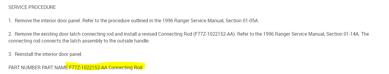

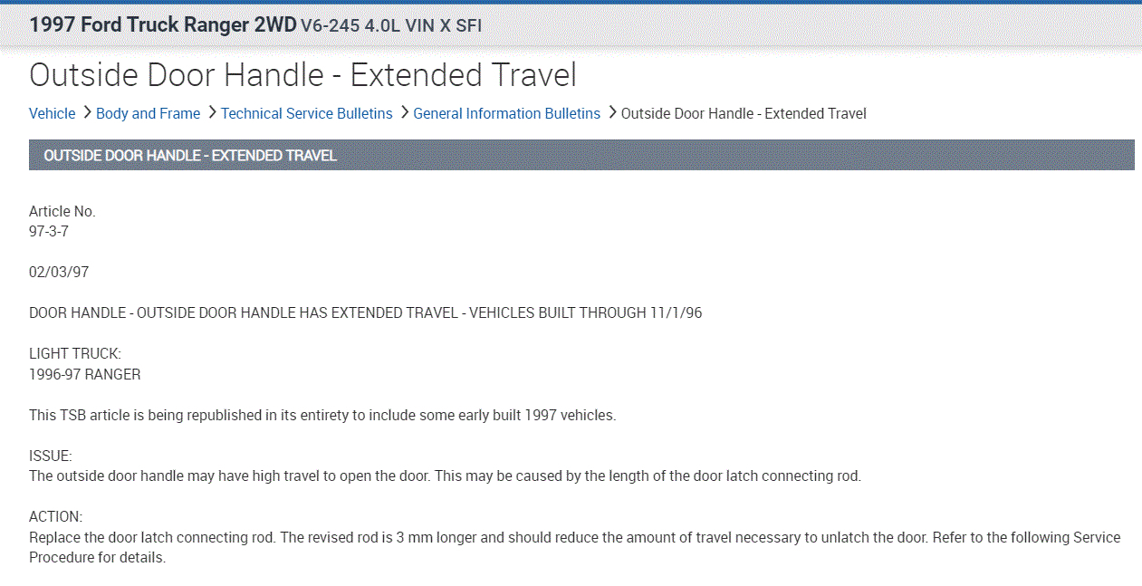

Is it loose as in excessive play or does it seem more like an extended travel issue? There were issues with the original handle latch rod being too long from the factory.
I attached a technical service bulletin below for your review.
If you feel it is something other, the best thing to do would be to remove the door panel and check to see if the retainers are loose where it mounts.
