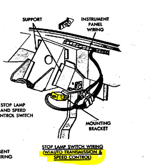

Okay, I need you to check for power at the brake light switch. It is located under the dash on the top of the brake pedal.
Also, I need to know if you have cruise control and I realize it's a w100, but my manual is showing a truck and Ramcharger under the w100.
I attached a pic below of the location of the switch. Here is a link you may find helpful:
Also, if you can, check for power at the tail lamp sockets. You will need a helper to press the brake pedal.
