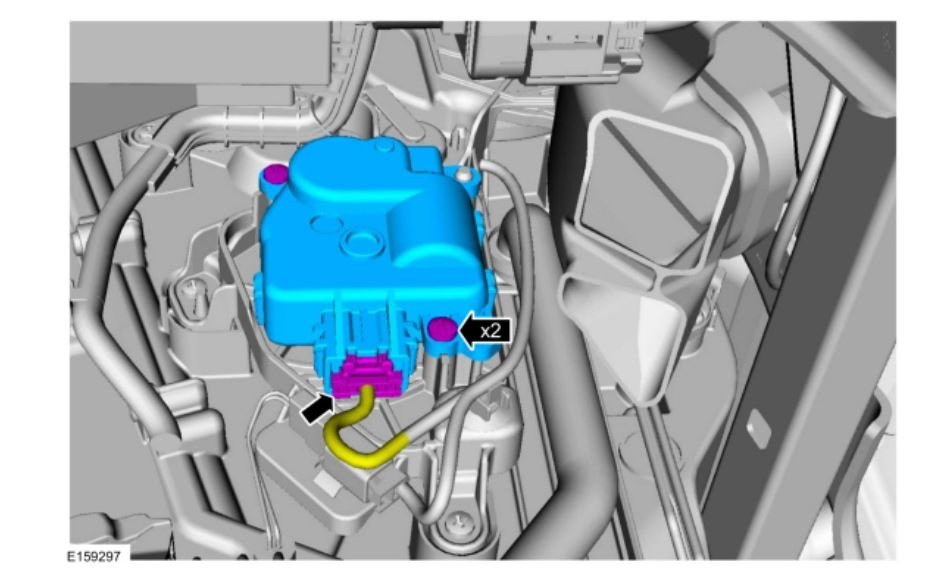

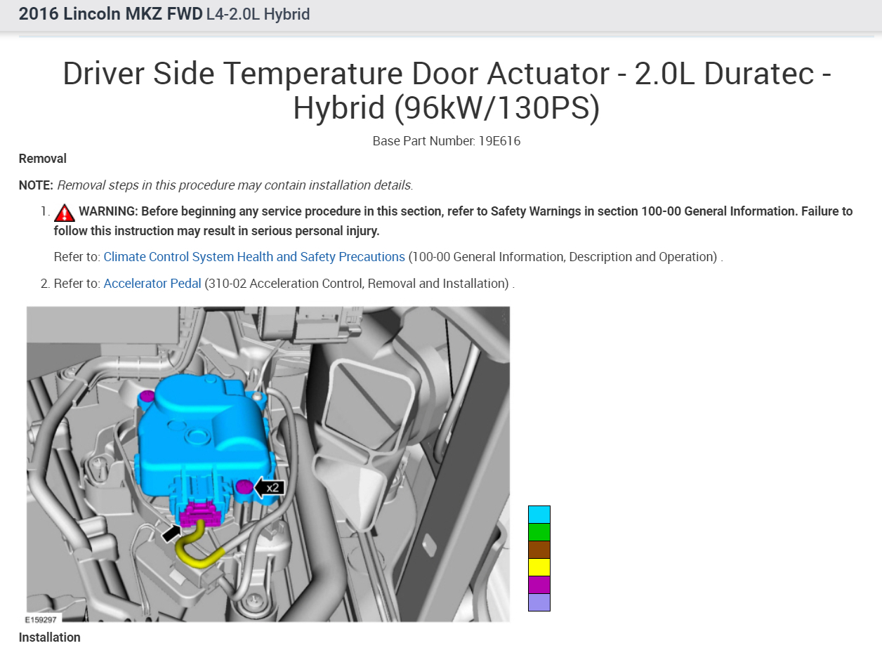

Sounds like the actuator is not working.

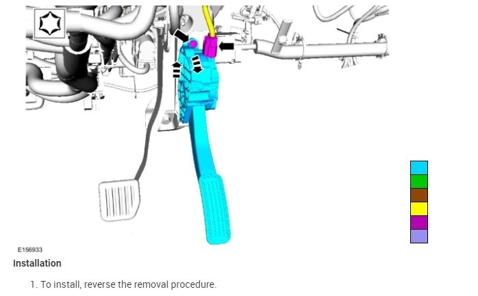

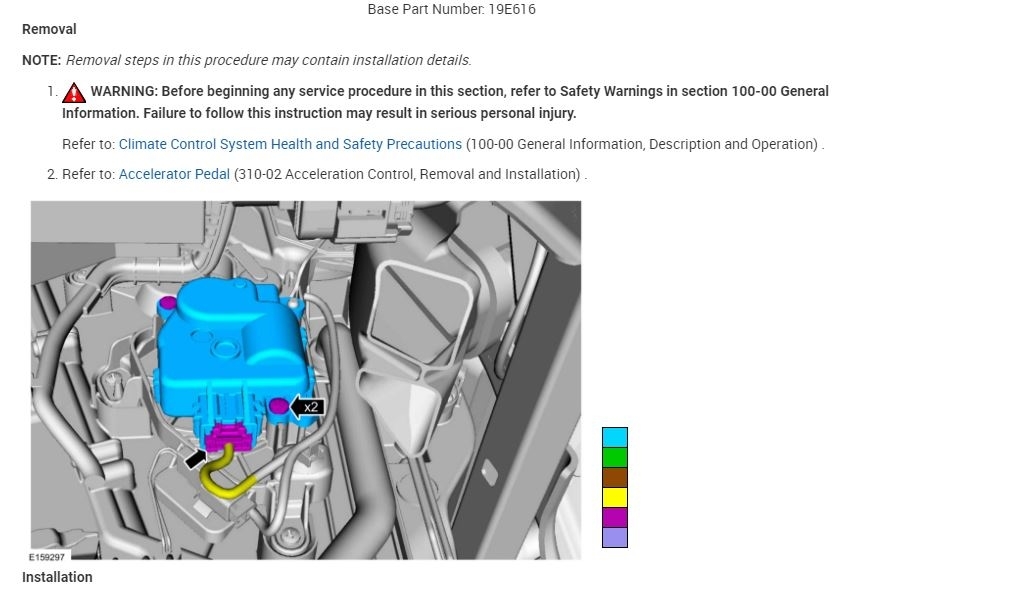

I attached the procedure with pictures below for you to view.

this procedure is not clear how to replace that actuator part. I have 2015 MKZ hybrid, can you tell my step by step how to get to that part (with better pics) that would be more help full? thanks....

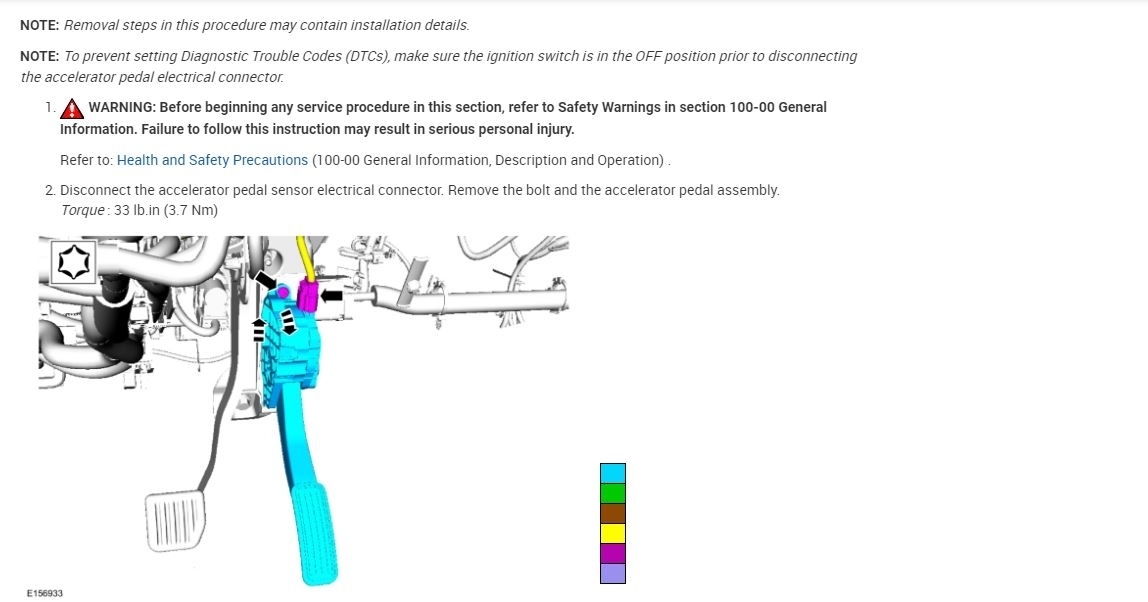

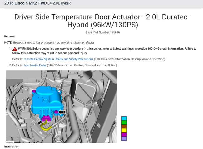

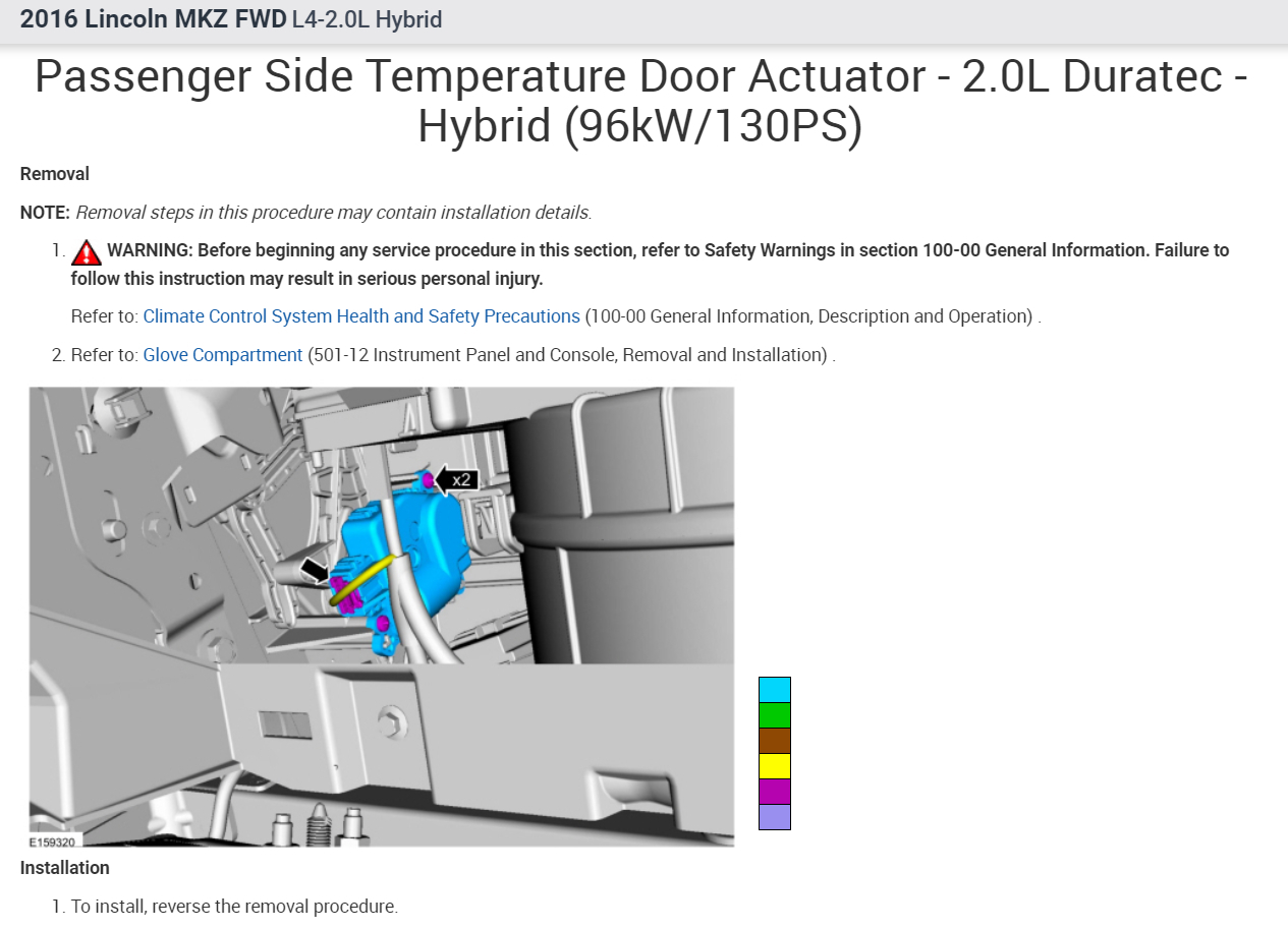

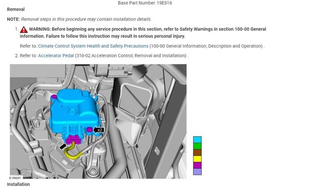

The procedure is the same for the Hybrid and regular vehicles. I found more diagrams for you. Check out the diagrams (below). Please let us know what happens.
