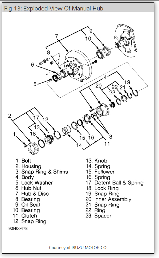

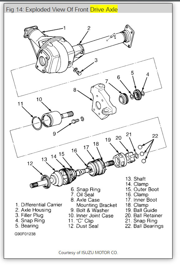

How do I replace the driver side front axle?
Nov 24, 2018 at 6:10 AM
CERTIFIED EXPERT
53,854 POSTS
Here are diagrams to help you see how then front axle comes apart. Check out the diagrams (below). Please let us know if you need anything else to get the problem fixed.
