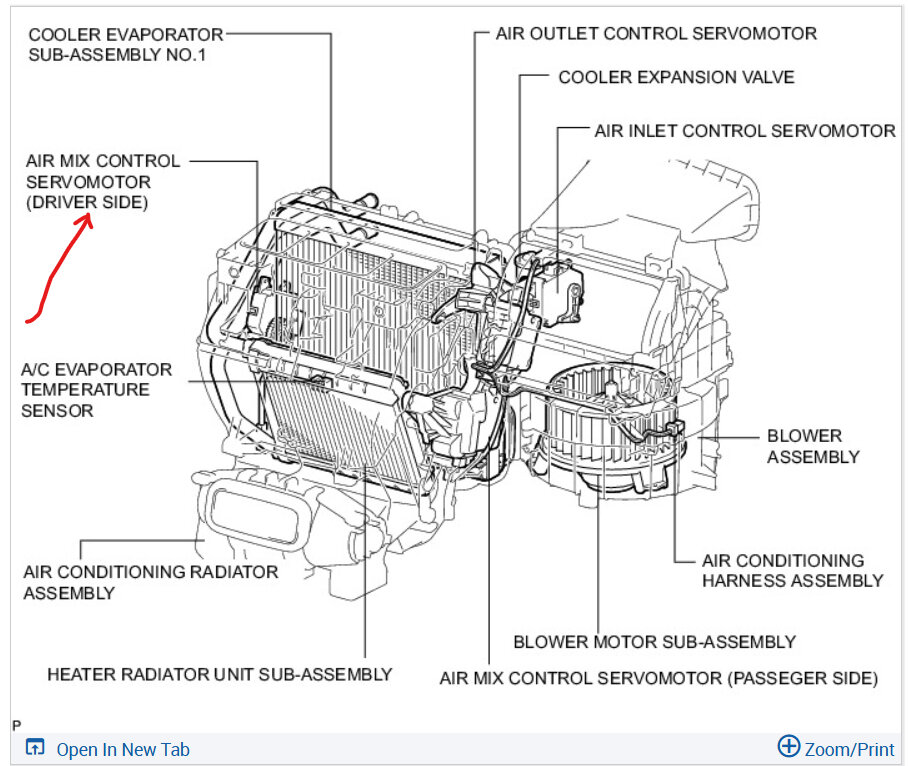

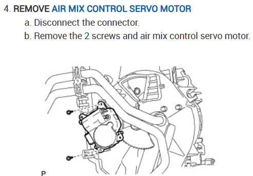

It looks like the driver's side blend door actuator is on the left side of the dash. Remove the old unit and plug the new one in, adjust the HVAC to full cold, the actuator will move to that position. Then work the vent door to full cold and mount the actuator and you are all set. You recalibrate the system if needed by pressing and holding "AUTO" and "Recirculation" buttons for 5-10 seconds. Check out the images (below). Please upload pictures or videos in your response.

Can you upload images for what you are talking about? The actuator only goes on one way.

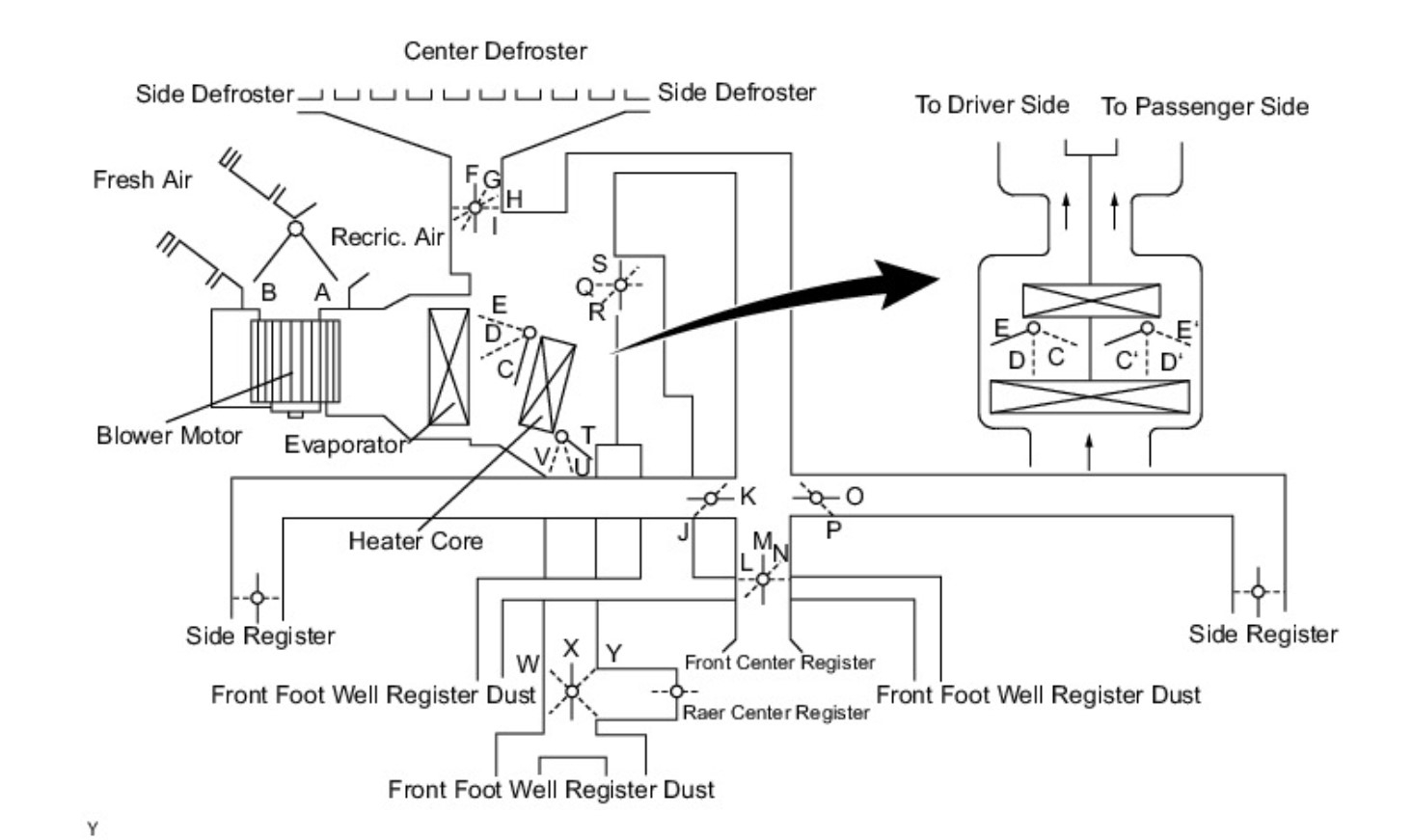

So you move the blend door lock to lock and no cold air, just normal then hot. It seems like something is wrong inside the HVAC plenum like part of the blend door is broken. There is only one evaporator core so if one side is cold so should be the other if the doors are working correctly, here is the actuator in question so we can be on the same page. Also, can you hear the door contact both stops, hot and then cold? Check out the images (below).

The diagram is accurate, that is what I see.
Yes, I can hear the door make contact when moving all the way from one stop to the other. Moves freely.

I don't think there is, you can look at the diagram in my first post to see.

Ken has it correct there are a total of 4 actuators. one controls the recirculate door (flashing recirc lite means that there is an issue with the actuator) Then you have the mode door, that selects floor, dash or defrost air flow. Then last are the left and right side blend doors. In operation they simply direct the air through either the heater core or through the AC core. As you get cold air on the other side and moving the door does get you heat and ambient air on the opposite it sounds like an airflow issue through the evaporator core. What I would try is to pull the cabin air filter out and use an inspection camera to go into the HVAC box and look at the core itself. The air goes through the AC core first so see if something got in there and blocked the core. Then use it to go down into the case through one of the vents and check that side to be sure the door is moving all the way to the AC position. There are seals on the doors and one may have come loose so the door isn't going fully into cold. I would say to pull the blower motor but that is a real can of worms because you have to remove the entire case.
