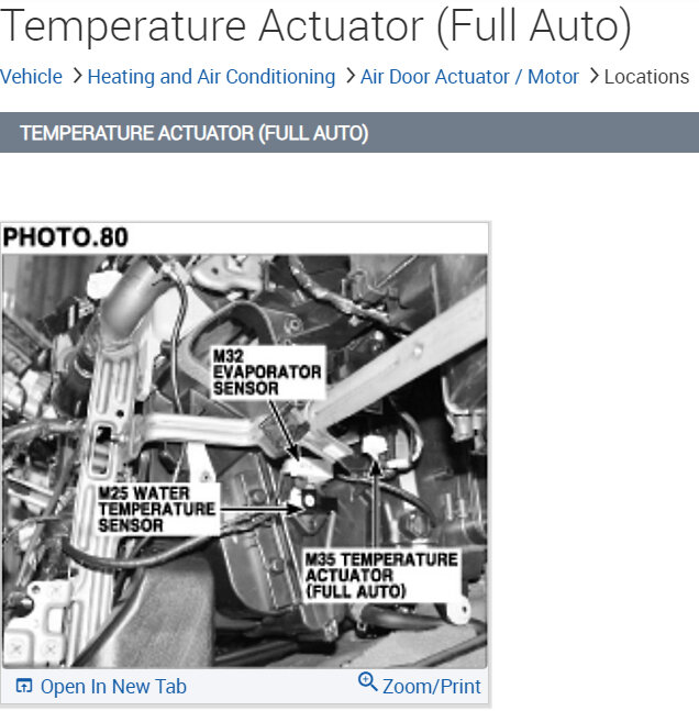

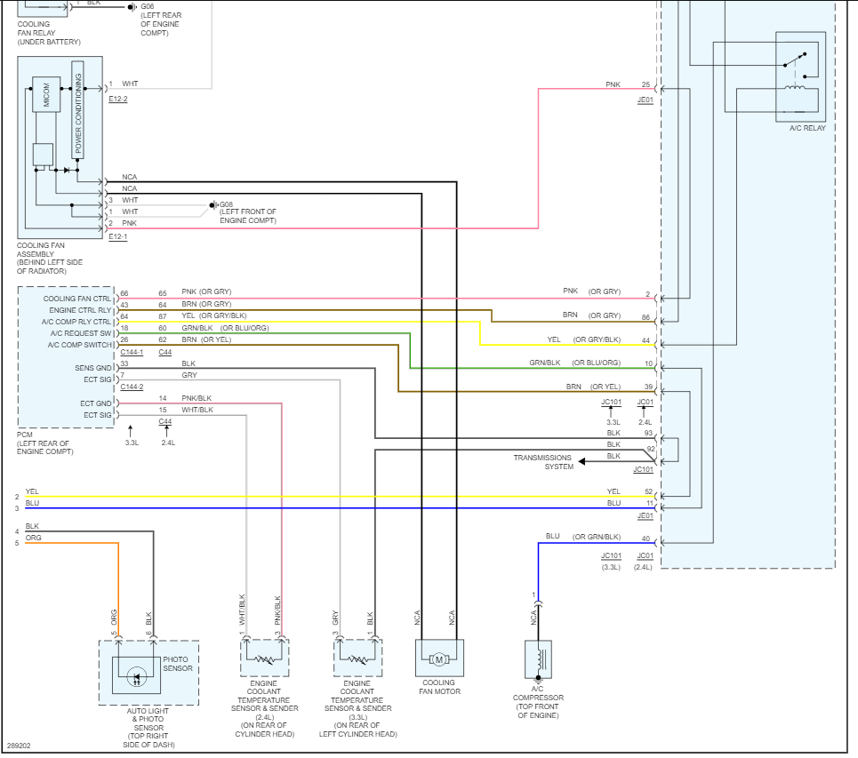

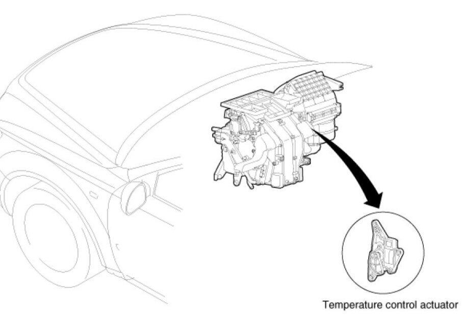

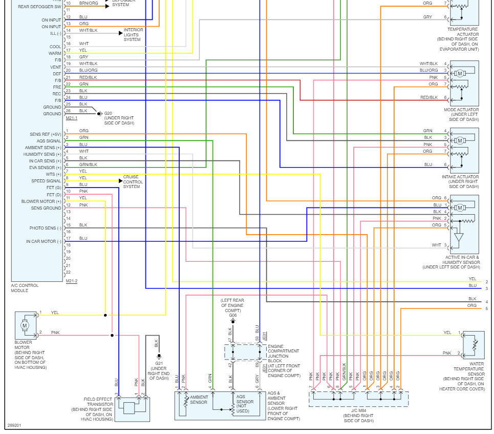

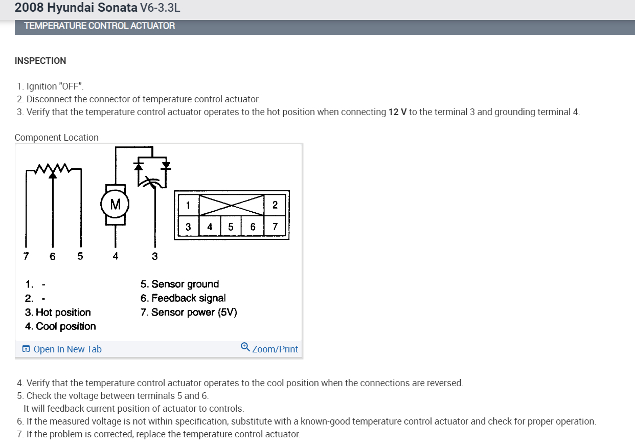

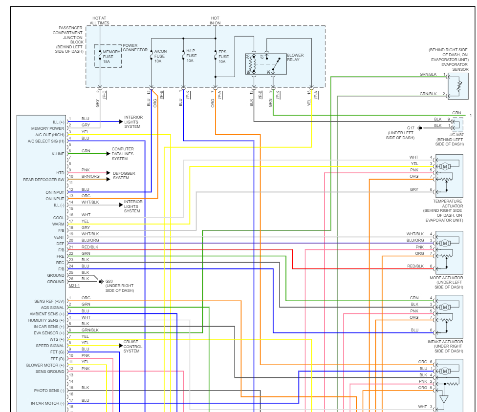

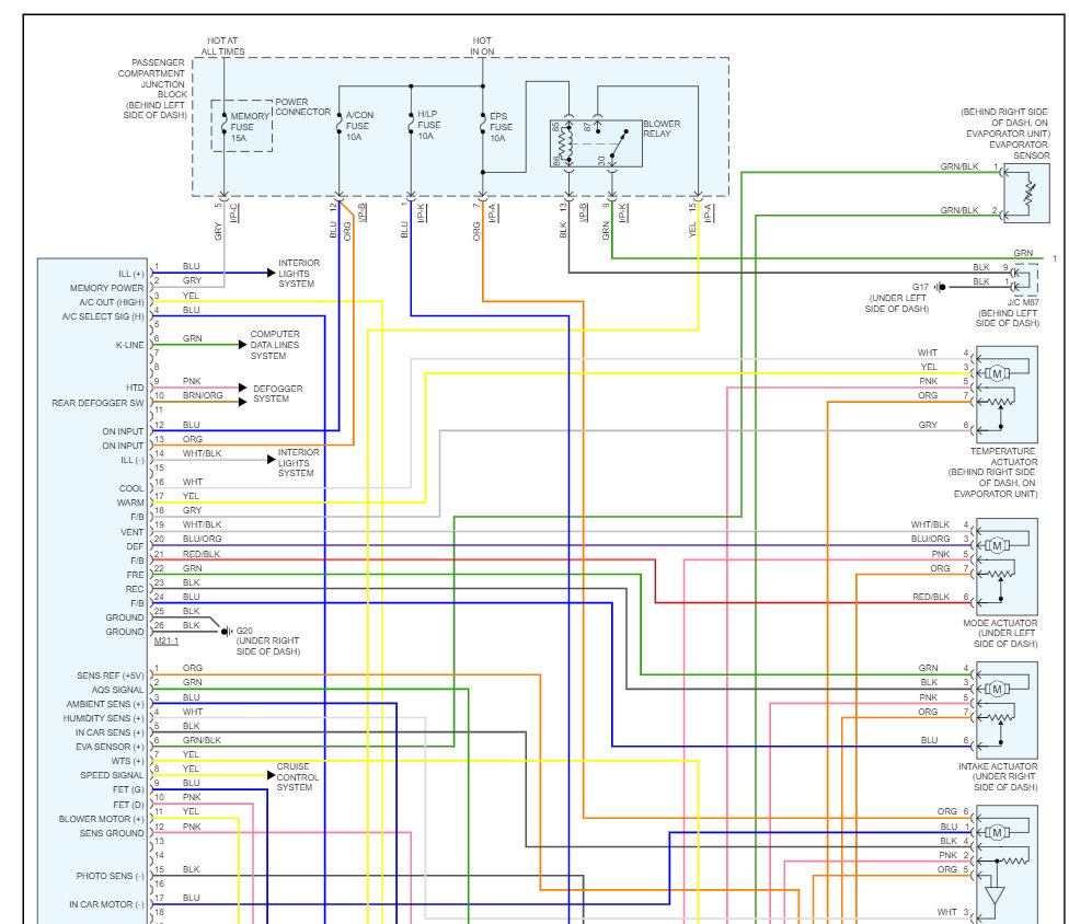

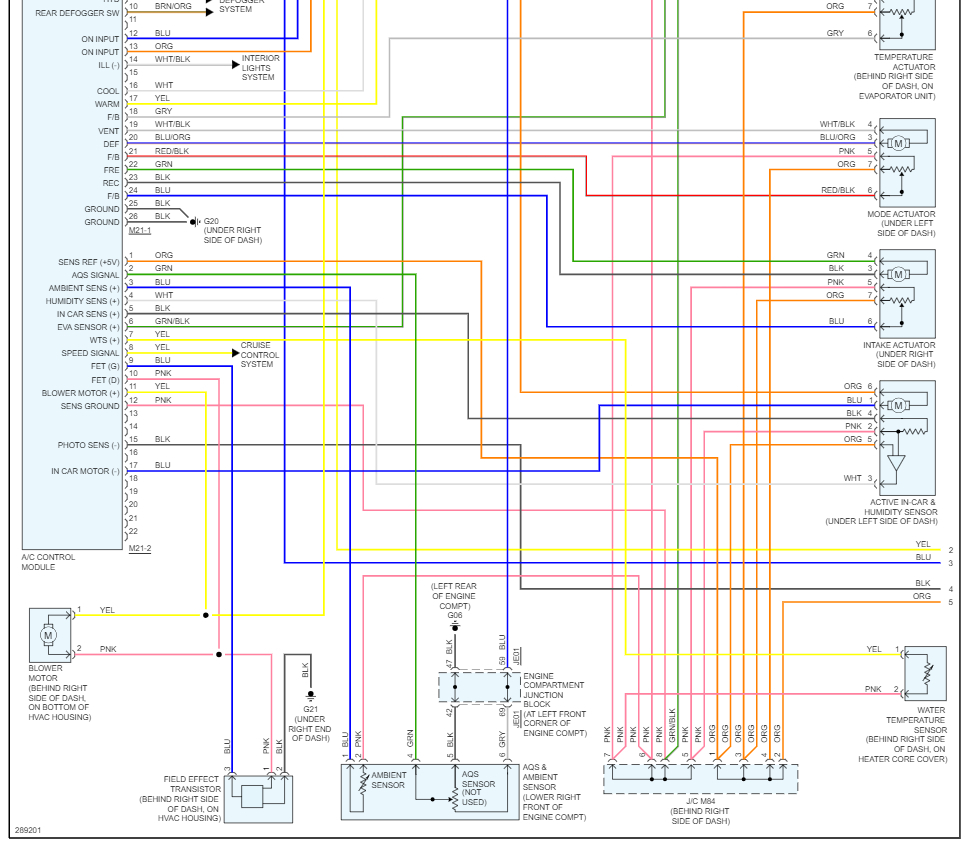

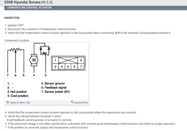

It says there is only one temperature control actuator, does your car have dual control? Here is the location of the actuators to make sure you have the correct one and the HVAC system wiring diagrams so you can see which wires to test and how the system works.
Check out the images (below). Let us know what happens and please upload pictures or videos of the problem so we can see what's going on.

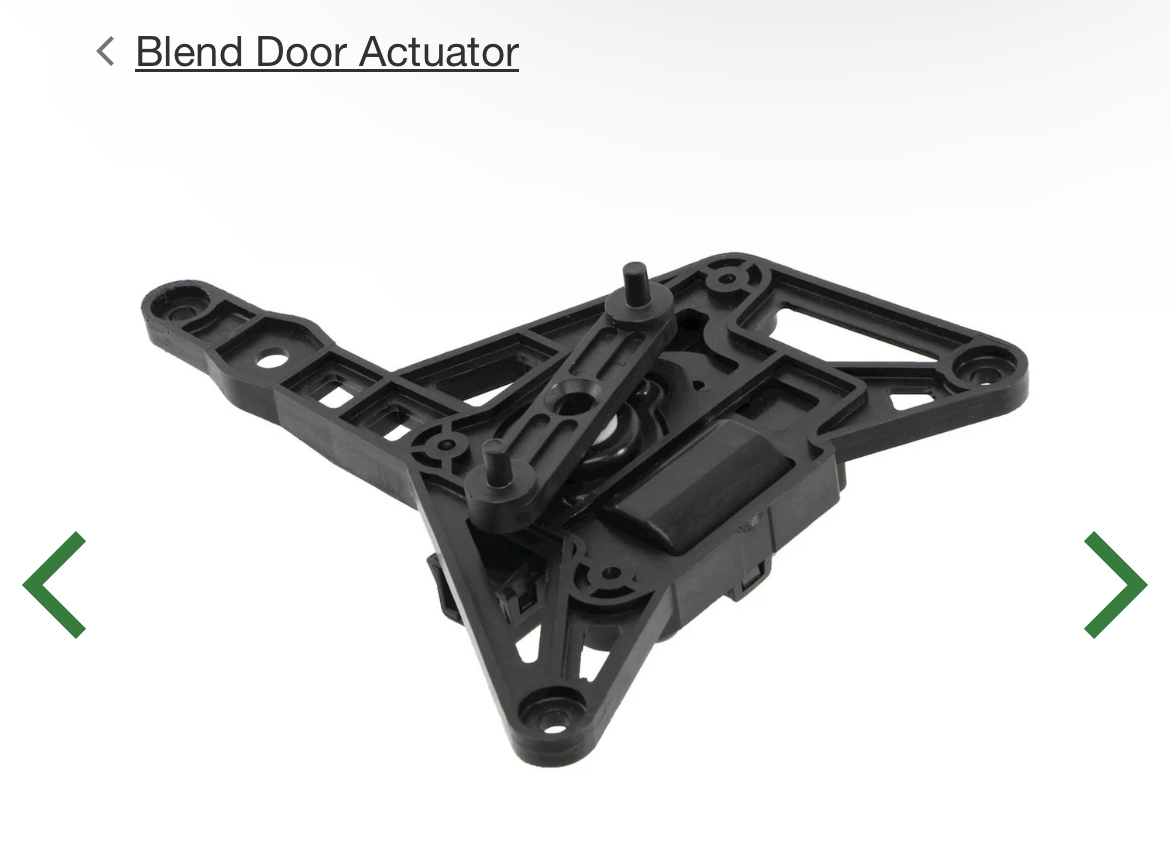

Hello Ken! Yes, I believe I have two then. The diagrams you listed say it’s on the passenger side however I replaced the blend door actuator that’s located on the driver side. The actuator I installed looked like this.
Jun 30, 2023 at 4:17 PM
Yep, that looks like it, can you monitor the actuator when you work the controls to see if they move?

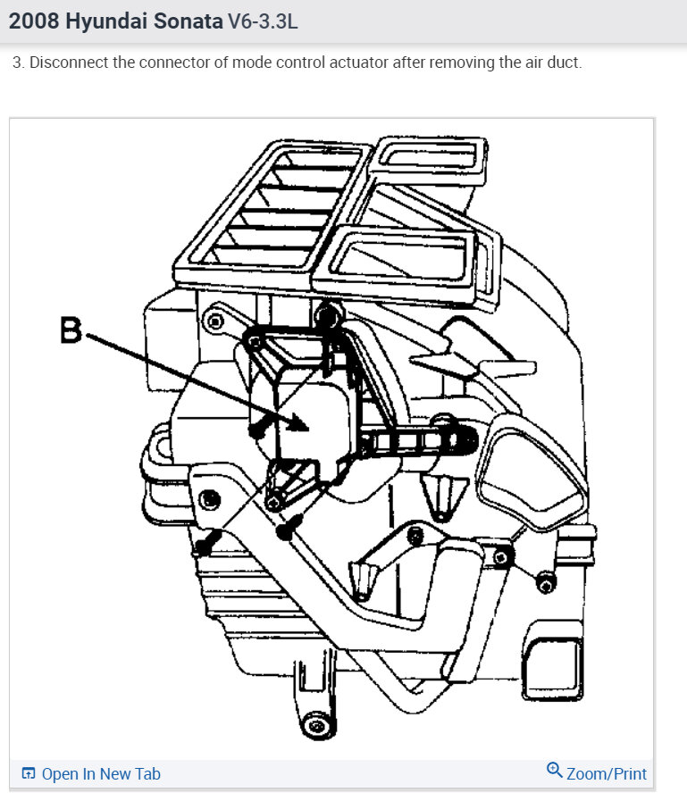

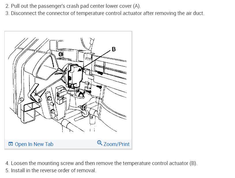

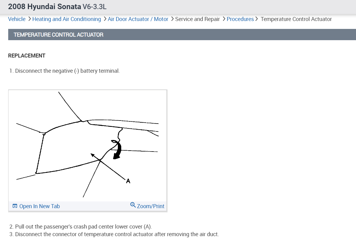

Okay, let's remove the actuator and try to move the blend door by hand to make it is not obstructed. Also, plug in the actuator and work the controls to confirm the actuator failure. Also, my info tells me there is only one temperature actuator so you may have the A/C system low on charge which can case this is as well here is a guide to help you go over the system also, I found additional images for the blend door actuator for temperature.
https://www.2carpros.com/articles/air-conditioner-how-to-add-freon
